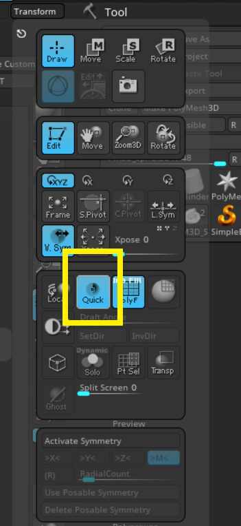

I have ran into this same issue. This has something to do with quick 3d edit mode.
My bad. Found the solution. This user interface …man!!

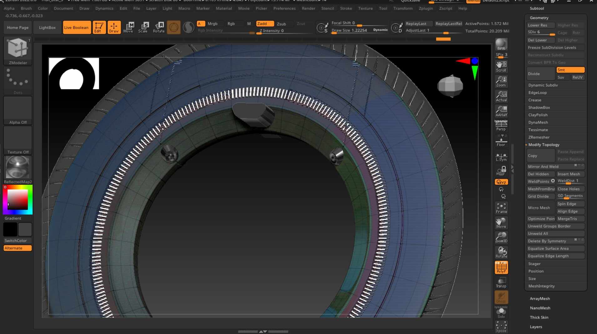

Hmm I have also a problem with the polyfill, i get weird cross haching that i cant get rid off
