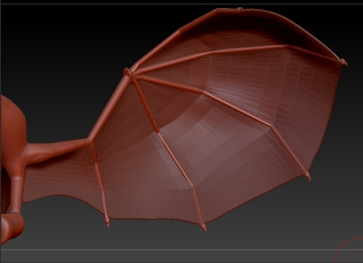

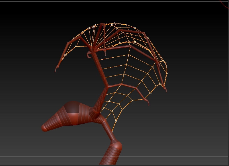

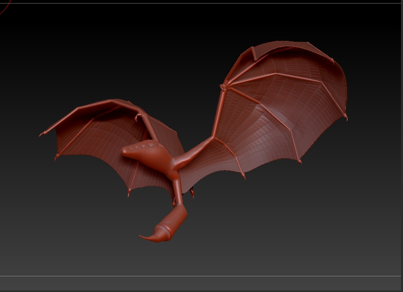

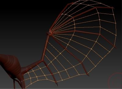

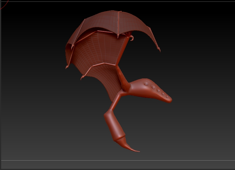

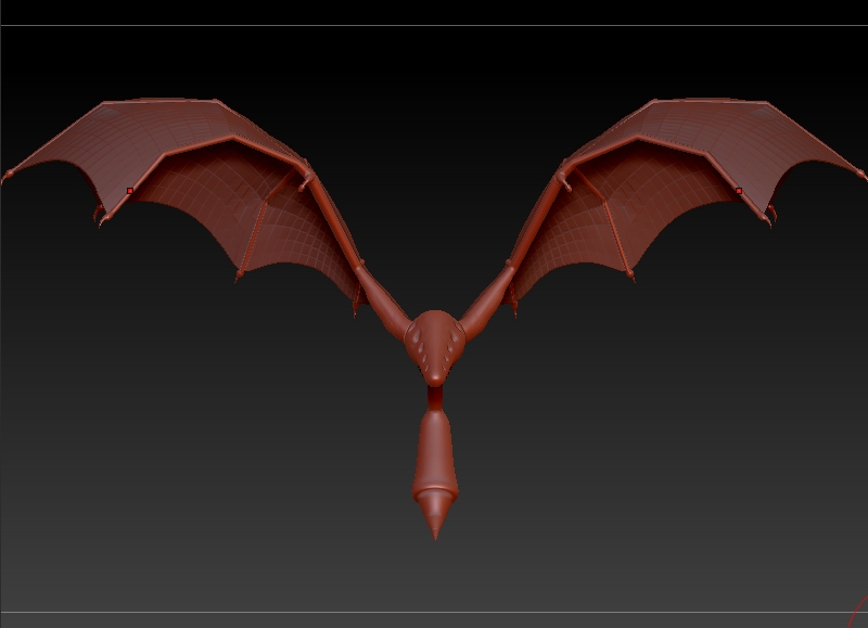

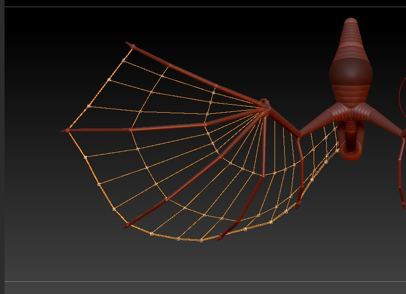

In case you are still having an issue, I was able to create some wings for my creature using topology. There was a thread explaining it but I can’t find it so I’ll try to explain.
I still had the zsphere model, so I used the joints in my creatures fingers to help create my topology. I started by draw a line down each finger, making points on each joint on the fingers of my wing. Then I started drawing a line between each finger that would be the membrane of my wing. Then I added more lines on the membrane section so I could shape my wing the way I wanted.
That will give you enough to work with, but keep in mind that it is a flat plane. If you want more of a solid mesh, just adjust the skin thickness on the topology menu before making it an adaptive skin. Warning that when you divide it will start to put in at the edges and smooth out the points, so be prepared to adjust the mesh as you divide it.
Hopefully that will help.
