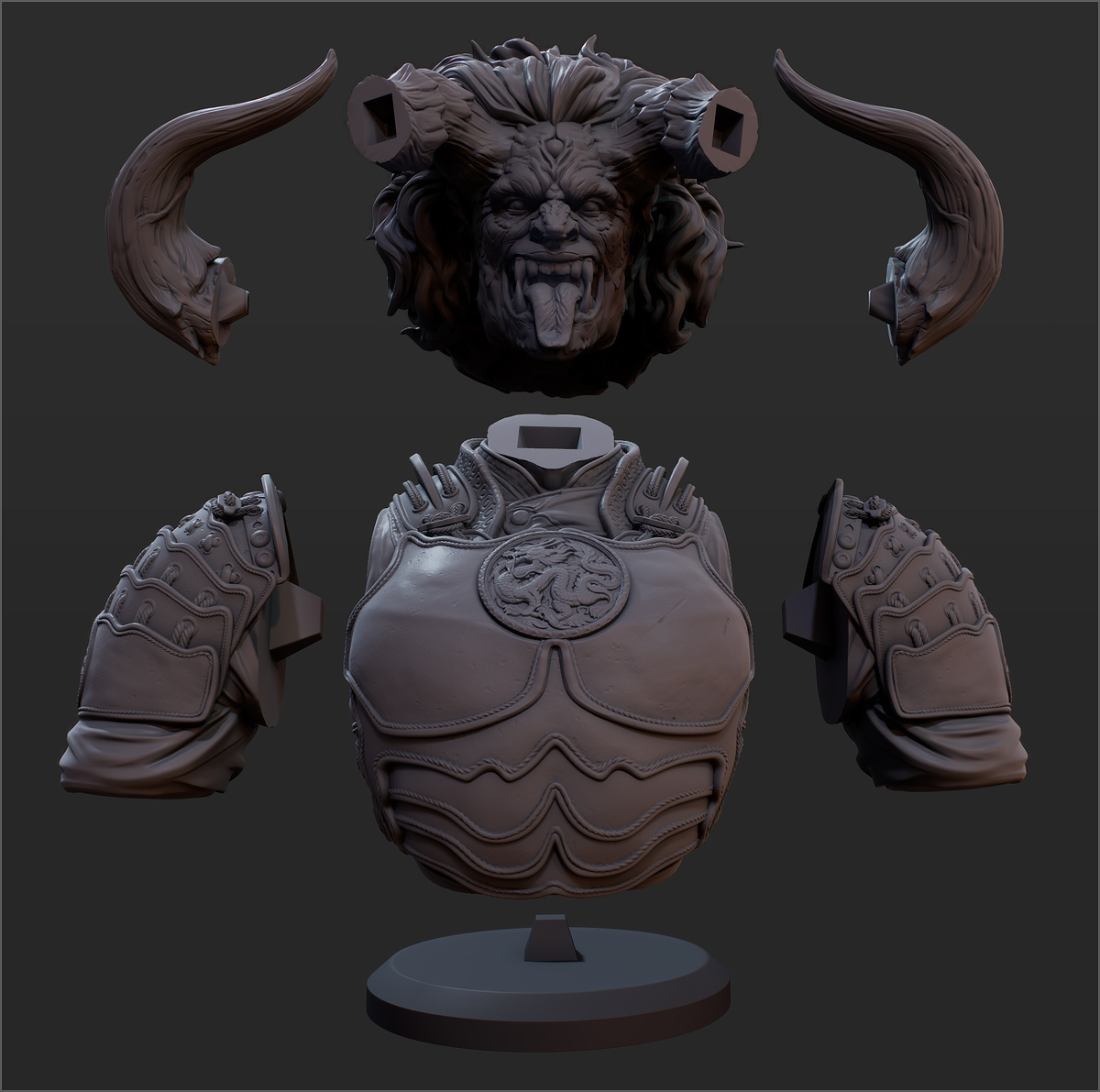

Hi.

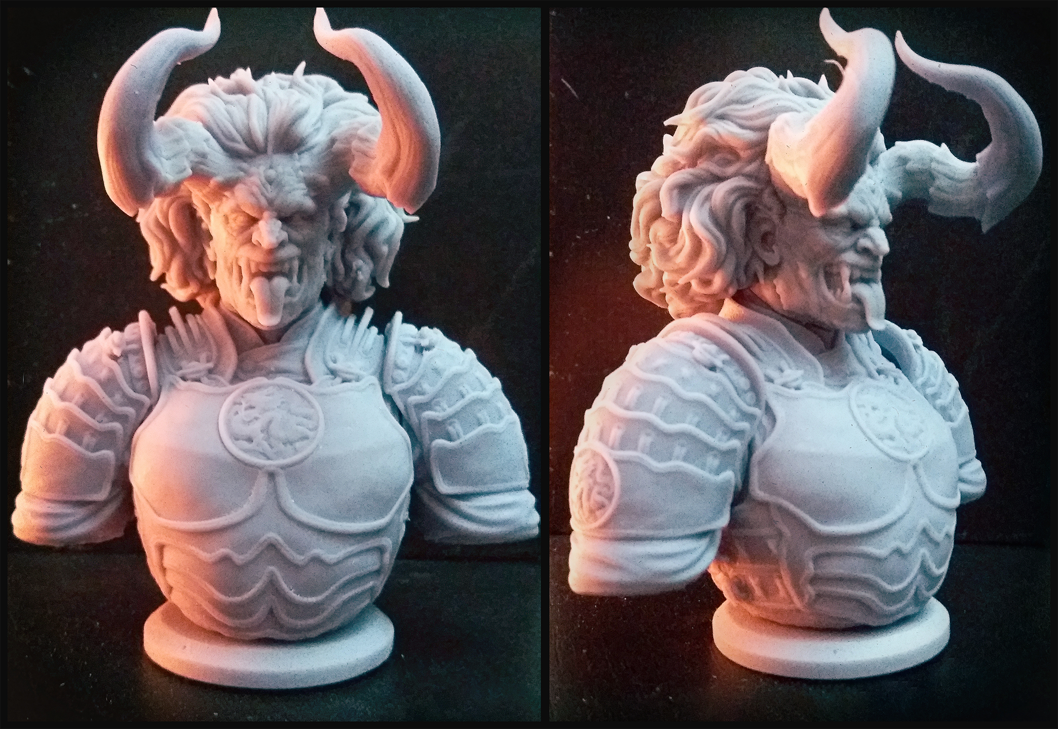

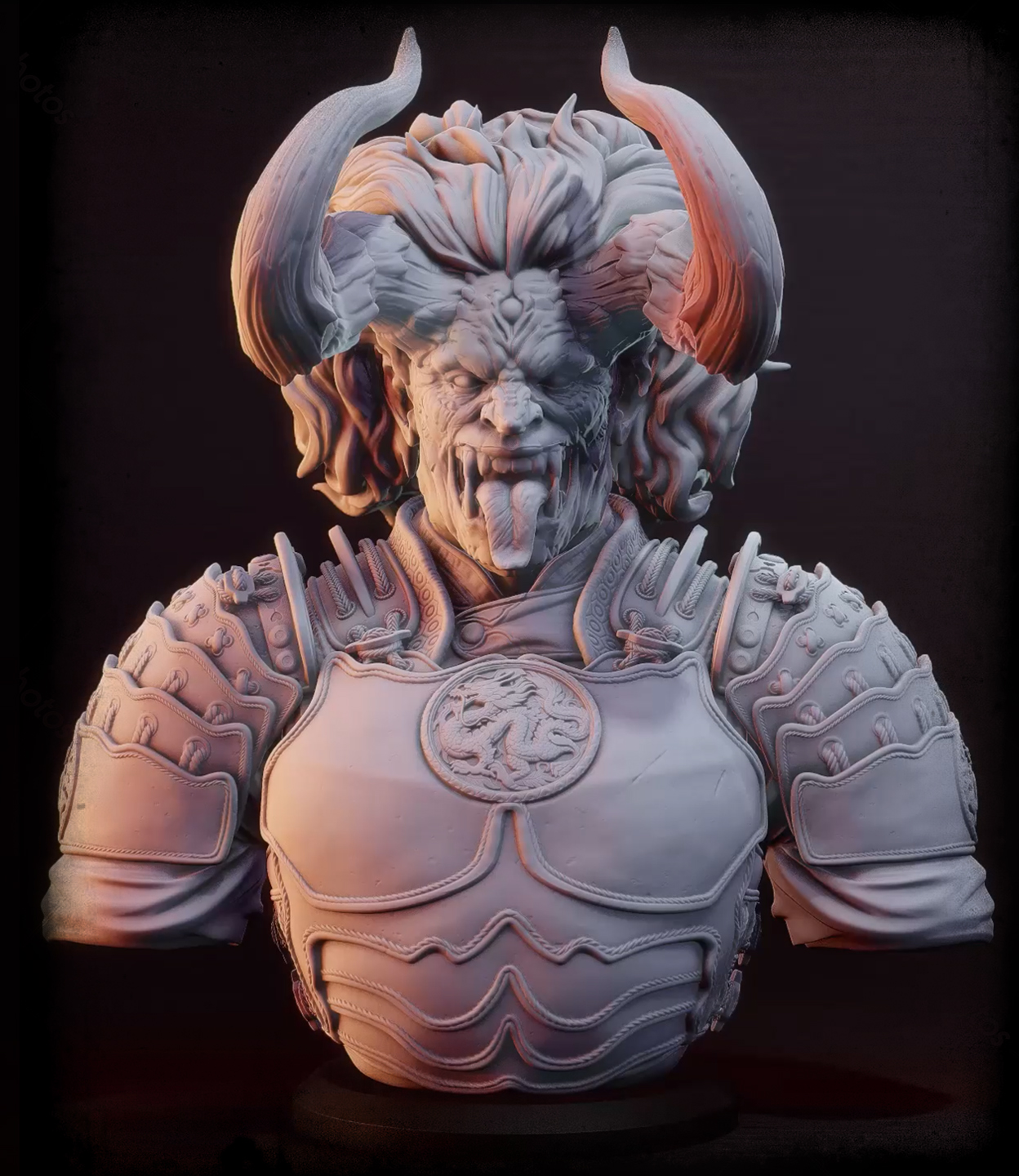

I’d like to share my recent Zbrush sculpt and 3D Print work.
I’ve posted a blog over on Artstation about the process including some handy print settings etc.

Congratulations.
This is a great job!
Welcome to the community. Thank you for posting all of the images. Congrats on the great print as well.

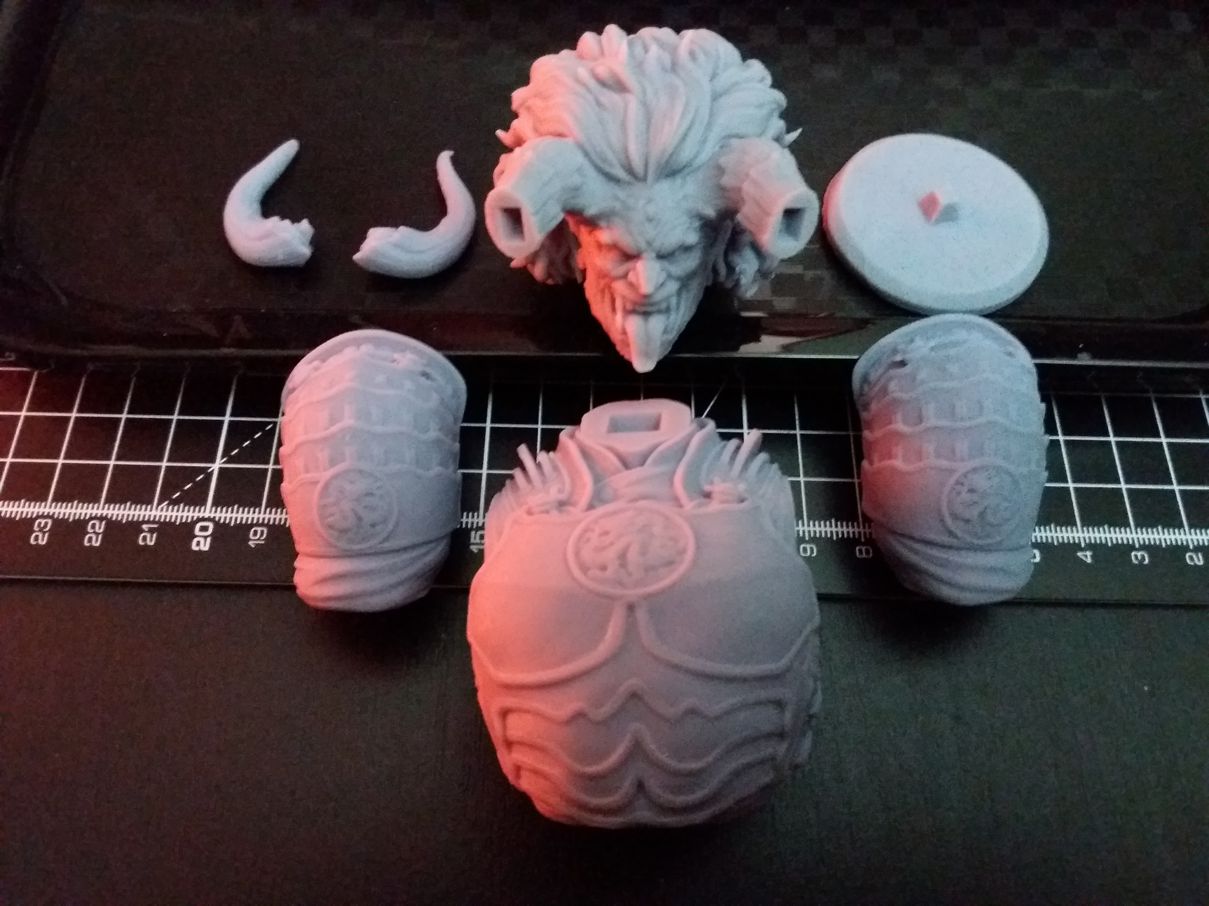

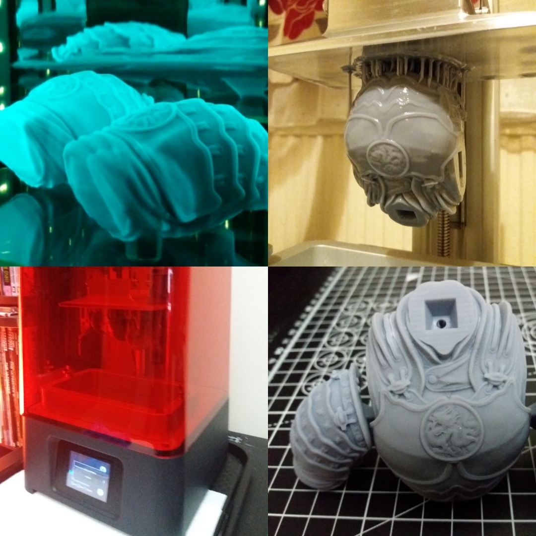

Paul, Great job! Thanks for posting a link to your blog. Really useful links. Quick question: why combine with Re mesh by union instead of dynamesh? I am new to 3d printing and wondered if this was specific to something to be printed.
Thank you EarthMonkey.
I find the benefit of using Re mesh in combination with decimation allows you to retain a lot of detail at a lower poly count, this will also help when exporting to your slicer package. Remeshing will also do a great job with overhangs and sharp angles etc and usually leave you with a good watertight mesh, Some clean up might still be needed but usually I can catch any errors by auto grouping, select part of the mesh (shift+ctrl+A) to invert selection then delete hidden. Close holes and run mesh fix. If this fails Autodesk’s Mesh mixer is a great free tool that will show you any further problems and attempt to fix them. Of course it’s still possible to use dynamesh and then decimate but I find the process can be much slower and less accurate unless you crank up the detail. Keeping your workflow fast is the best way to stay motivated

Thank you for the great tip and answering my question! It is much faster…always a plus. I tried it using Mesh mixer. Now I will try and see how the results are with Preform. You are a wealth of knowledge . Thanks again
No problem. Good luck with the print, I look forward to seeing the results!
