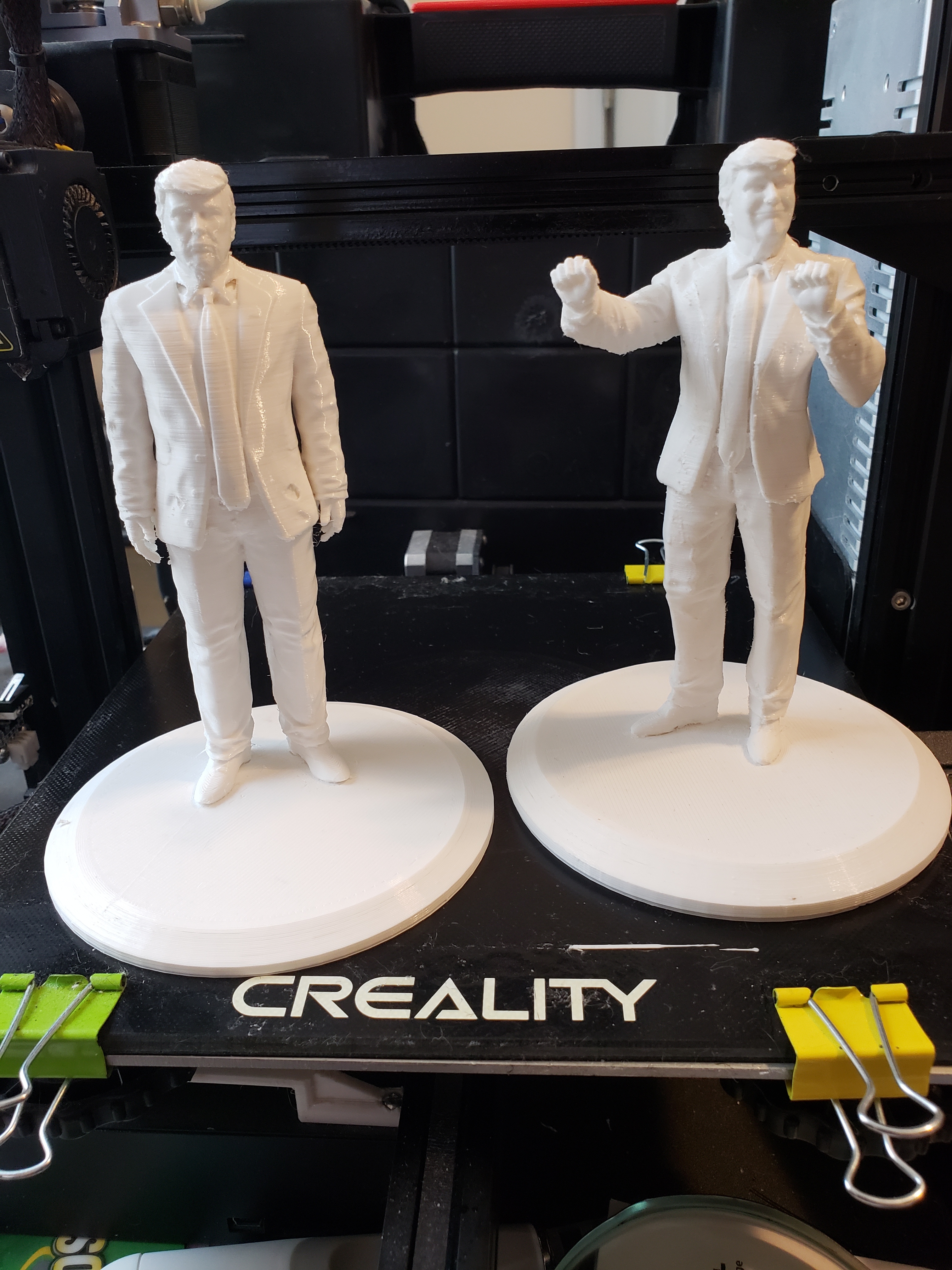

So I printed the sculpt after a little decimation. The only thing I added to both was a base plate. Thank you for not putting one on. That way I can make any base I want to print. On the neutral position I will need to bridge the fingers. I noticed that after I printed, The fingers are real weak for my printer to do well, and I pulled some of them off with the supports. I also cut off the end of the tie on accident.
The good thing is I work in the plastics industry and can take the bad prints to work and recycle them.
What I used:
My printer is an Ender 3-pro.
The material is PETG, I will print PLA ones later.
I did a base white so they can be painted. My mother likes to paint.
I used a 0.4mm tip.
I used Z-brush to add the plate, decimate the figures, and scale to 154mm(6 inches).
I used Z-brush 3d print hub to scale and export as an STL to bring in to Simplify 3d slicer software.
Its been a fun project.
I forgot to say I have not done the little bit of cleaning and sanding, and fix on the neutral pose jacket.
