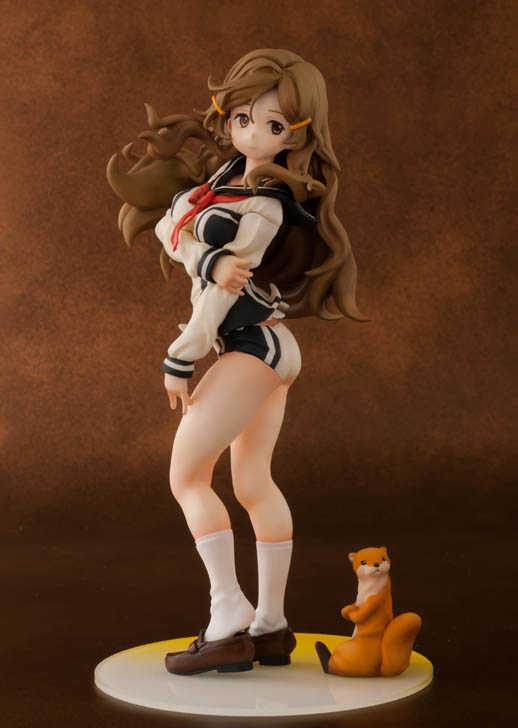

3D printing figure.(from Japaniese Animation “Vivid Red Operation”)

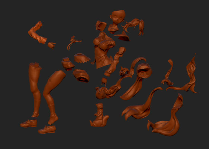

digital sculpting
Separete parts.

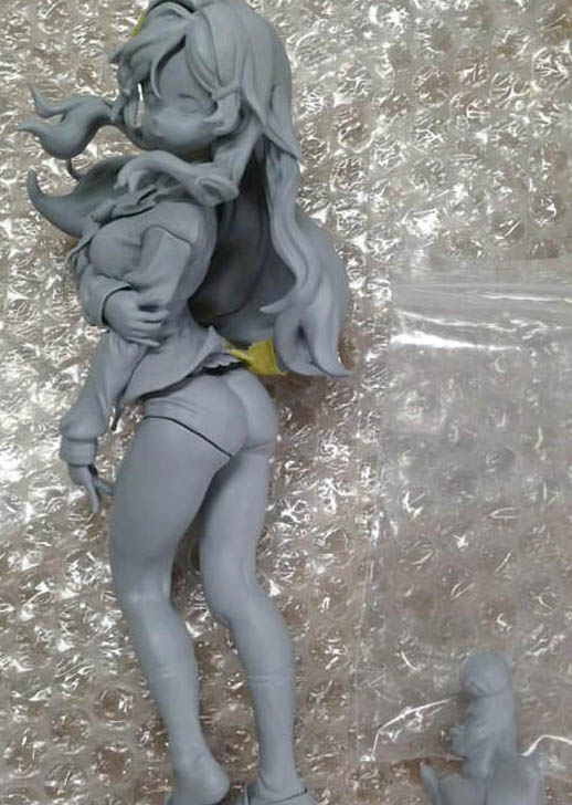

Polish output object.(HD3500)
replace resin.and painting.

digital sculpting
Separete parts.

Beautiful output man!! Seems like everyone is making their own toys now.
Very nice work! Is it fully made in ZBrush?
This model fully modeling Zbrush.
But I do one process before output.
make a gap of 0.1mm in Object mating part. Its use 3dcoat.
The reason for the easier the task of assembling those output.

Has the ability to extruding voxel in 3d coat
I subtracted voxel it.
subtracted extruded 0.1mm convex.

Which printer did you use for this one?
greater than 1/6 scale.
16cm or more from the knee to the elbow
output is the HD3500.
replaced to resin.
You did a resin based on the 3D print, it’s for mass production or because it’s better to paint on a resin than the 3D print itself?
I polish to clean output product.
I replicate a 3dprinter object polished.

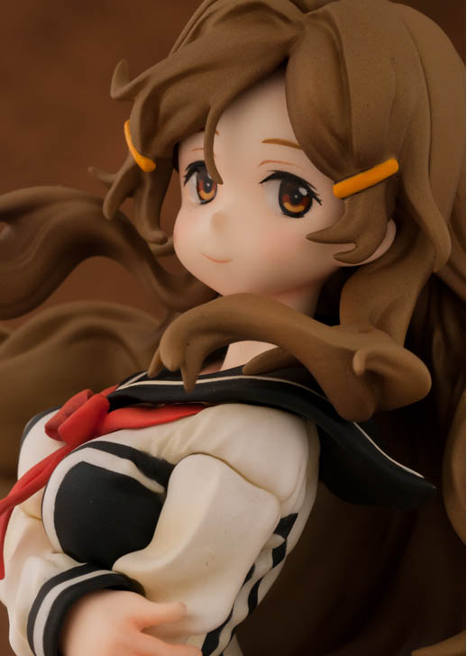

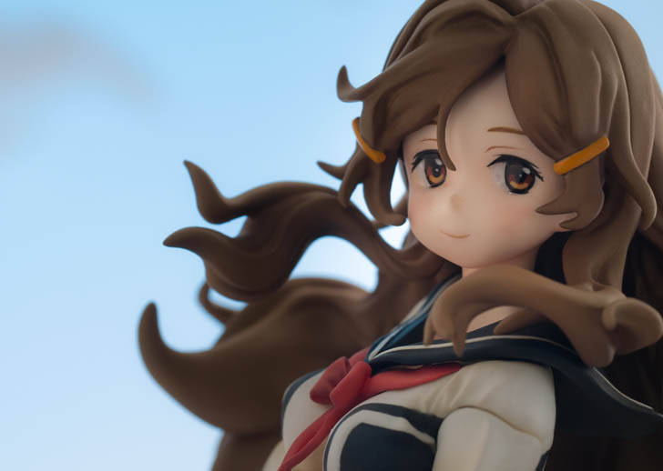

3Dprinter lamination is not good expression skin
Transparent feeling of white resin looks beautiful skin.

2 weeks or more It rather fast, because what I see you sculpt your model in separate pieces in detailed sculpt
