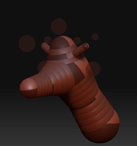

I am wanting to make a bust of a dog head, like an american eskimo. I want to do it entirely from ZSpheres.
I am having a problem getting the eye loops to work. The other areas that arent working I can push and pull after I get the poly mesh made.
I have attached an image of my zsphere set up as well as the actual zsphere set up file.
Please let me know if any of you have any suggestions at all or can maybe point me to a reference where someone has done this already, I have searched but found only models that have eyes on the side of the head, I want mine to be on the front.

Odds are you need to lower the Tool>Adaptive Skin>Ires slider setting. This is because you’re putting multiple children on the same “side” of a ZSphere.
