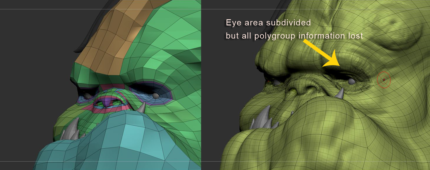

Hi! i have been working on this model and have reached a stage where I feel the need to have more polygons around the eyes for creating lids and fine lines. My base mesh ( subdiv 1) is pretty low res and has useful polygroups. so to divide the mesh around the eyes, i go to sub div 1, isolate the eye area polygroup and hit divide. the mesh divides properly, jumps to the highest subdiv, but all polygroup information is lost. Is there a way i could get the polygroups back after dividing the emesh? please help.

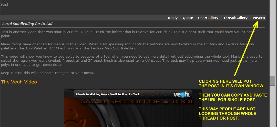

Local Subdividing for Detail
http://www.zbrushcentral.com/showpost.php?p=764828&postcount=8

Thanks Andreseloy for the help. I like the did you know series. The video however doesn’t address the issue I am facing. Currently Uvs aren’t my problem. I am just doing a high res sculpt from a concept sketch i did. The problem is that the low res model has a lot of polygroup information which is very helpful for me to select areas such as the fingers, palm, nose, ears, the lower jaw, the chest, toes etc. recreating the polygroups after dividng the mesh will be a tedious exercise. I guess there is no way to transfer polygroups from a previous version of the model. some help will be greatly appreciated. attaching an image to show what i am working on.
