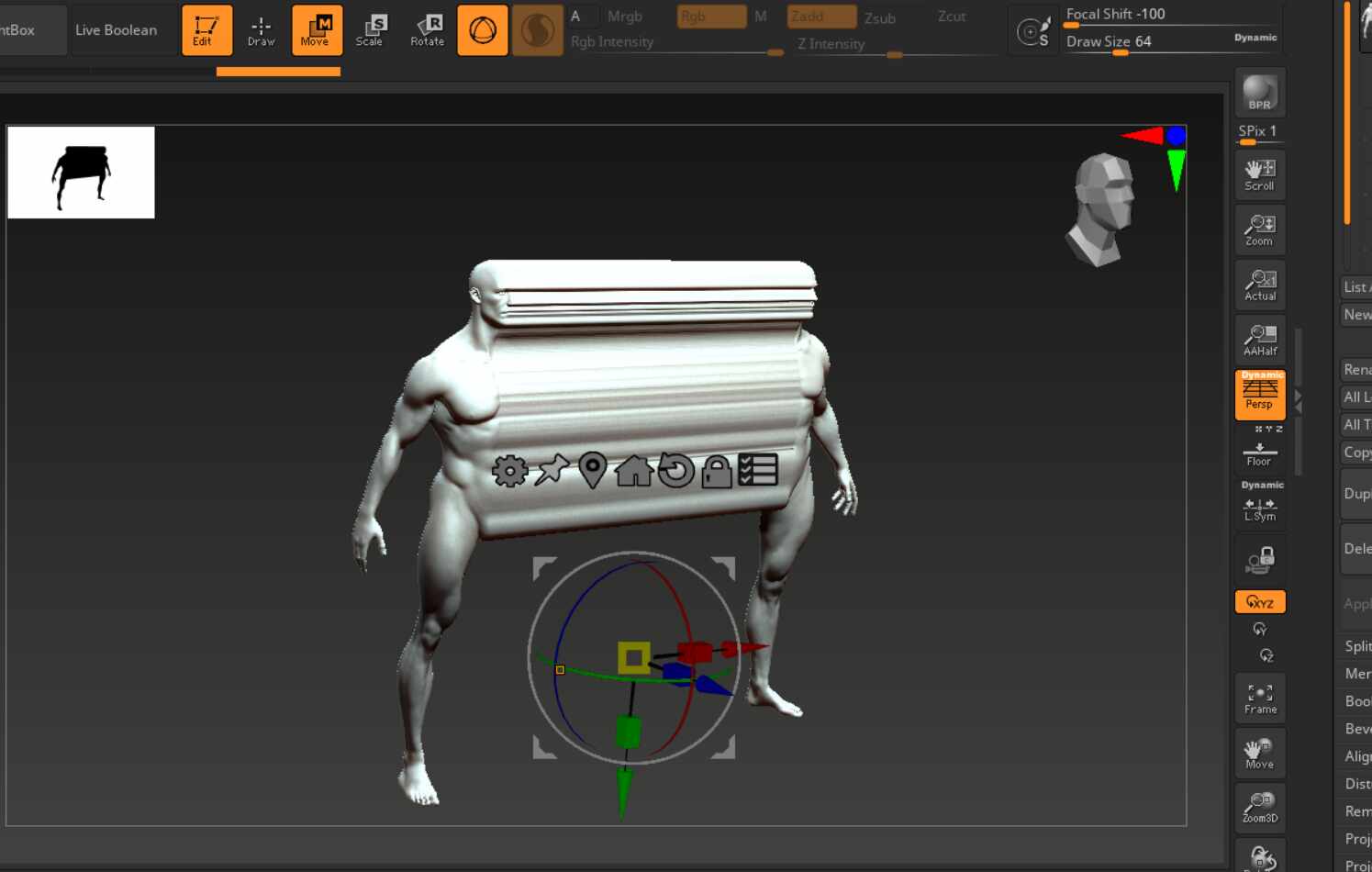

Distortion of Gizmo 3d Object
When I want to move the object, it breaks. I reset Gizmo 3d, but it breaks in the same way. What should I do?
Hi @Ercument_Baloglu
It looks like half of the mesh has a mask on it. If you have “View Mask” in “Tool > Masking” turned off then the mask won’t be visible but will still be active. Go to “Tool > Masking” and press “Clear” to clear the mask.
What Zber2 has mentioned is one possibility. Another is that you have symmetry active and are trying to scale/move very close to the center line. In some situations this can create overlapping Gizmo spheres of influence which will conflict with each other and result in that kind of stretching.
Solution: Disable symmetry and make sure the Gizmo is recentered on the mesh. Perform the operation without active symmetry. As long as the Gizmo is centered the results will be symmetrical.
