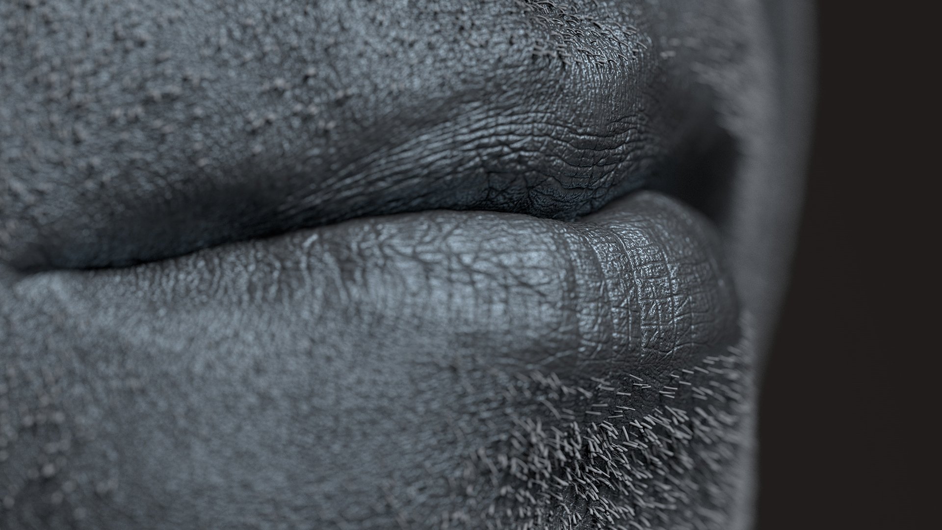

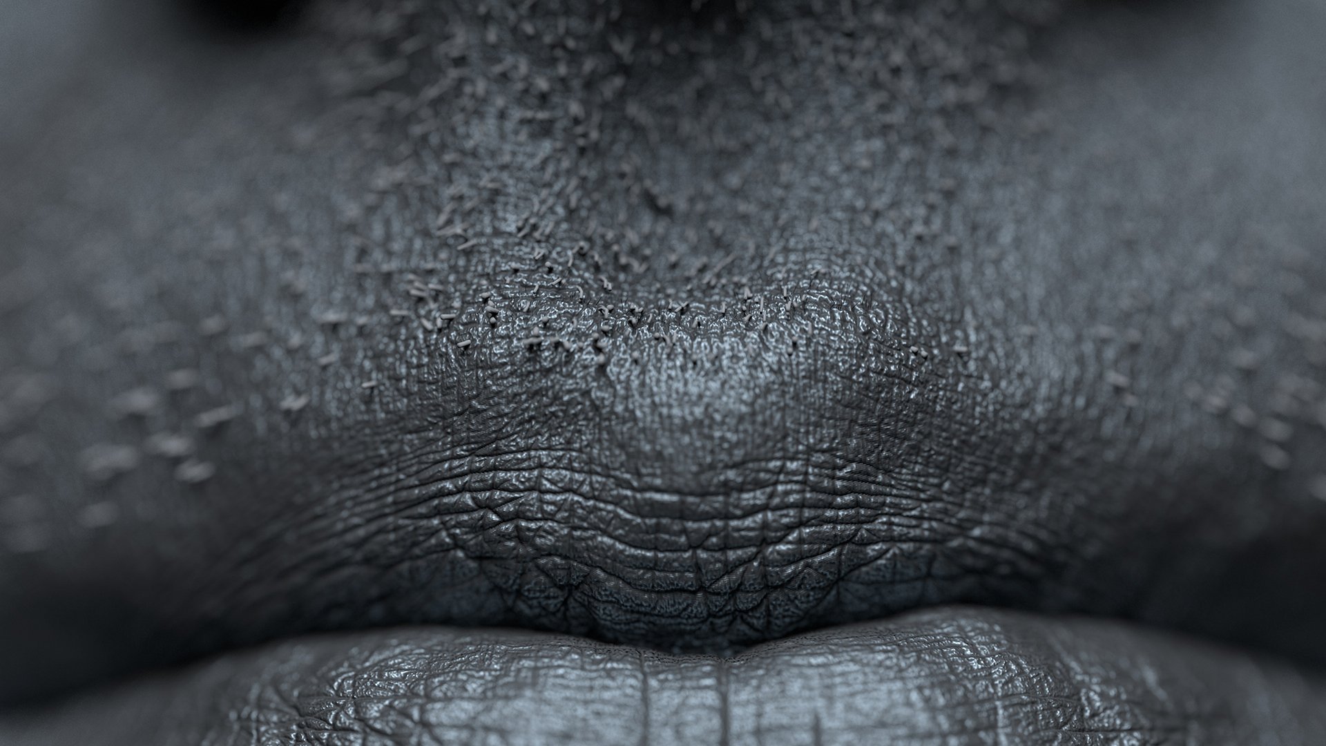

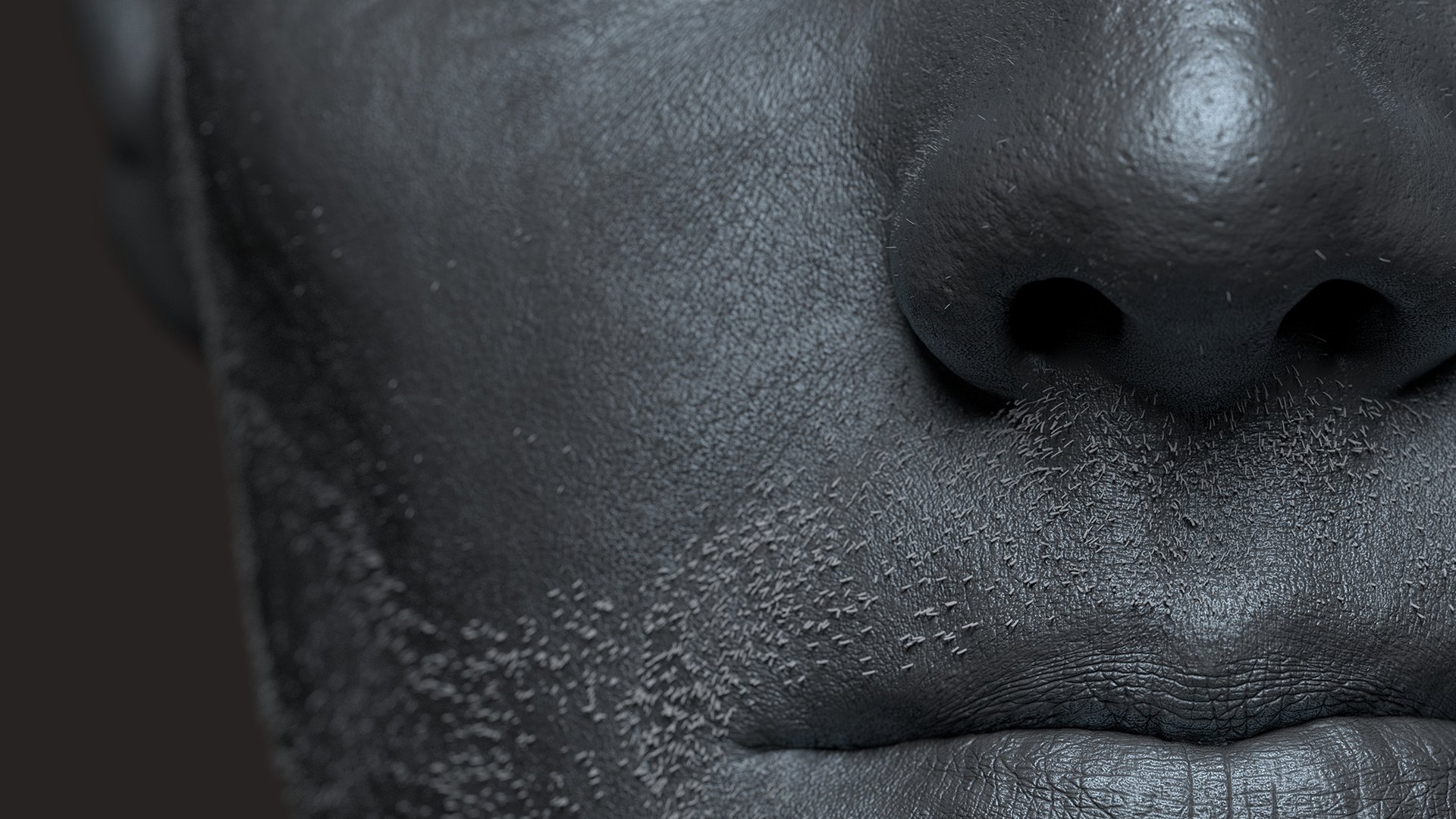

This is an inbetween release of my new character work, where I used along with traditional handsculpt the new displacement textures from Texturing.xyz to add live to the character.
Rendering was done with Arnold in C4D (C4DtoA).
