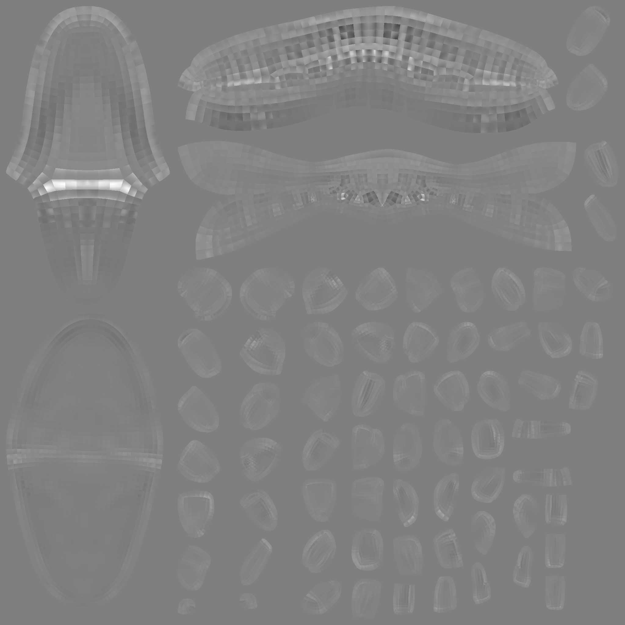

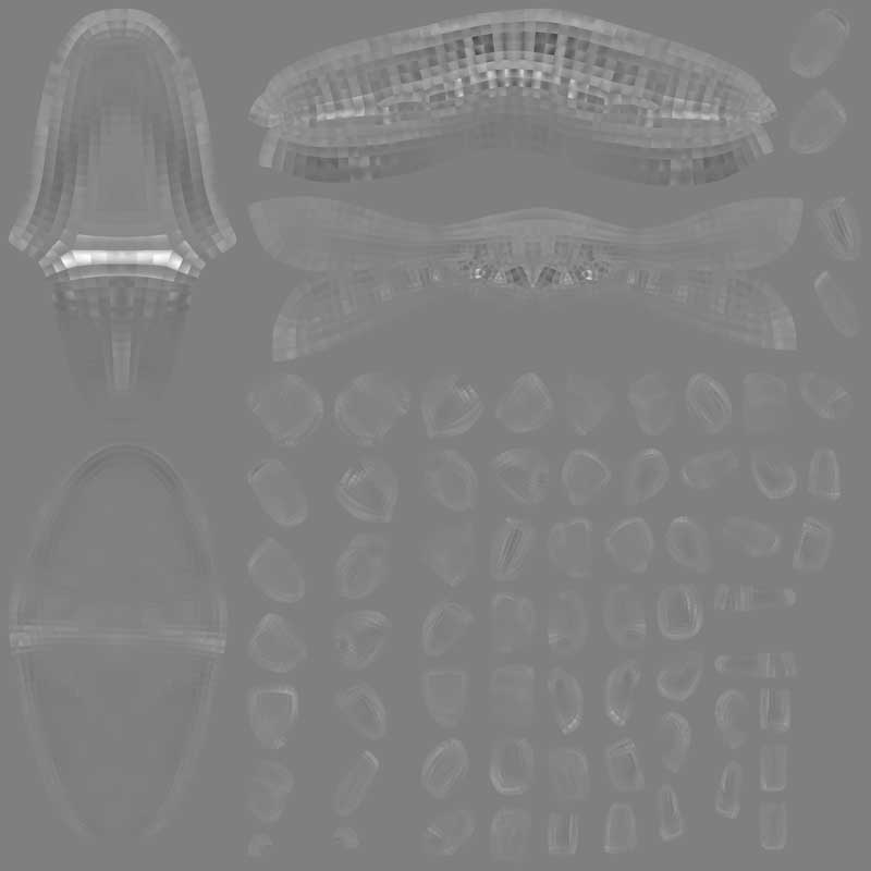

but unfortunately this is what it generates :
As you can see the displacement map is a mess, with ‘faced’ artifacts all over.
I tried tweaking all the settings, with adaptive mode on and increasing subpixel accuracy bla bla bla…, but same result all the time.

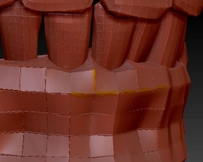

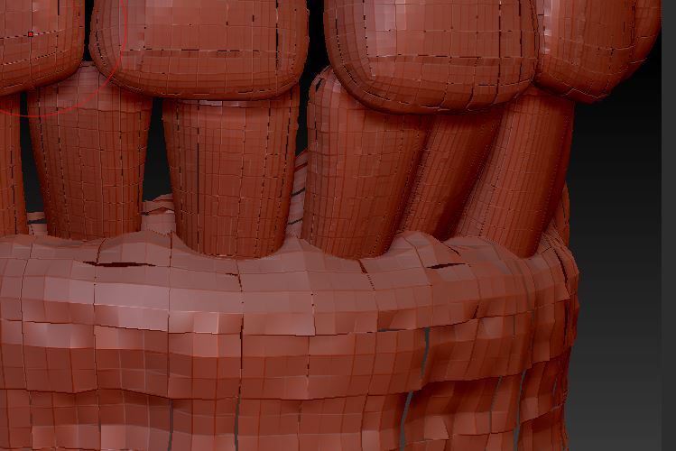

And this is how its shown on the zbrush viewport :
with displacement : on
with displacement mode : on
Can anyone tell me what maybe going wrong?

Everytime this problem happens, Max is involved. Using GoZ to bridge the two programs seems to work best for preserving the UVs, otherwise they’ll become detatched and flipped like this.
