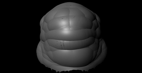

Displacement looks like inflated balloon

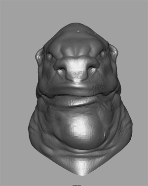

I followed a tutorial and got these results: This is what I would expect, dispScreen.jpg
I imagine someone has experienced this before, any help would be useful. BTW the tutorial I was following was Scott Spencer’s, which was very well done. Any ideas or leads would be greatfully appreciated.
just quickly messing with the alpha gain and alpha offset. reduced both to zero and made the model basically smooth. obviously there needs to be alpha gain and aloha offset values, but would they perhaps be different in maya 2008. I’m a complete newbie to this stuff.

Hey I appreciate the tip, I tried the things you suggested and am still getting a bloated, balloony looking thing.

Autodesk put in a new feature, for unknown reasons still, in the preferences of maya 2008 that needs to be turned On for 32bit dispmaps from zb to work correctly.
Window > Settings/Preferences > Settings > Rendering > Mentalray preferences > use maya-style alpha detection in file textures.
i had issues of both no detail, and heavy bloating…now its gone and the stuff works like its supposed to
Cheers
T
I was having the exact same problem this Fixed it thanks
