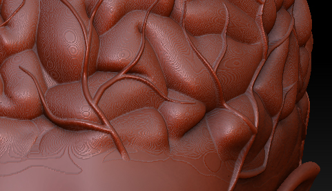

I have baked some details for a model in MODO into a displacement map and my plan was to apply the displacement to the base mesh in ZBrush and then continue with sculpting to add high frequency details, but when I apply the displacement in Z it looks all layered or posterized, like it is getting re-sampled down to 8 bit.

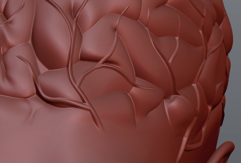

Here is the same mesh at the same level in MODO, it is a 16 bit image, so it clearly has enough info in it to be smooth.

Grrr, ok, solved the problem. Ended up being a format issues. Was applying what I thought was a 16bit PNG, but when I applied it as a PSD of the same file, it works fine.
