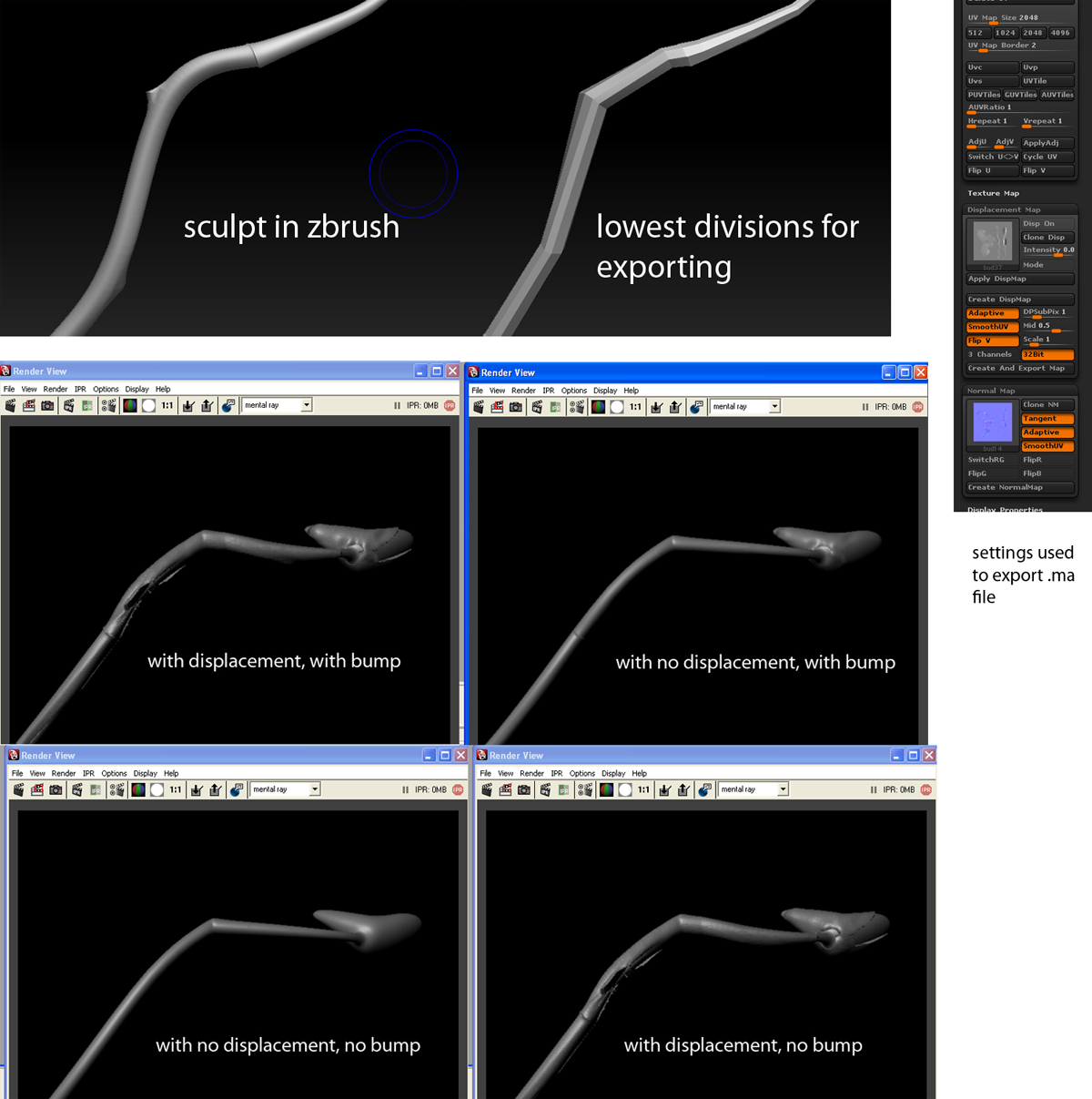

Hi , I am currently using zbrush 3.5 R 3 to export normal and displacement maps and then render in maya. The result is not at all ideally close to the sculpt.
After i set the settings in the UV map, displacement and normal map panels, I hit export into .ma file. and apparently, all the maps should be hooked up and connected ready to render in mental ray. But it failed. I tried to deduce which map was broken by breaking the connection in maya. and as shown both the normal and displacement maps are not exported properly.
I even tried cloning the maps ( transfers to the alpha side) and export the maps manually. I get the same result.

Does anyone have a suggestion? are my settings wrong? Is there a better way. I am all ears! thanks!
I see you’re creating your maps with the Adaptive modifier. Are you remembering to set Tool>SubTool>PABlur to 8 prior to creating these maps?
@aurick, the function was greyed out. for that subtool. also it was on 10.
My guess is that i sculpted too much detail / difference on something that was really low polyed? what do you guys think?
