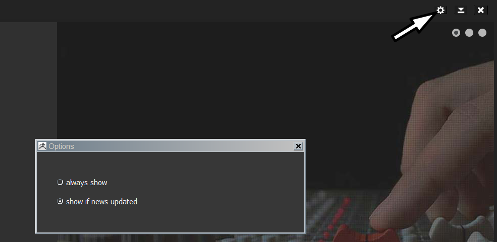

If you are referring to the Home Page…
You have an option on Home Page. Just click gear icon and select “show if news updated”.
Thanks Zber, but I meant permanently. No news, no ads, etc.
I selected the “show if news updated” option and I have yet to get the window, and I upgraded to 4R8 when it first came out, and they have updated it since, and I still don’t get it.
