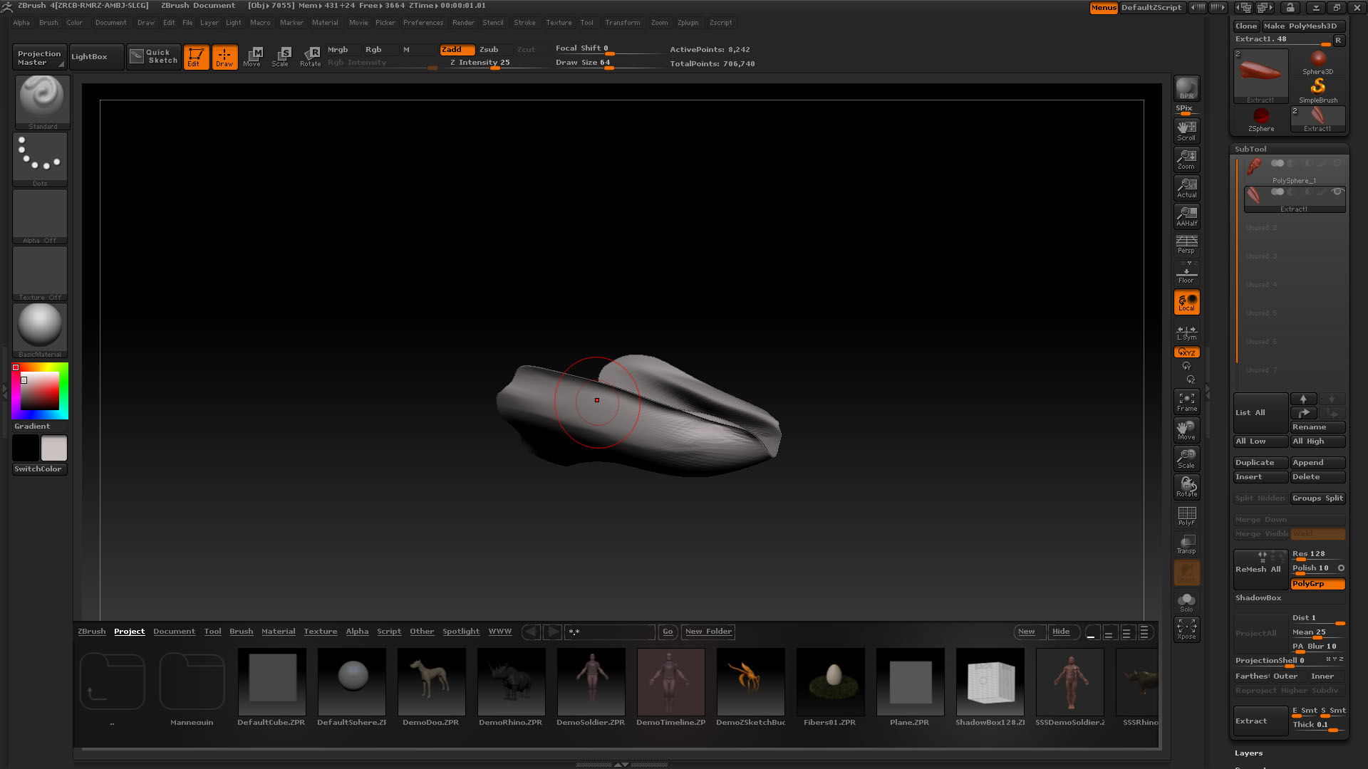

I’ve been looking for some help on fixing a mesh so I can prepare a new mesh for splitting and opening its mouth. I have tried masking the model off into separate Polygroups using the MaskPen brush and then using Extract and Group splits. But when I use the Transpose tool, the mesh between the upper and lower jaw stays attached and just stretches outward when I rotate or move. It does not properly cut along the Masking like I want it to. Am I missing any steps in the process, or am I not cutting the mesh apart correctly?

Sorry about the long delay. Here are some screencaps from the project:
The first one is the whole mesh after using Transpose and the polygons not separating. The second screencap shows my two Polygroups I have set up (via MaskPen tool), and the lower jaw itself in a separate Polygroup. I am trying to separate the two, but nothing I do will properly separate the groups.
