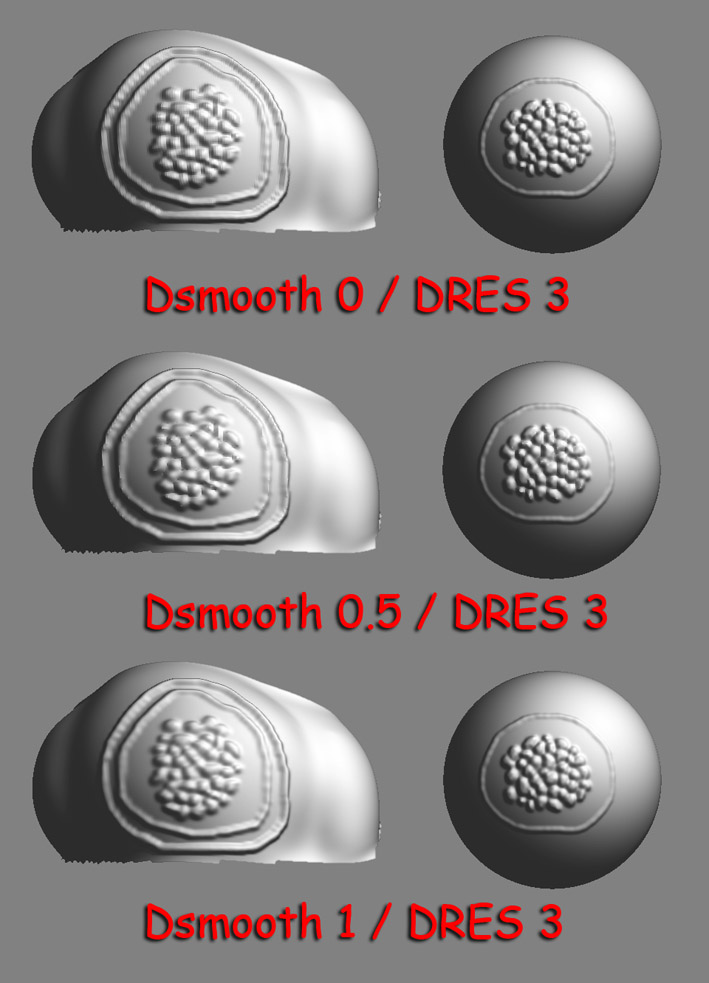

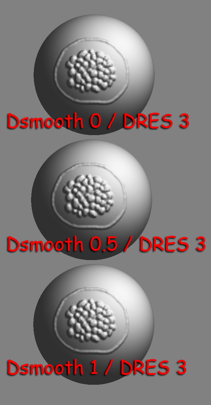

I am sure… I’d almost BET on it that your tool->display->smooth is to high now!. Also check the display subd level. To high and you have problems. With a mesh that dense… you almost need NO smoothing or subd level setting at all. Lower that Jazz and all the detail goodness will come back! If not… I have to eat a hat and have to come up with something better.

PS: Make a small sphere and ‘best render’ that with different smoothing settings. So you can see what’s going on!

the polys on the new model are 50-60% smaller from what i can see ;] Meybe the modle is just to small, make it 5x bigger. tool>def>size ;]theres no way you got less polys to work on when you got 5x better base mesh :expressionless:

You’re right, the polys on the new model are smaller, I’ve must of have express my self wrong… what I mean is that even the new model has almost the double of polygons I’m still not able to get thoses good old details out.

The thing with the old model is that in my initial steps in ZB I deleted the first SudDiv levels, so I can’t remember wich was the lowest poly count but it went up to 2.5 millions. The new model started out with 4265.

Thanks for the advise but the thing is that the Dsmooth was at all time at its lowest (0)
I did the sphere test at best render mode
So I’m still lost with the detailing

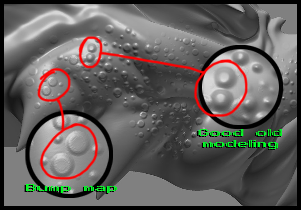

Ok, Since I’m stuck -again- I’ve been doing some test just to understand some things about the way things work, but one of the things that came to my attention was that I separated the head to see the possibilities with a multimesh. The head alone went up to al most 4 millions and detailing was better -modeling wise- With a grey texture at 4096.
So I did a small test -bump map vs modeling- And it seems that the good old modeling came out with better results…
although I’ve been told that bump maps have better results in a render than displacement maps… so there is still a lot to understand and to learn… Oh the hell with Ezequiel

Out of curiosity,
did you use an imagealpha that had been compressed earlier?
The bumpmapped dots seem to have “a *.jpg artifacts sub-pattern”.
Not the most technically correct term ever chiseled in stone, I know…
In a nutshell, it could be that the alphaimage has a bit of noise
translating directly into the bump, which would actually be a
proof for the delicate quality of the bumpalgorithm used.
In contrast, painting displacement is softer or just filtered more to
avoid cracks or jumps that would be felt disapointing 90% of the time?
At least that´s what I figured sofar from my own fiddlings with ZBrush.
You´re right, could also be a complete bogus but only Pixolator knows…
Nop -or not that I know of- I created a gray R128 G128 B128 texture -for my Dump map- and took it into PS and exported it back to ZB as a PSD -native PS format- So as far as I understand that shouldn’t affect the quality :confused:
I’ll try to do more test and reseach -since modeling is of limits for now :D- I’ll keep in mind the “*.jpg artifacts sub-pattern” issue :+1:
