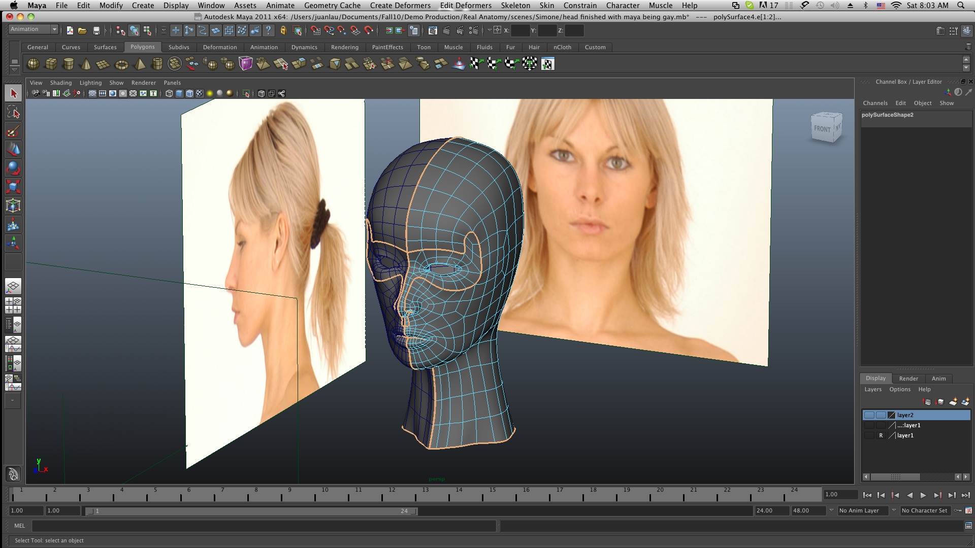

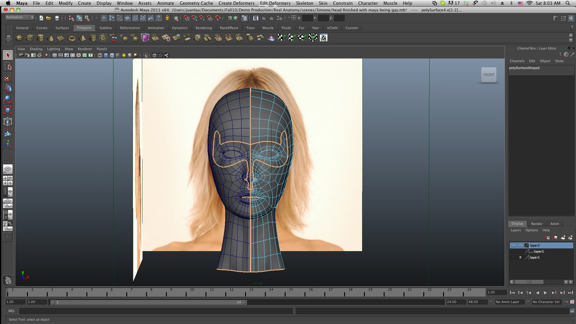

Well I have been recently been working on my demo reel i plan on using zbrush for most of it and already started. Im having a few problems though like this one Screen shot 2010-12-04 at 8.03.42 AM.jpg
I been trying to figure out how to get the edges in the face out and cant figure how so i was wondering if anyone knows without redoing the hole model or deleting alot of it. btw i dunno if i pout this post in the right place or not >.> oh and one other note does anyone know a good tut for doing fingers and hands in zbrush?

Have you tried selecting the edges and using Maya’s Uncrease Edges command? (I don’t know how to do that in Maya, specifically, but I’m sure there’s something like that, maybe someone else can give you a step-by-step)
There are a few reasons this is occurring. My best bet is that you either have faces on top of faces ore your verts are not merged. Other possibilities are your normals are reversed in certain areas. This is maya 2011 and I haven’t seen the problem displayed that way before (I am using 8.5), but one of those options would be my bet. Good luck on the problem.
On another note, I would consider reworking your edgelooops a little bit. Here is an example of what I think is a good wireframe:
Hope this is helpful.
I just wanted to emphasize what Ravis said. your mesh will give you quite some problems if you use it as it is. especially the cheek area. you are gathering 3 vertexes with 5 edges and one with only 3 there at the same place which will lead to pinches in Zbrush that you can’t get rid of.
Ravis sample is excellent. there is a 5 edge vertex on top of his mesh’s cheek, but in an area and context where the flow still works. obviously he does a lot of meshes for animation for which a good edge flow is also particularly critical.
now , teher might be people here who tell you for Zbrush only sculpting the topology doesn’t matter much. while in most and moderate cases it doesn’t matter as much as when animated, it still can can lead your sculpting traces into dead ends, where you just can’t get rid of artifacts showing up. egdes which flow along with the shape you are going for are always better. for highpoly sculpting only your mesh should at least be an evenly spread grid with little to no ‘anomalies’ like the egde nest on your cheek. one vertex should share no less and no more than 4 egdes wherever possible.

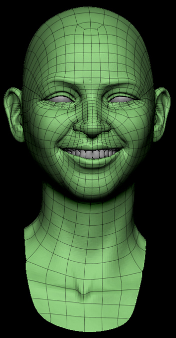

So, these days I don’t typically use reference for wireframes, so my image collection no longer has too many examples, however here is an image a buddy of mine did a while back that I think is also a great example. You can see more of his work here at: www.tyshelton.com
These types of wirez will allow you to work much easier in Zbrush, with fewer complications. As you can see this image has very similar wirez to my image that I previously posted, there are some differences, but the same general principles are in play. I hope this helps.
