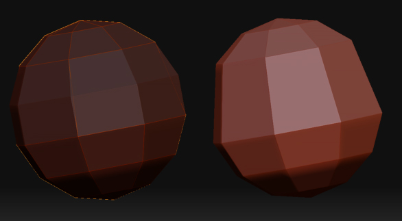

You COULD do it in ZBrush via retopology, but it won’t necessarily be easy. You’d have to remove the points for the edge loop, and then you’d have to construct new links across the missing space.
Fortunately, you don’t have to reconstruct EVERY line crossing the edge loop. You just need enough for ZBrush to see that the two parts needs to be connected. For example, if your edge loop crossed a total of 16 poly lines, you could start by reconstructing four of those lines (skipping 3 in between each reconstructed one). If that’s still not enough, construct four more lines, halfway between each that you’ve already reconstructed.
I recommend that you practice real quick with a Sphere3D that is set to 8 x 8 for the initialize settings and then converted to a polymesh. Delete the equatorial edge loop and then reconstruct four of the lines that run from pole to pole. You’ll quickly see how this works.
Here’s an example where I did just that:
