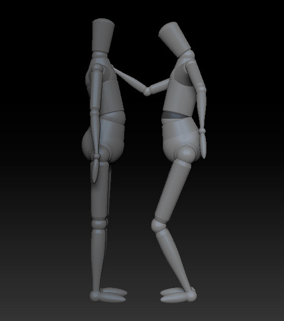

I’m trying to simply set up a scene with two mannequins. I’ve duplicated one for posing. I want to rotate it to face the original but when I use rotate under Deformations it rotates around the original pivot point. Can someone point me to a succinct and clear explanation how to remedy this situation? I know that Set Pivot is supposed to be used…somehow, but I still can’t successfully accomplish this seemingly simple task. Thank you.

Yeah, I resigned myself to rotating the mannequin at point 0 and then moving it, that seemed to be the only way I could do what I wanted. Thanks!
