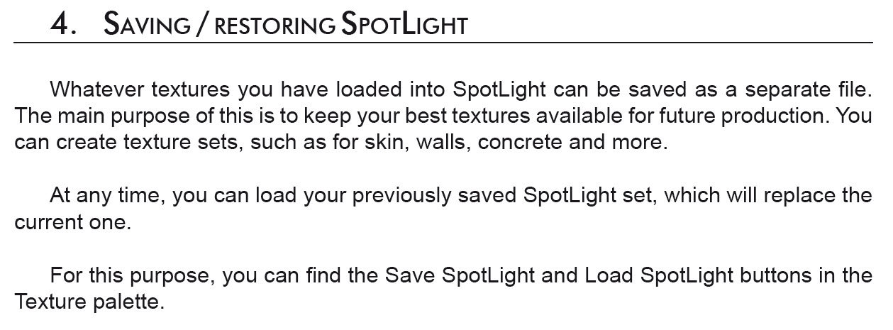

Ah, i see now excuse.Well i was looking in the guide and you have an option in the texture palette,once you have press shift+z to activate the spotlight…after you work with it you can save pressing the save spotlight button in the texture palette and now if i understand well when you do that promt you to the zimport/export folder,right? so i suggest that for the first time create a new folder in the ZBrush main folder with the appropiate name so when you open again pressing the load button in the texture panel will put straight in that new folder, is my guess…:smiley:
