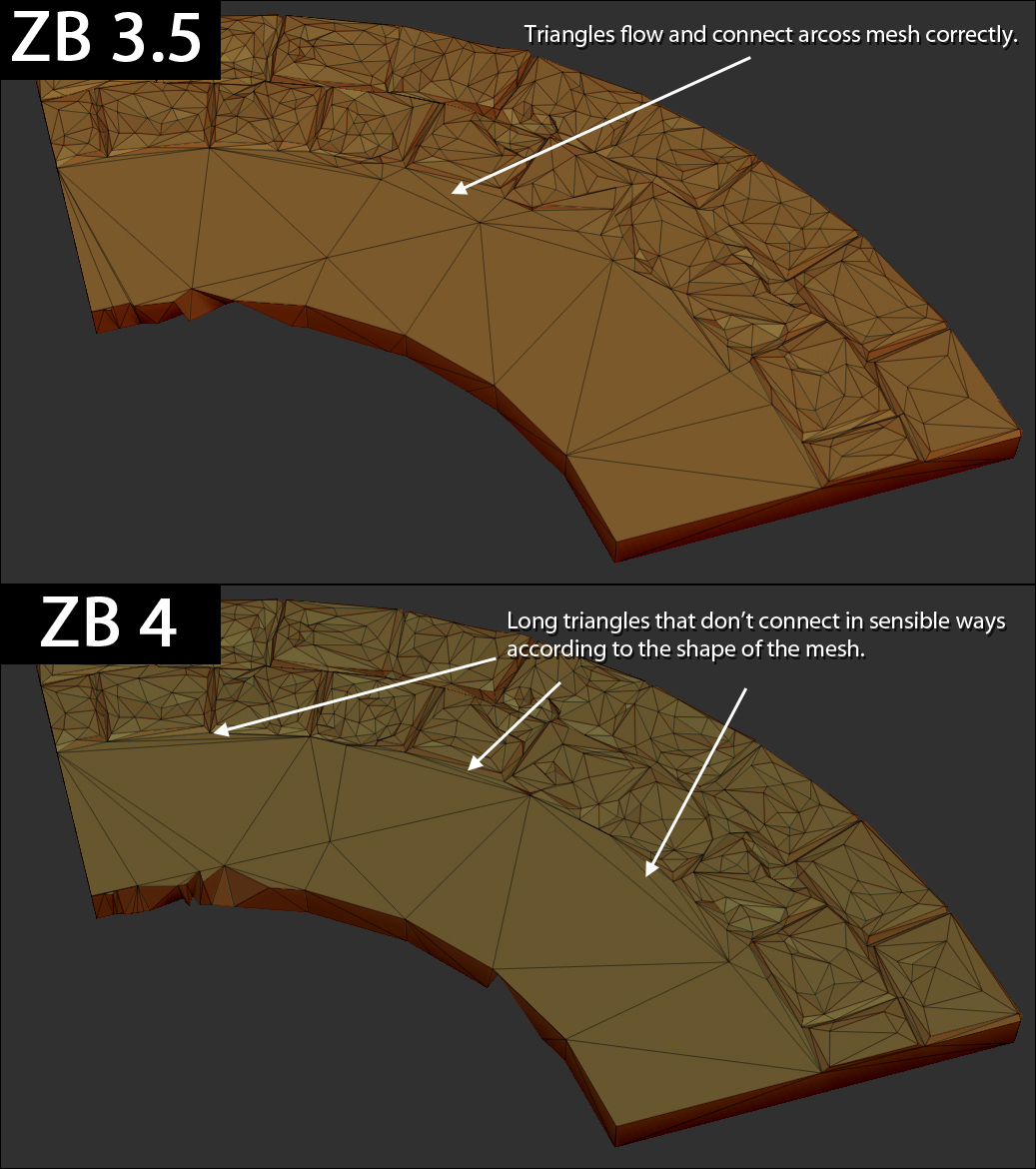

Howdy. I noticed some differences between with mesh that was decimated with decimation master in ZB 3.5 and 4. The attached image shows the issue but, it seems DM in ZB 4 doesn’t do as good a job with ordering and rotating triangles as it does in 3.5. Other artists I work with noticed the same issue. I searched around to see if anyone else had the same issue but, couldn’t find anything so, I thought I’d post here to see if I’m not alone. I may post a bug about too.

Nothing has been changed on Decimation Master between ZBrush 3.5R2 and ZBrush 4, then you should have the same result.
From what I see between your screenshots is that you don’t have the same settings between the two models. can you do a test and entering exactly the same numbers?
Eventually, can you share with us one of your model, which will let us do some tests.
That’s what I thought too. I actually used the same mesh with the same settings. I decimated down 50% at a time. I’ll get a mesh together and post in a bit.
