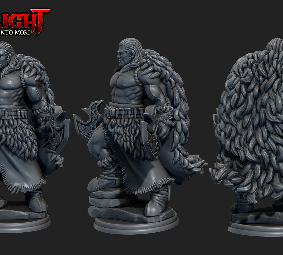

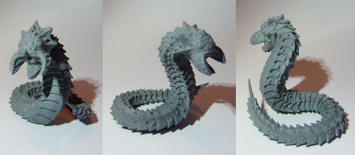

These are the 3d prints for all the parts.

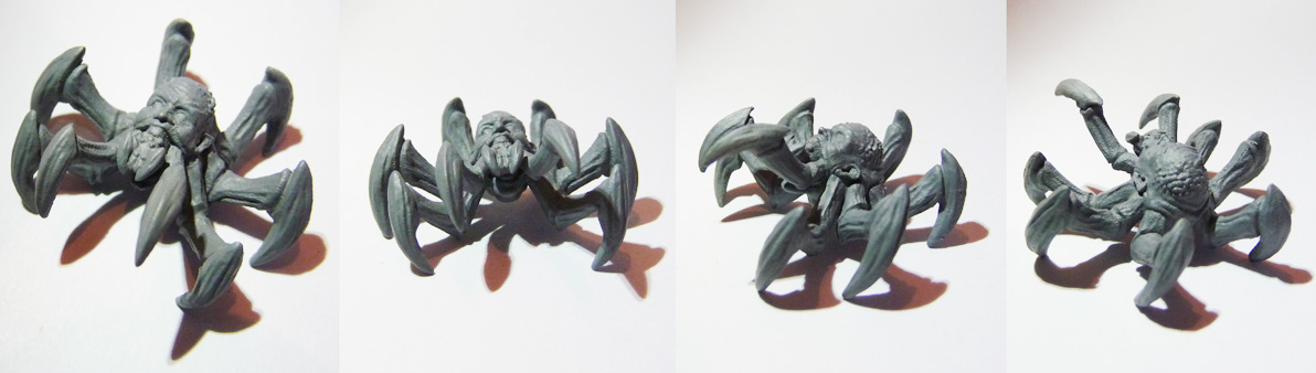

The models were printed at 16 micron layers resolution, and were then hand finished and primed

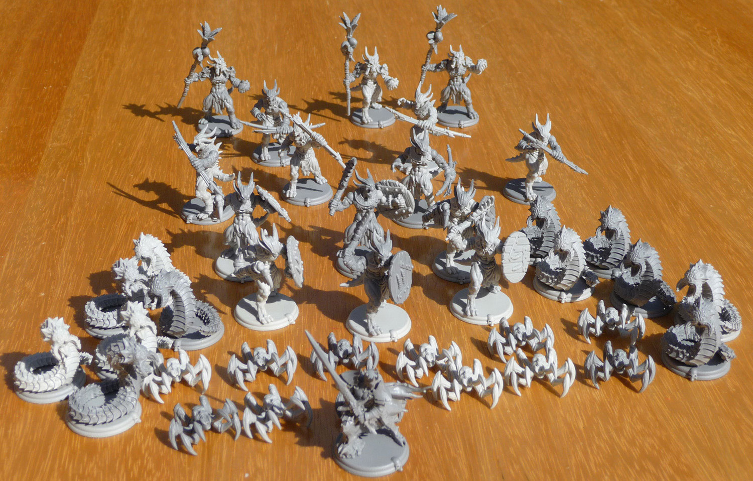

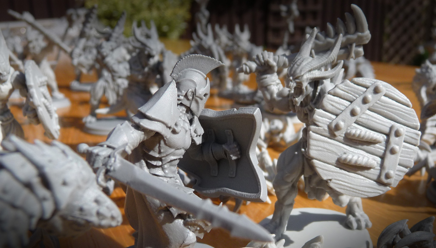

The resin casts, cleaned up and assembled…

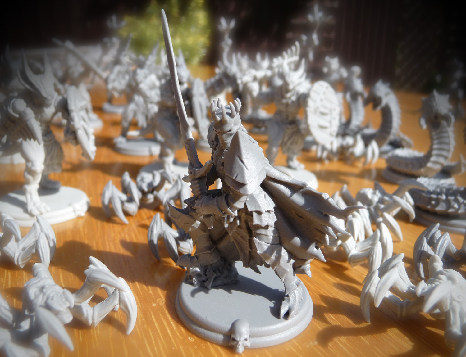

The remaining character… and some fun shots :slight_smile:
My personal army: :lol:

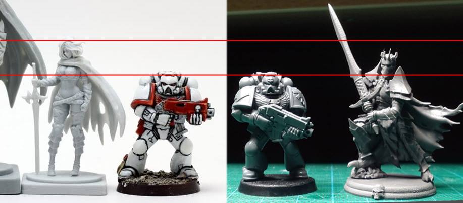

Very nice work there. How do these compare to other miniature games so we can get a sense of scale here?

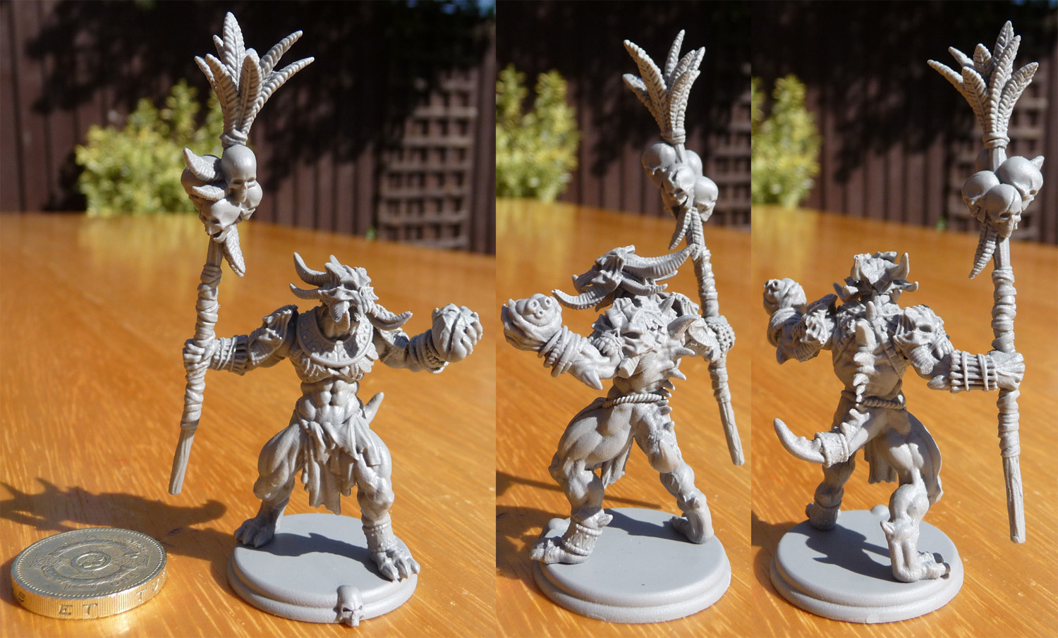

Does the minis shown are 3d printed or casted ?

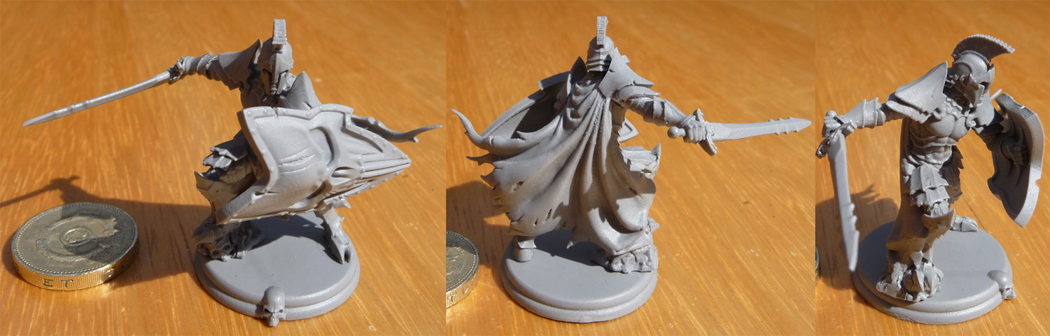

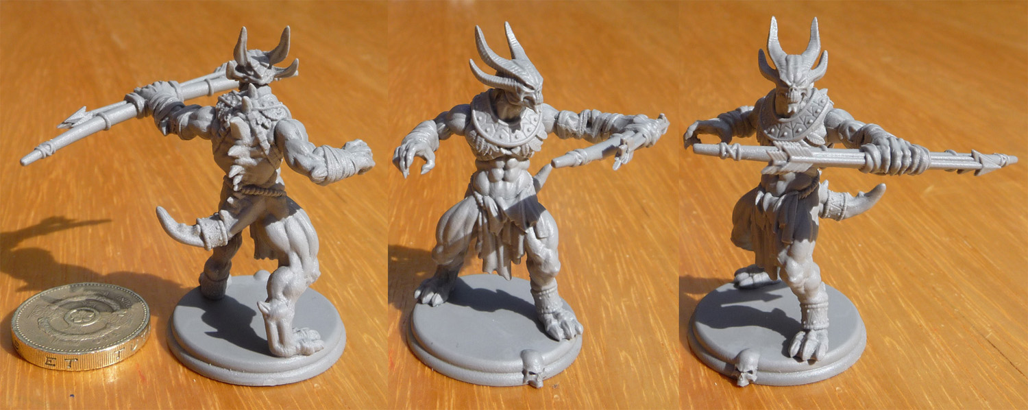

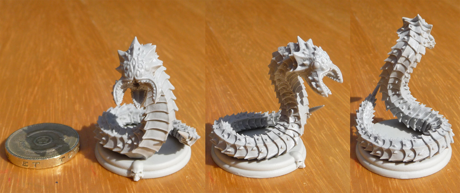

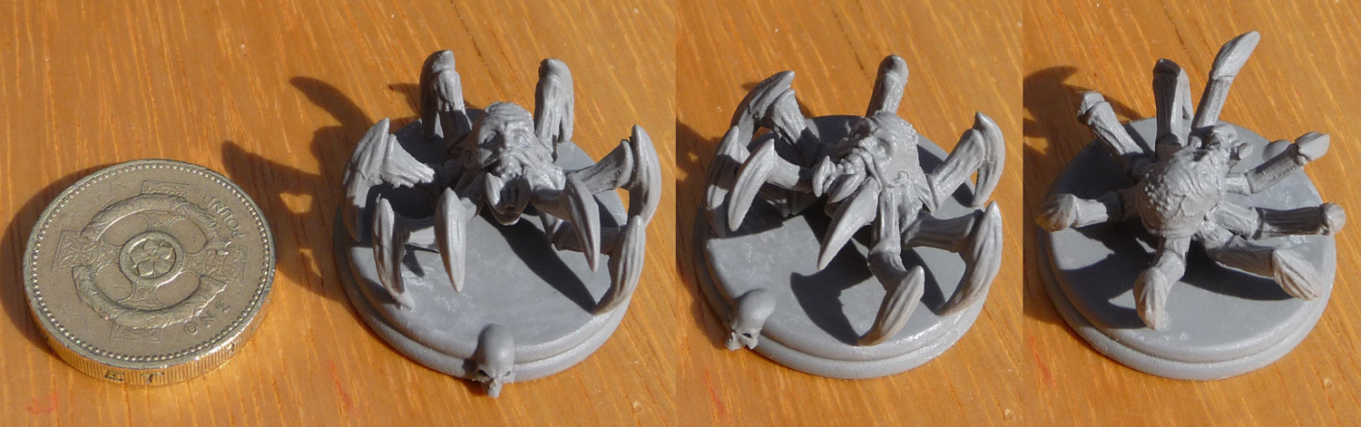

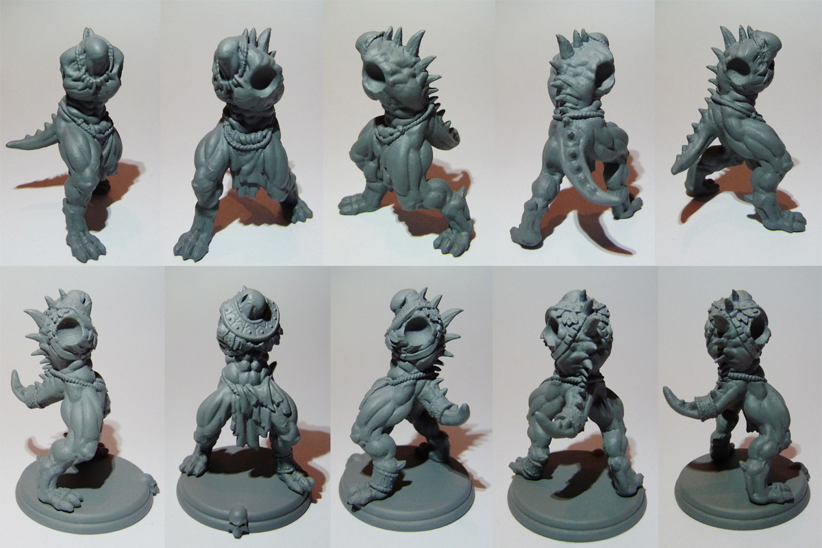

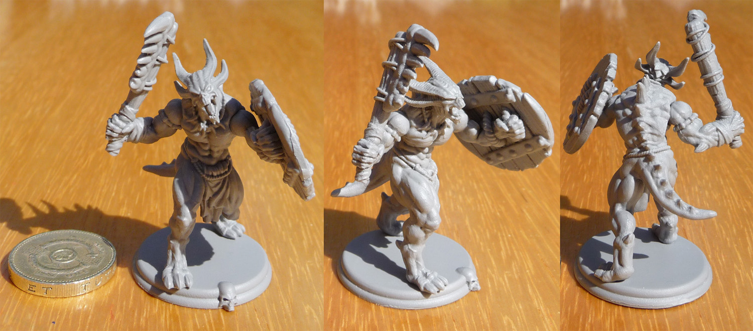

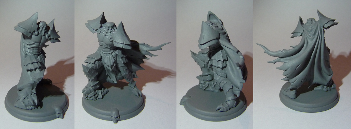

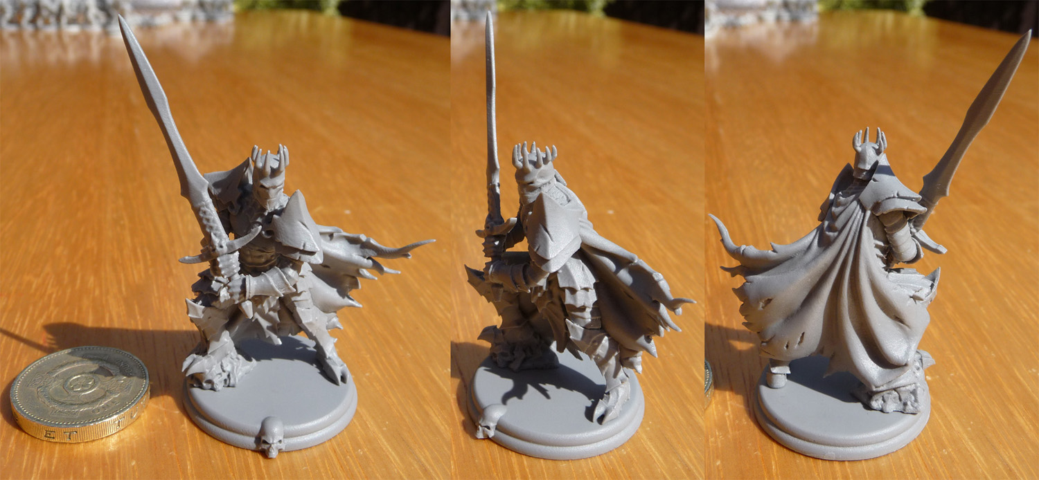

I have posted pictures of 3d prints and casts. The 3d prints are the ones just after the renders ant they are not assembled.
The casts are the assembled ones sitting on the wooden table.

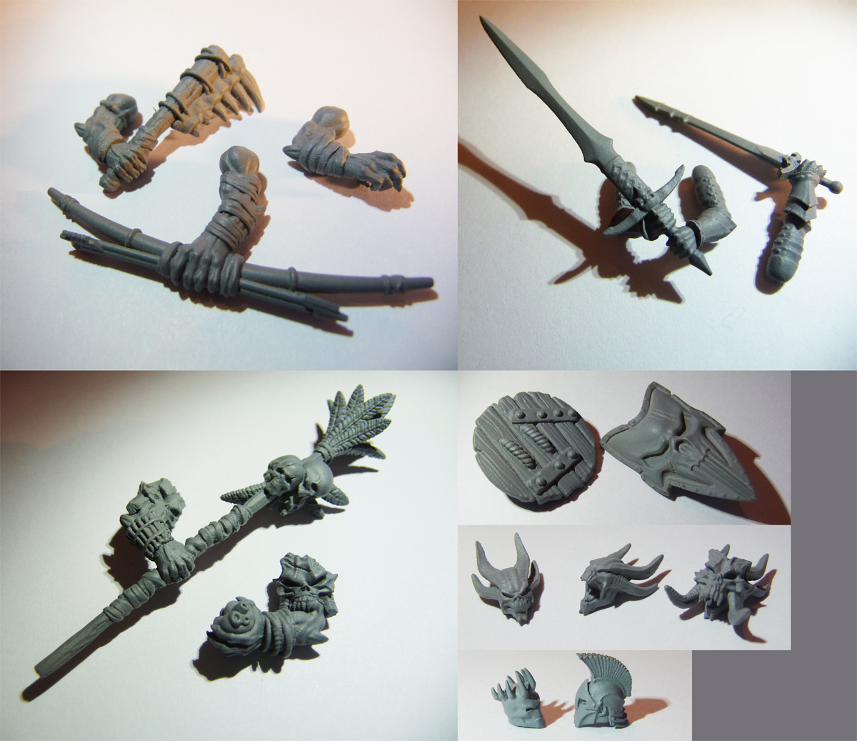

For the process of splitting up into parts, this is what I do:
After completing the character’s body I turn it into a dynamesh and start slicing it into parts. For the shoulder sockets I use a sphere to subtract from the body, and the same sphere to fuse it to the arm, so that they should match.
From that point onwards its just a matter of remeshing, completing the sculpting on all parts, and adding all the accessories.
The trickiest things I found where getting the details bold enough so that they would be seen at a small scale (still learning this every time something new is printed), and making sure that the surfaces that need to be glued do actually match (at least close enough)
Oh, and you need to think of how the miniature would balance itself (i.e. can it stand up or will it fall?), but to be fair, you can cheat a bit with these because they get glued to their bases :slight_smile:

The scale is a bit taller than wharhammer minis, but the heads are similar size.
We wanted more “realistic” proportions, but at the same height of game workshops figures they looked really tiny :slight_smile:
See the image below, its compared also with another one (far left) from a new boardgame called Kingdom Death:

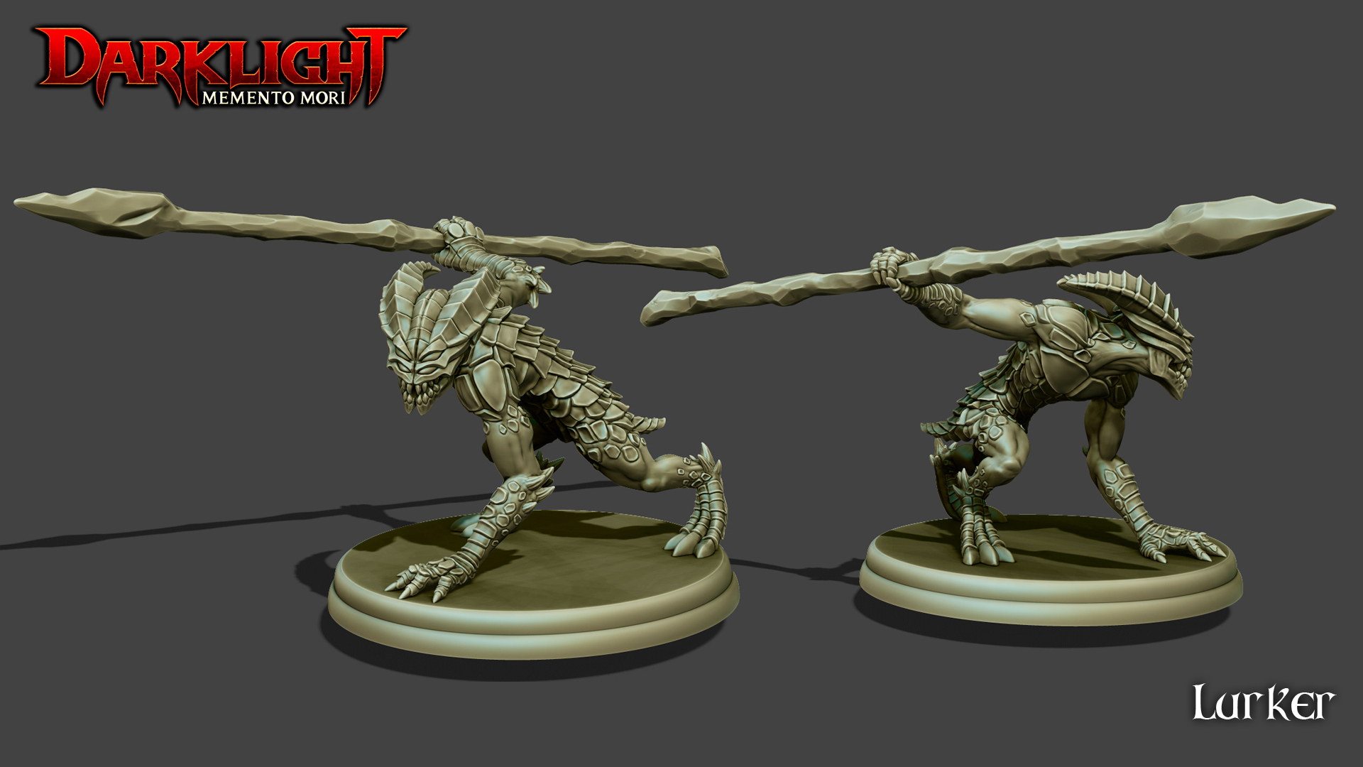

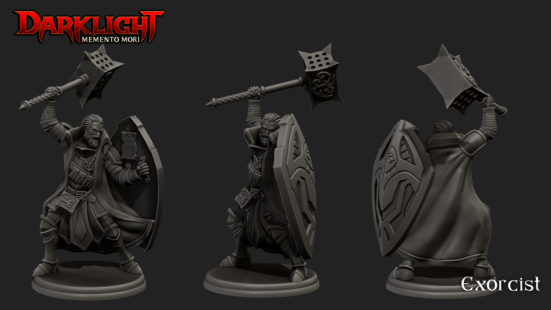

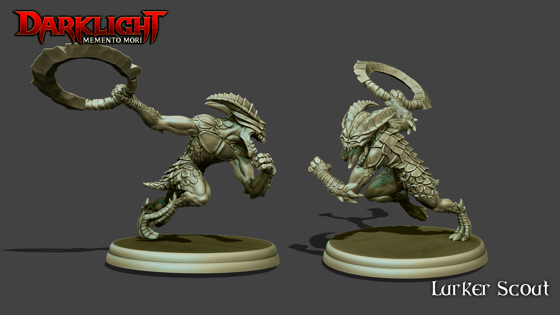

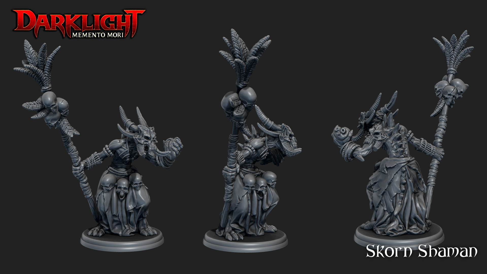

Last year I did a Kickstarter campaign with my brother and got the funds to manufacture our game, so I have been busy finishing off the remaining sculpts :slight_smile:

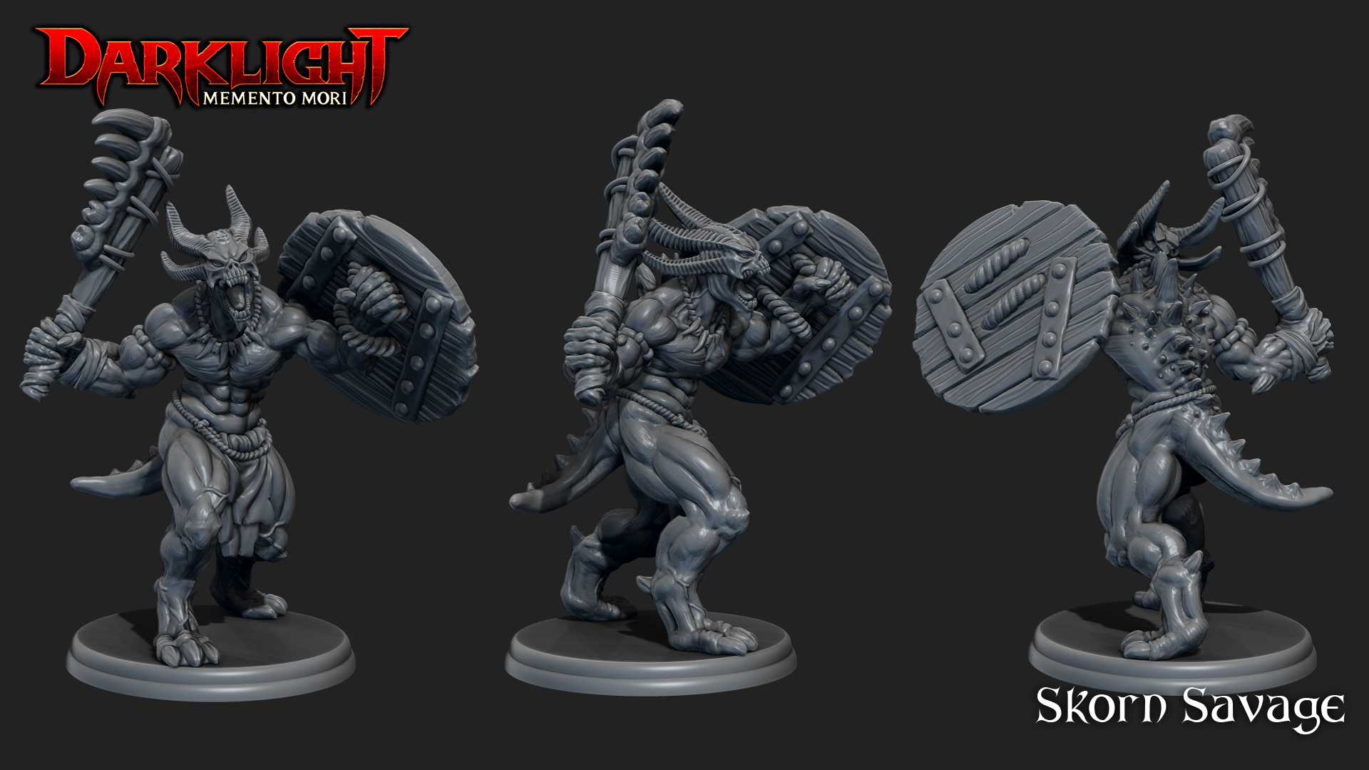

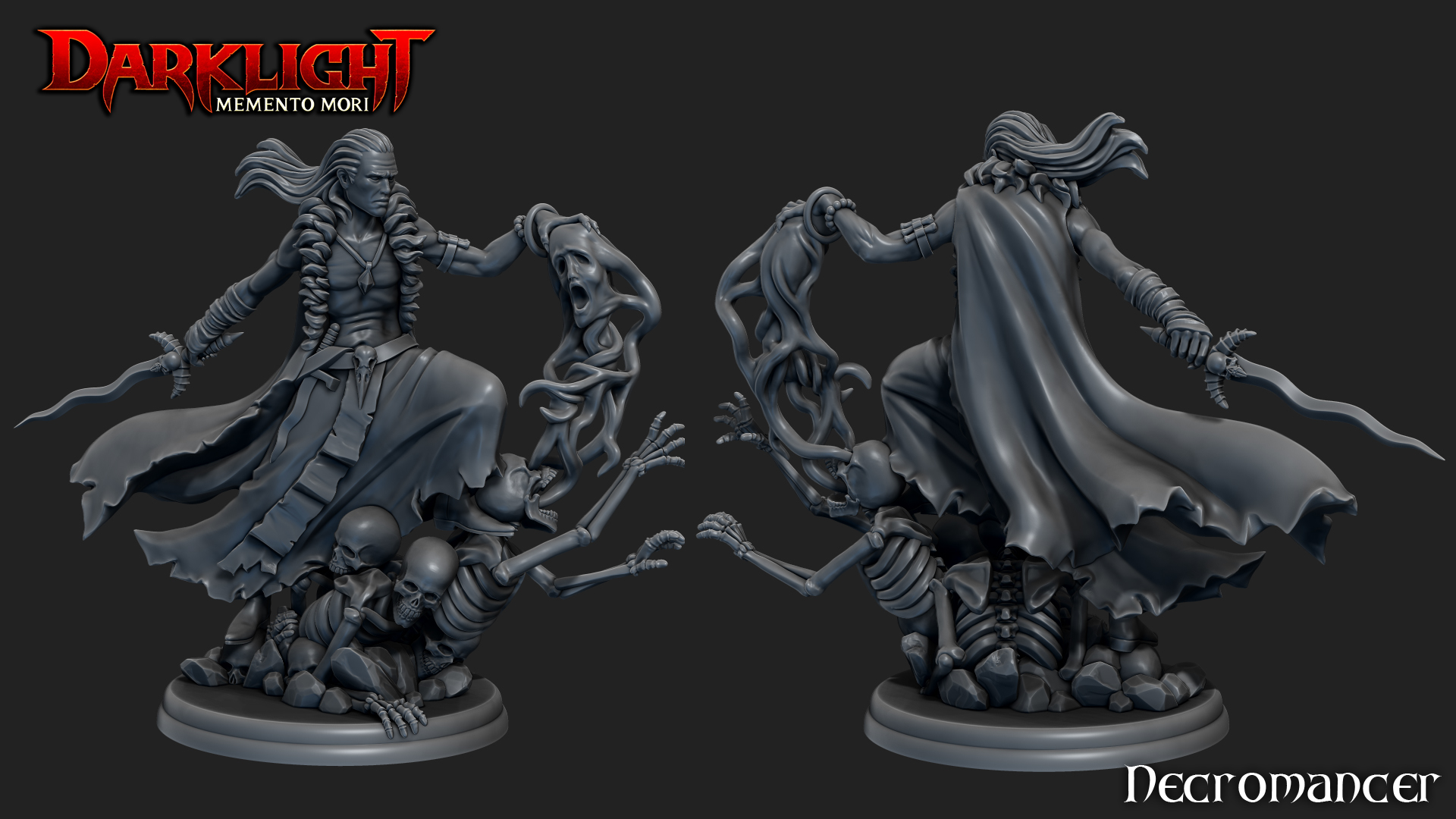

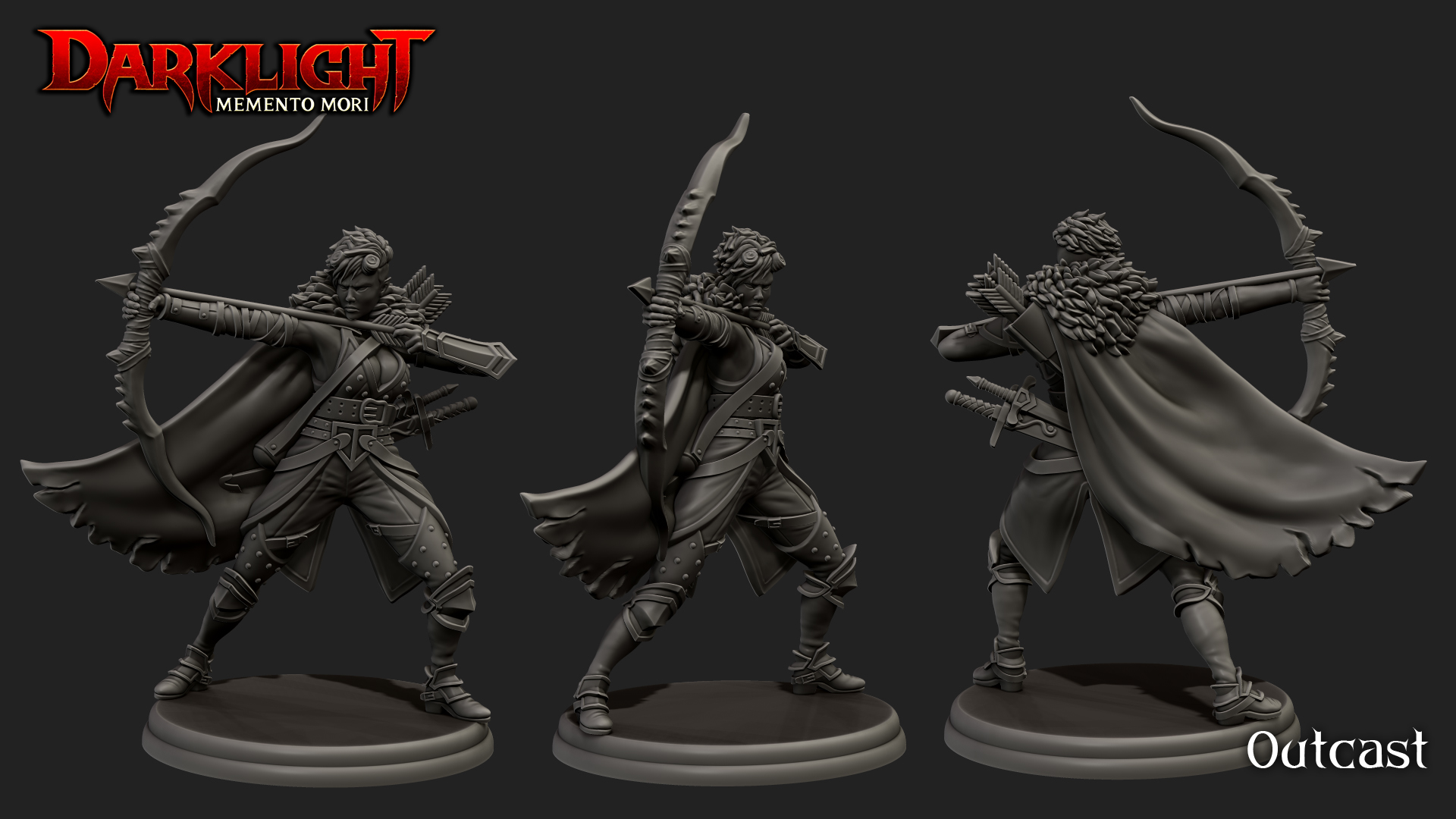

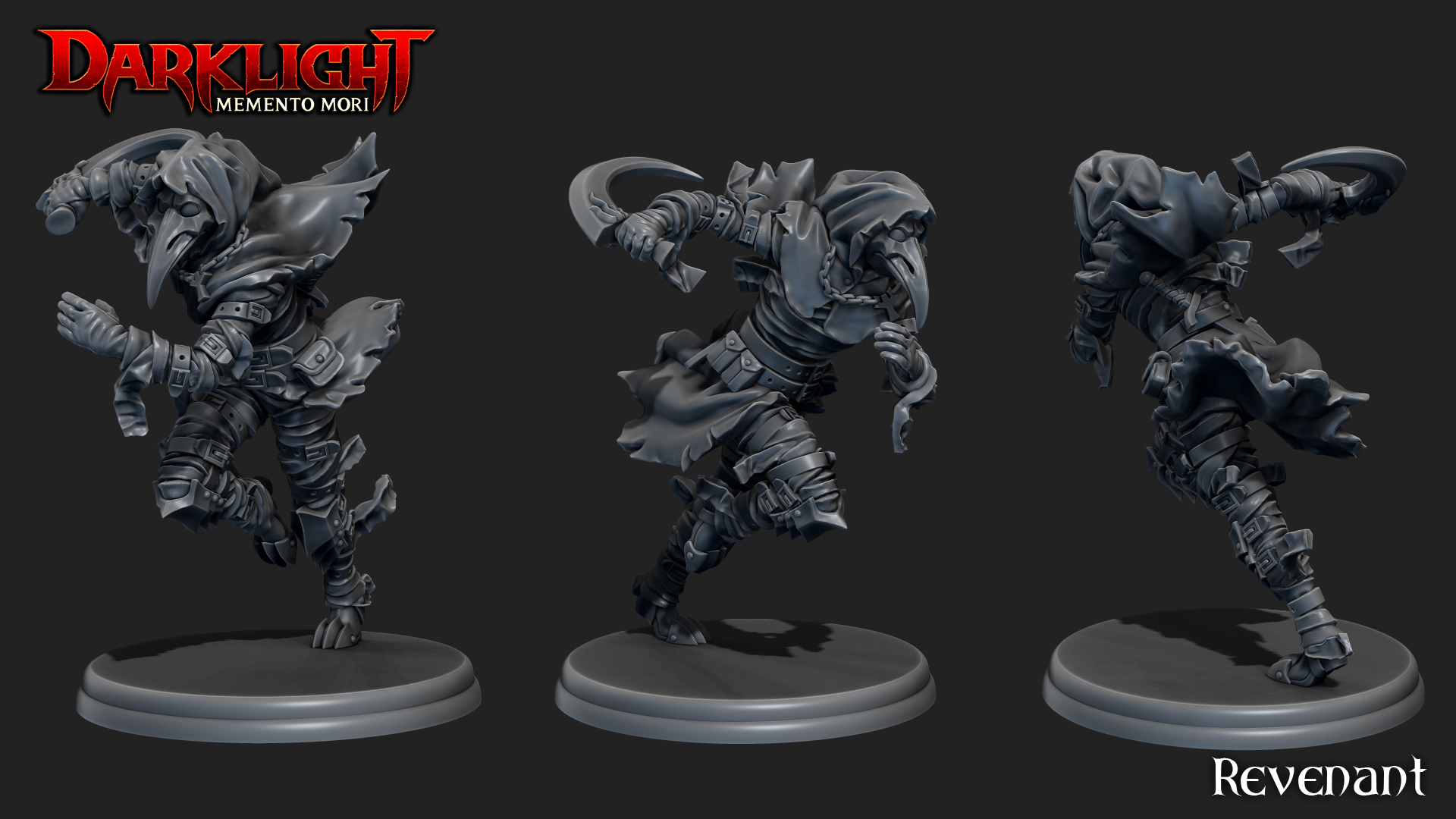

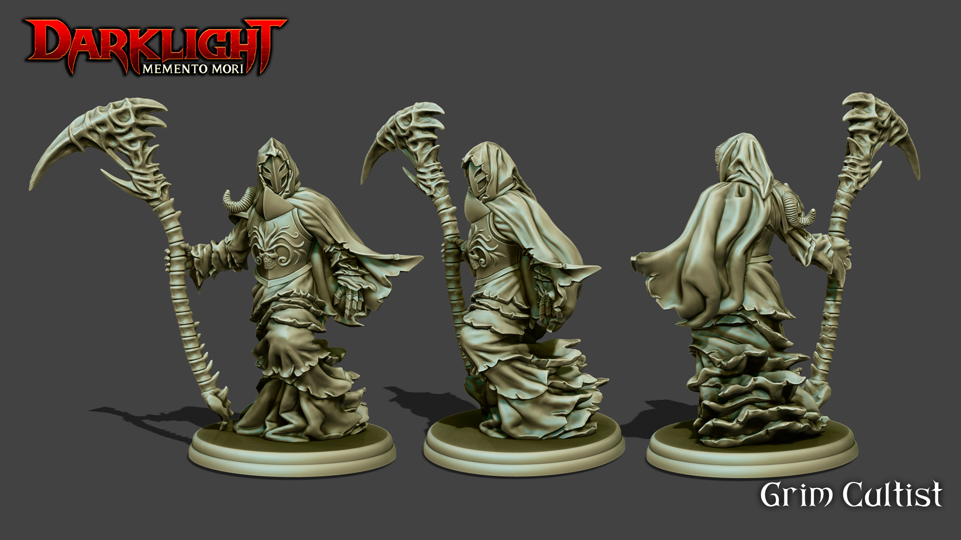

Please bear in mind that these are the actual 3D models that are sent over to produce the moulds for the miniatures, they are not pre-vis renders.
I am saying this because I had to exaggerate proportions and scale of details to facilitate injection moulding - remember that these are small figures, so be gentle with me!
What you see below are the figures for the core game. I will soon post renders of the figures that come with the expansions.
I hope you like them!

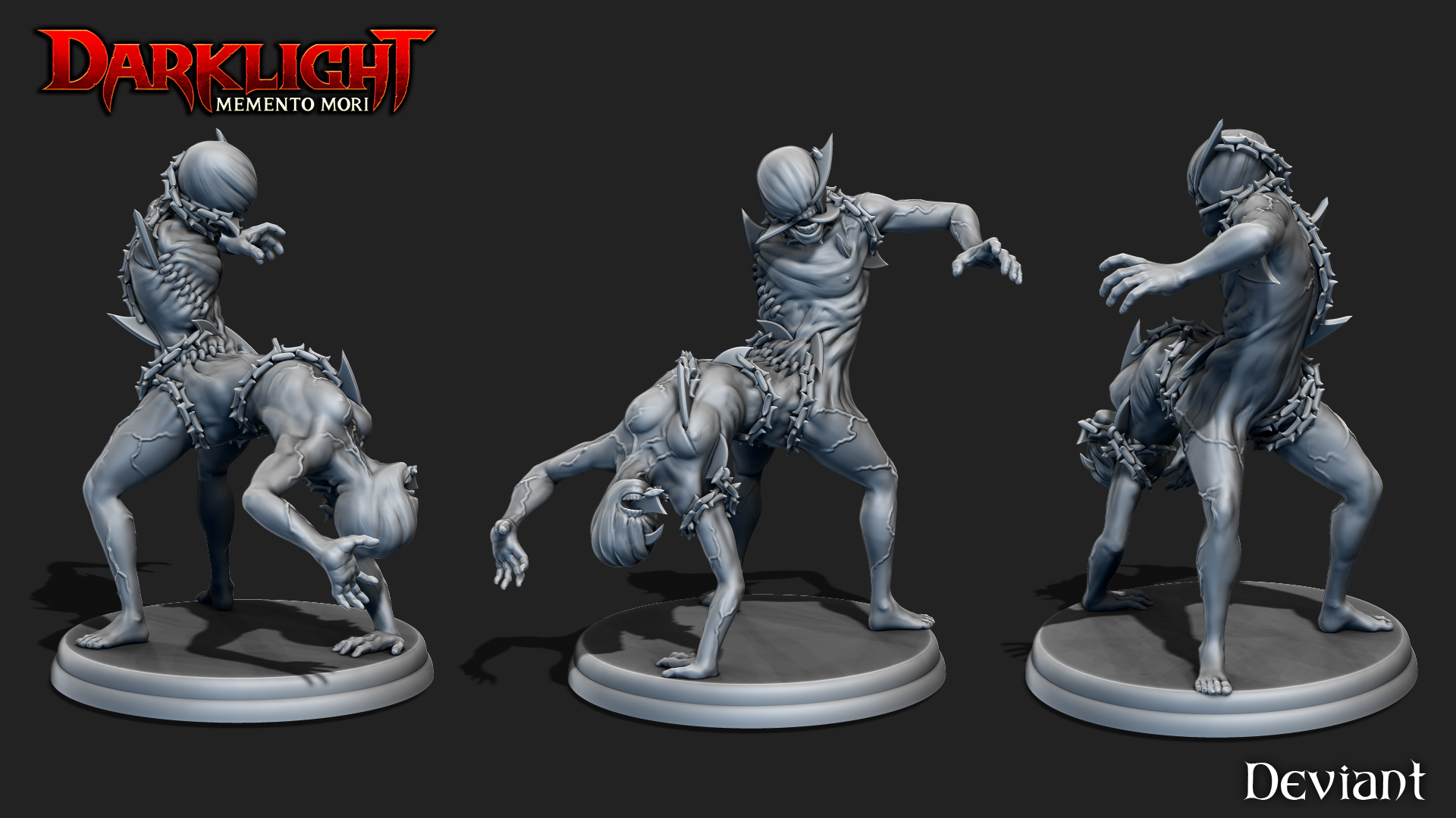

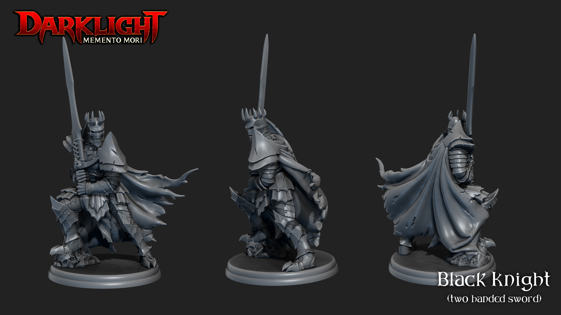

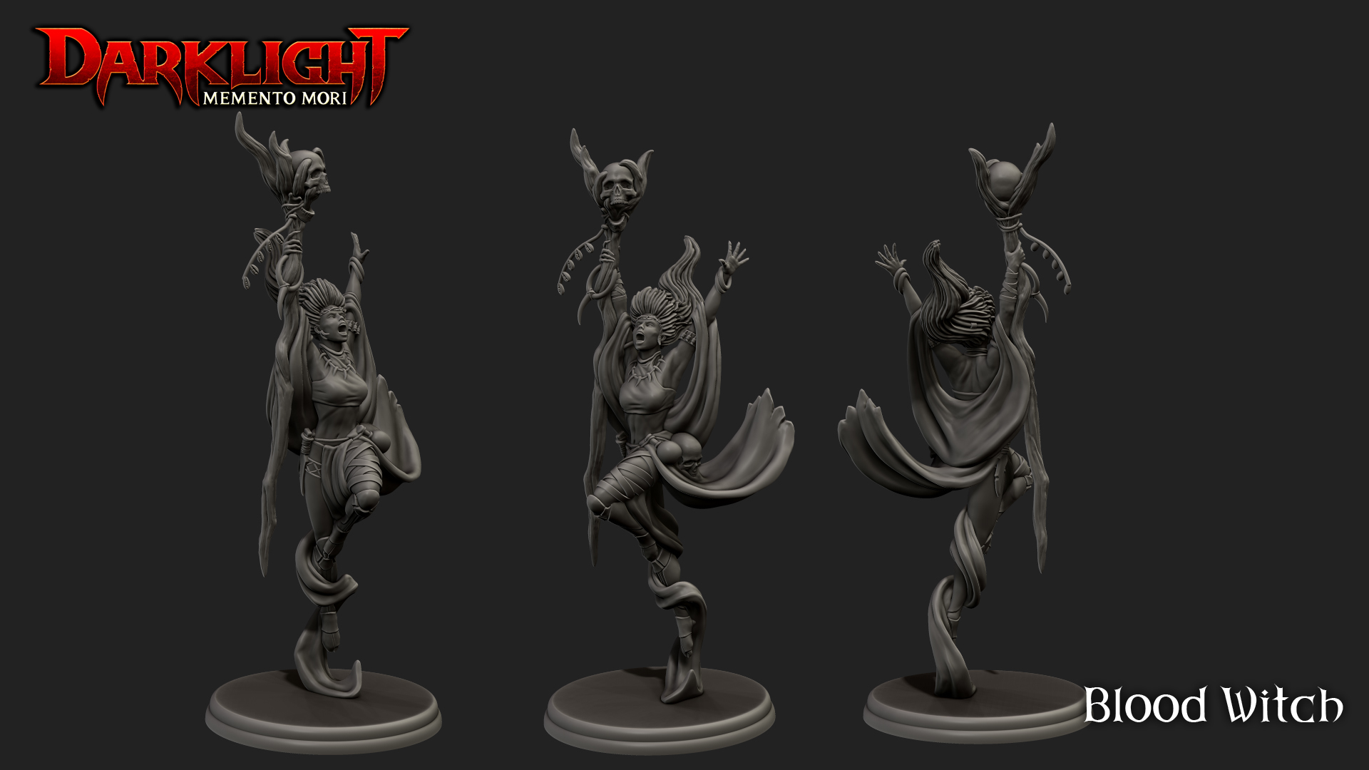

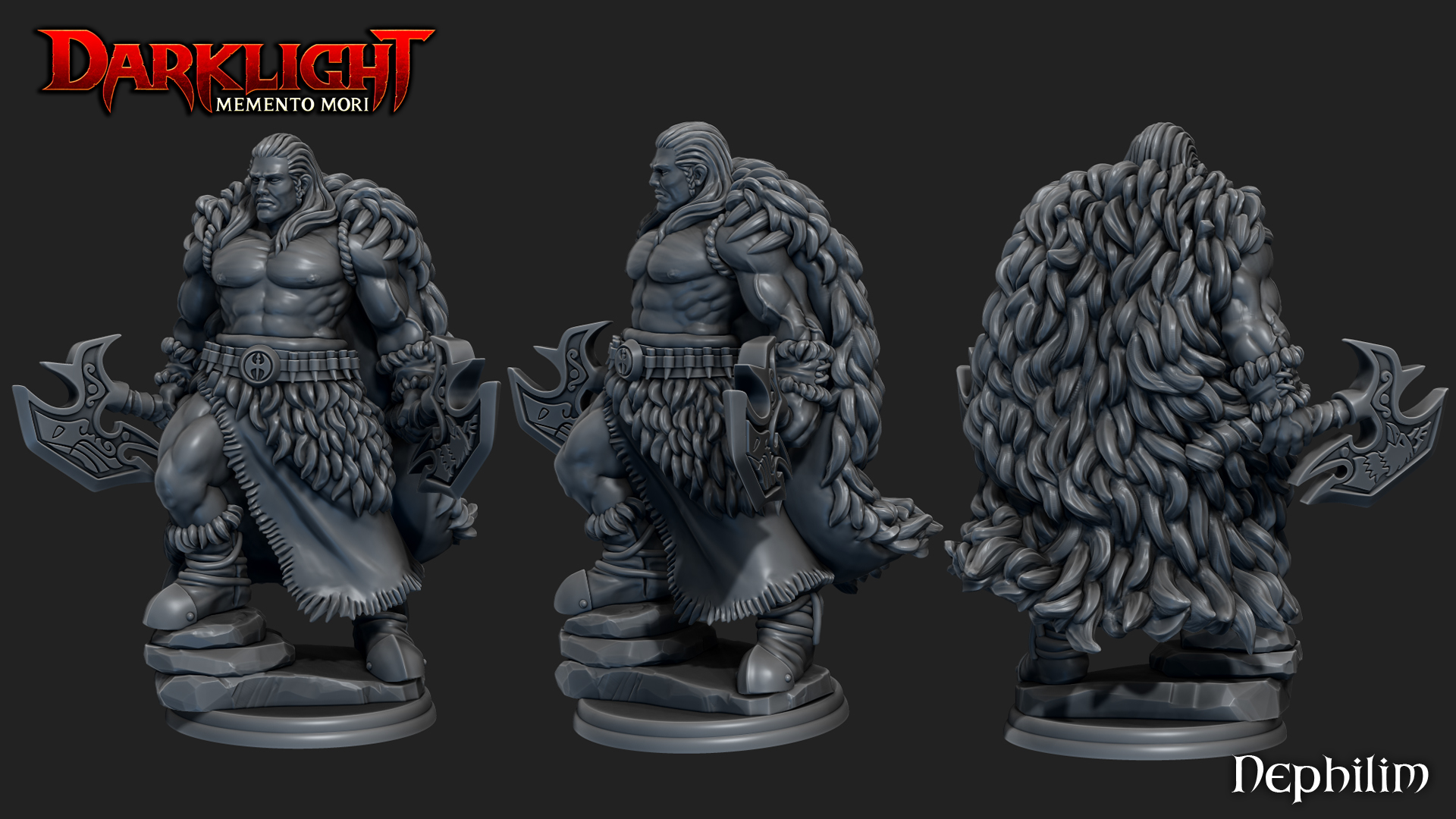

These are the 4 playing characters:

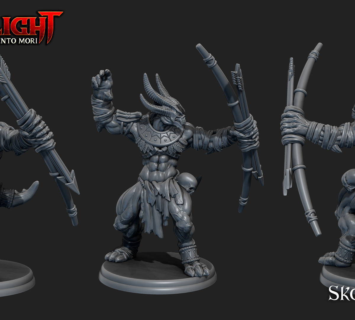

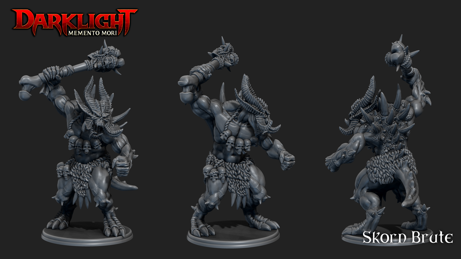

And these are the enemies:
More enemy characters…

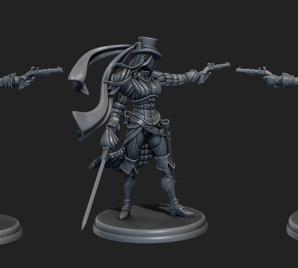

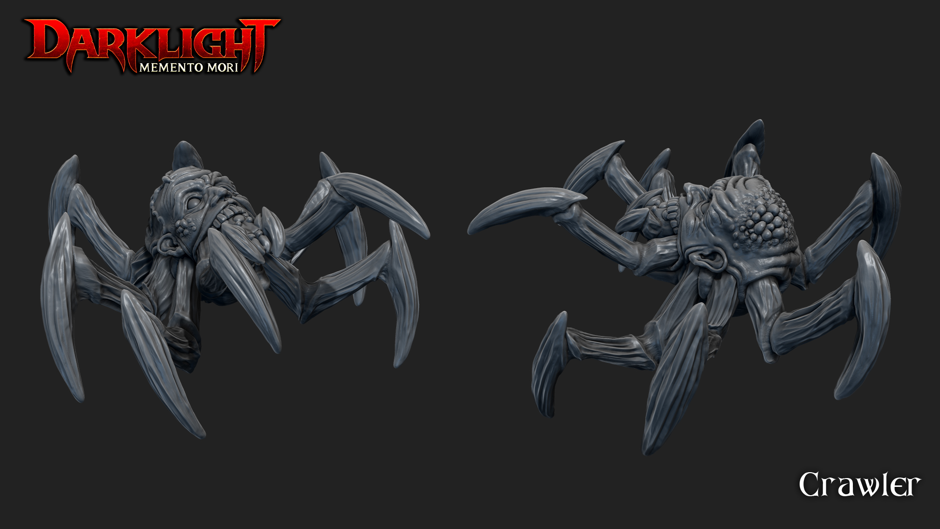

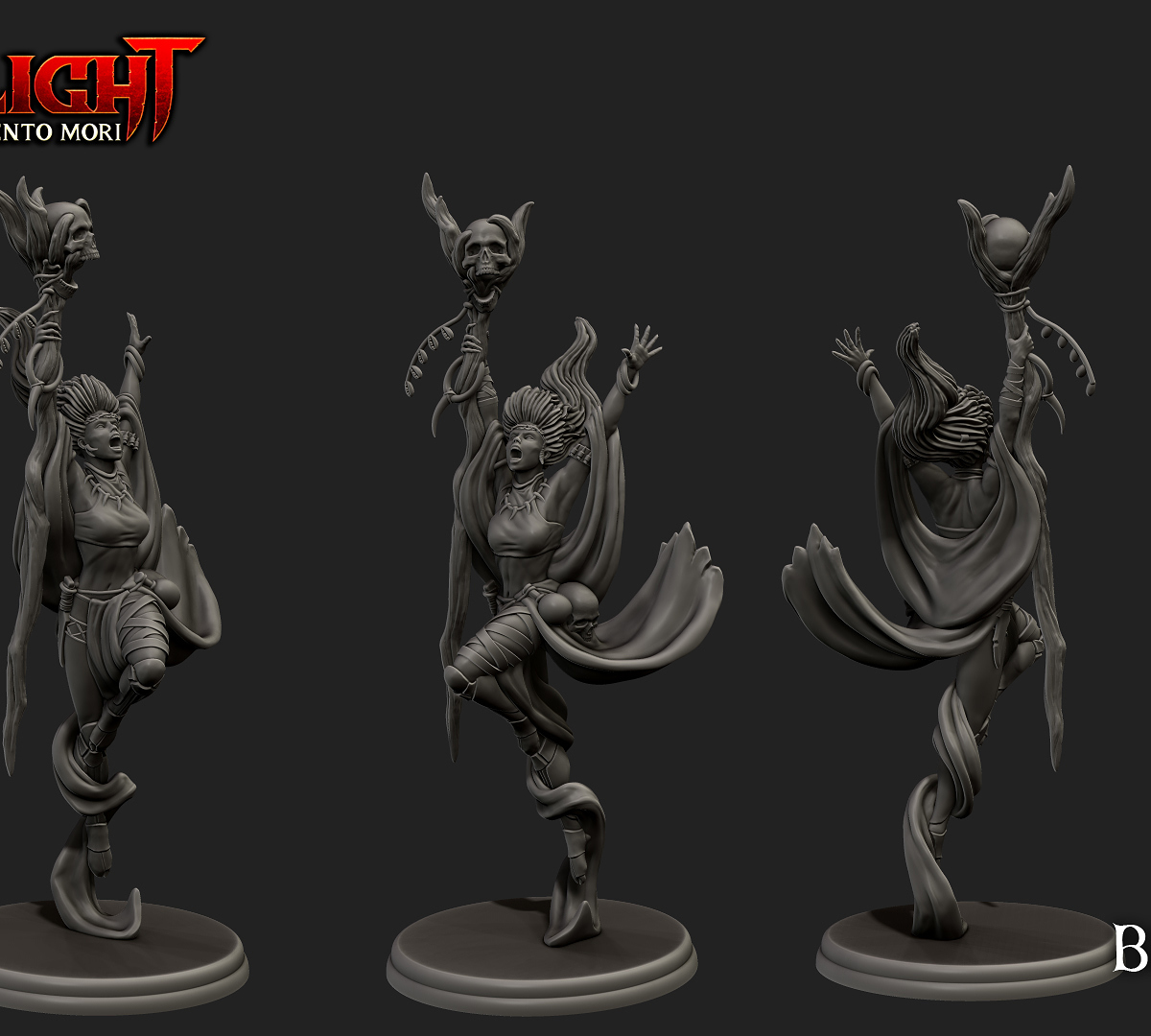

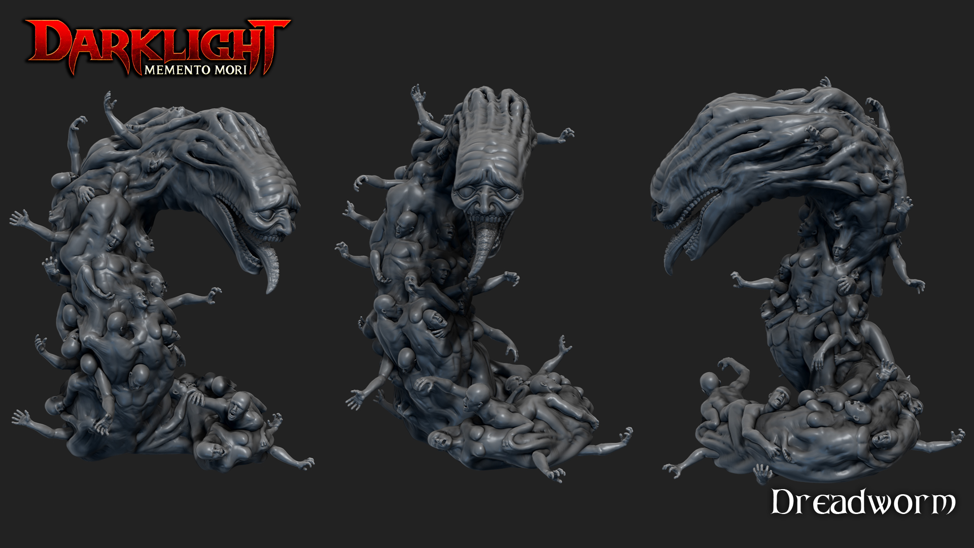

Here are a few more renders. These are from one of the game’s expansion packs:
