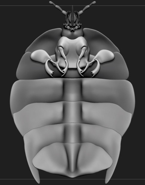

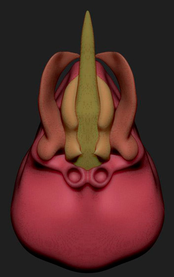

For the head, I started with a new DynaMesh and started to shape it with the ClayBuildup, Move and Shift brushes. I always keep my finger over the Shift key, to being able to smooth or to snap my view to 90° angles without hardly thinking about it.
The labial parts (in yellow) are a new DynaMesh SubTool, like the “Rostre” (in green) while the mandibles (in orange) have been made with the awesome CurveTube brush.

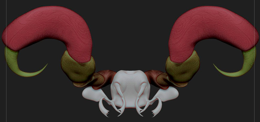

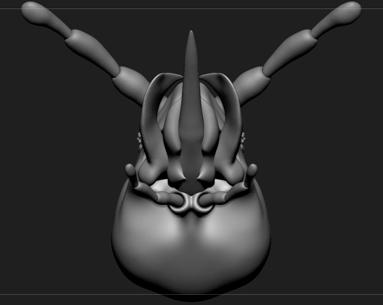

Then I refined and modeled the shapes further with the Move, ClayBuildup, Standard and Smooth brushes. Next I used the TransPose action line in Move mode to set the good position before merging all the SubTools.

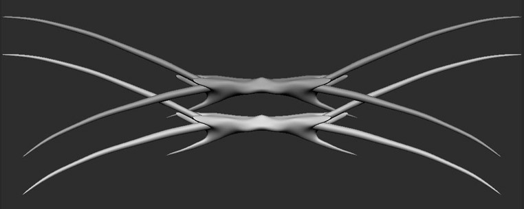

The antennas were created with the CurveTube brush (duplicated twice) and positioned through TransPose like in the previous step. They were refined with the Move and Smooth brushes before again duplicating and merging the SubTools into one. To finish this part, I scale and move them to set the desired position and size.

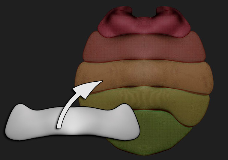

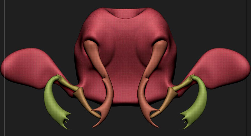

For the next steps, it’s still the same workflow with a new DynaMesh primitive and the same brushes. The difference is that I used a negative inserted mesh to create clean cuts in my models.
I also continued to merge the new SubTools into one after having finished with my mesh manipulation and positioning via TransPose.
This is an assembly of the existing elements:

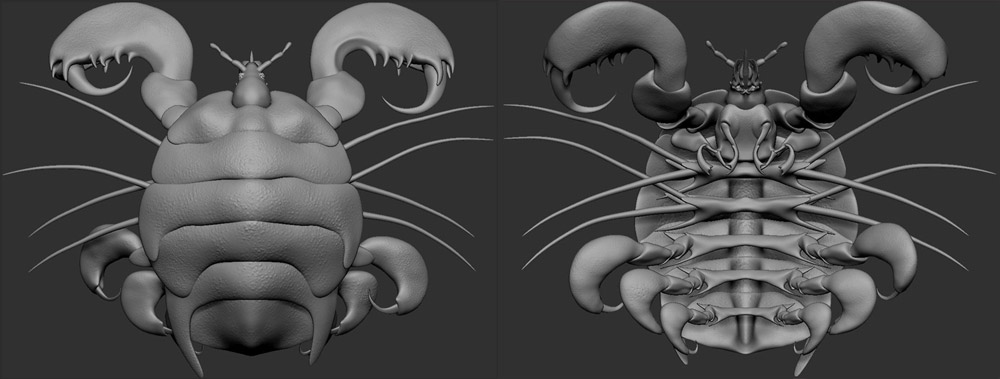

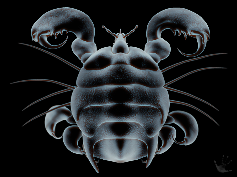

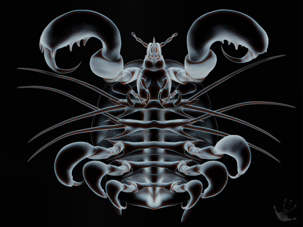

This is an overview of the creature, from the front and back sides. For the fine details, I used mainly the Standard brush, combined with the Spray stroke and Alpha 07. To finish the model, I deactivated symmetry and worked on the overall model to refine it.
For the final render, I changed my document size to a print size of 4480 x 3360 pixels, redrew the figure and did my render using the BPR. For the book and printing purposes, the texturing and compositing were done in Photoshop in CMJN mode and 300 dpi.
