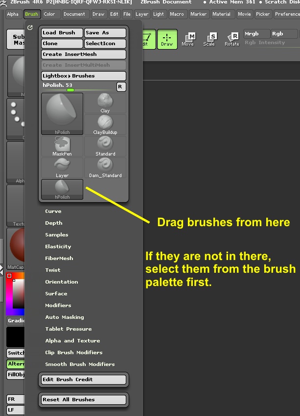

Trying to add custom brushes (MTB set of brushes)… I enabled Customize the UI, then I open the brush palette, load in the brushes one by one from the download folder, and drag them down to the bottom bar that appears…
Do the store thing, when I restart, the bruishes are no longer in the palette and the bottom part of the UI where I had placed the custom brushes are empty…
I am slowly losing my patience… can someone tell me my fundamental error, I can think of a couple of reasons why it isn’t working, but they’re just guesses.
Thanks for the help and the patience…
Thanks, yes, that is where I am dragging them from… but when I store the config and restart later, they are gone again… when I enable customize, there is a dark empty spot in each place where I had dragged them earlier.
To be clear, I am able to load them from my download folder, and then drag them to the UI from that side bar you hilighted… they are not there when I restart, even when I make sure I click Store Config.
If they are custom made brushes that are not in the startup list, then their slots will be empty in a custom UI until you load them from Lightbox, at which point they’ll appear in their designated interface location.
