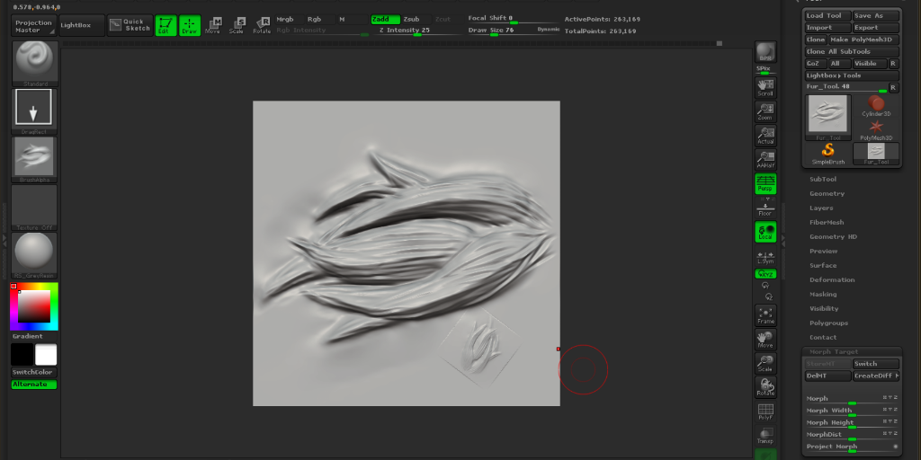

Can post an image? I’m not sure what result you’re getting.

I have an image now;
Ah, thanks for the picture - it makes all the difference. What I think you have done is deformed the plane inwards as well as outwards. In order to capture the inwards displacement, GrabDoc is capturing the whole plane. You can solve it like this:
