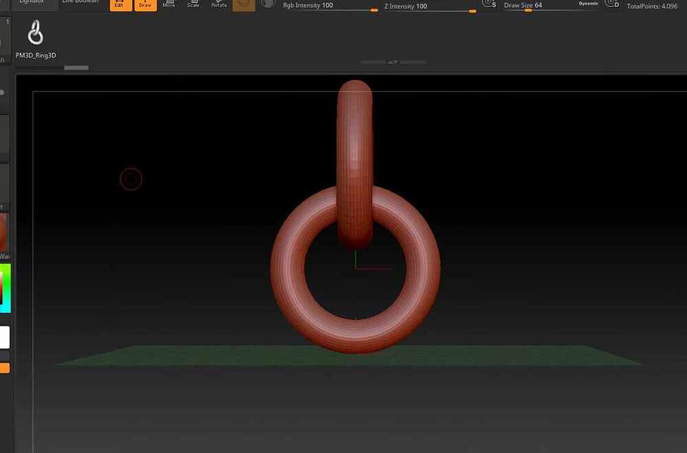

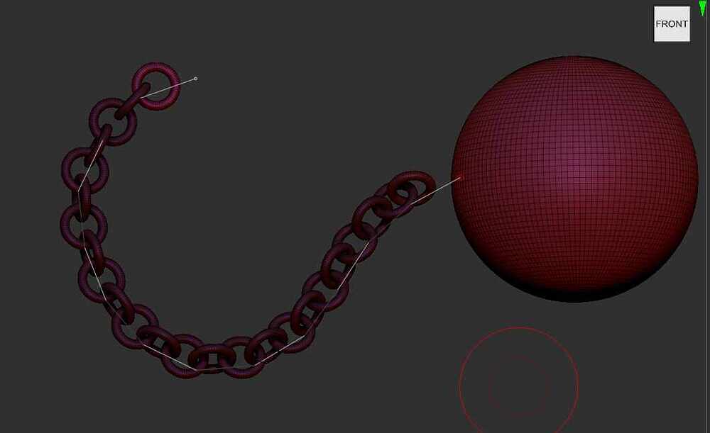

hello I would like to ask how to let curve step shorter to complete chain.
I made chain base by two rings, and to make it continuous,I want to step length shorter. the picture above is my current situation.
I hope to get any advice, thank you.

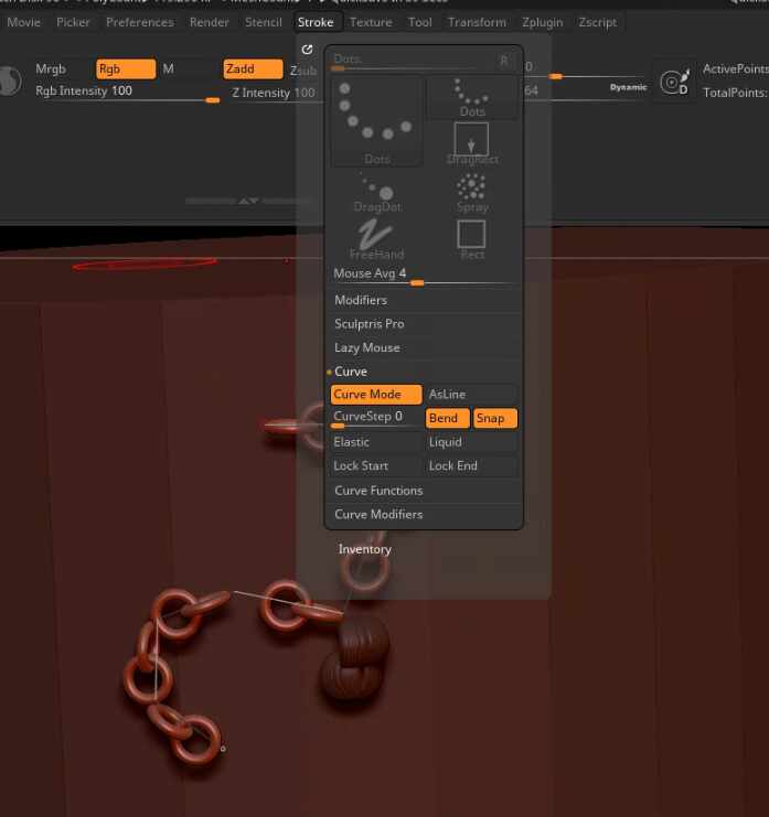

Hello @katosaori

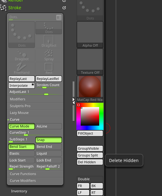

Go to “Stroke > Curve” and adjust the “CurveStep” slider.
hello thank you @zber2 .

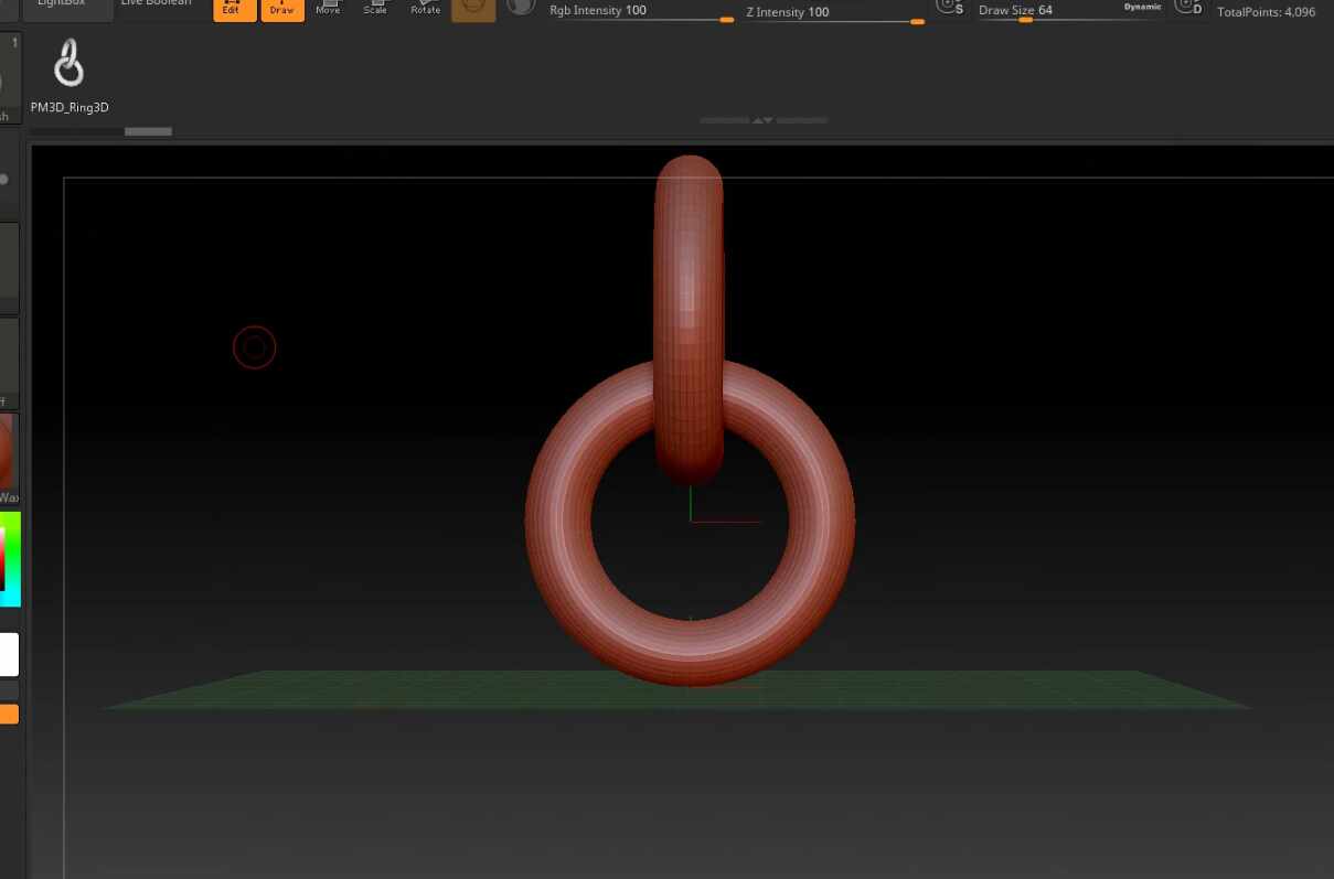

yes the picture above is in condition CurveStep “0” curvesteps3.PNG I wondered if making brush phase was wrong like I maybe needed changing pivot?

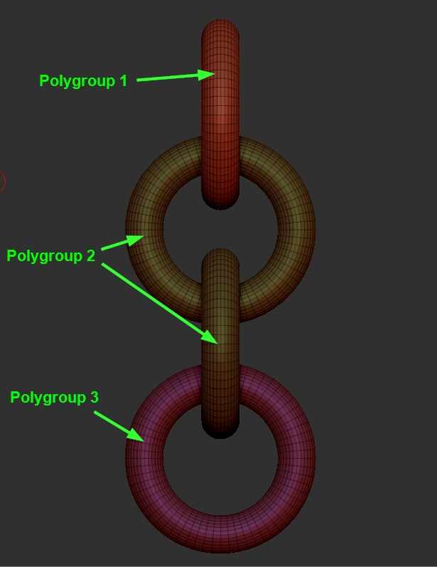

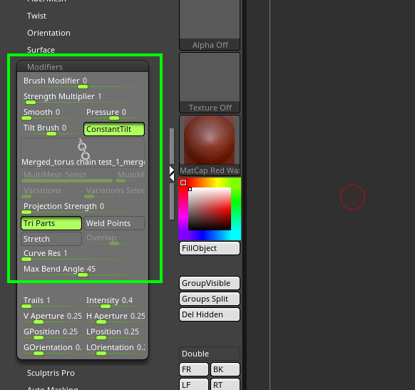

Hi @katosaori

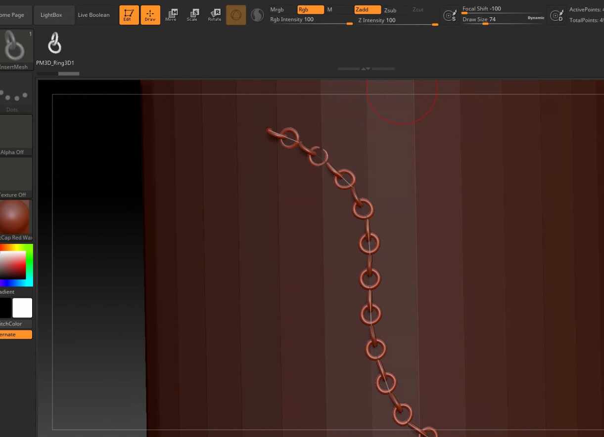

You will have to make it a Tri Parts brush to make a linked chain which consists of 3 polygroups. I have uploaded the brush if you want to download it.
torus chain_IMM.zip (73.5 KB)

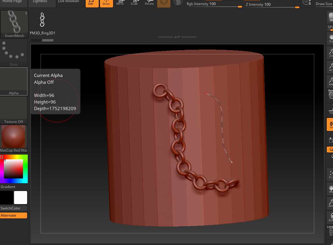

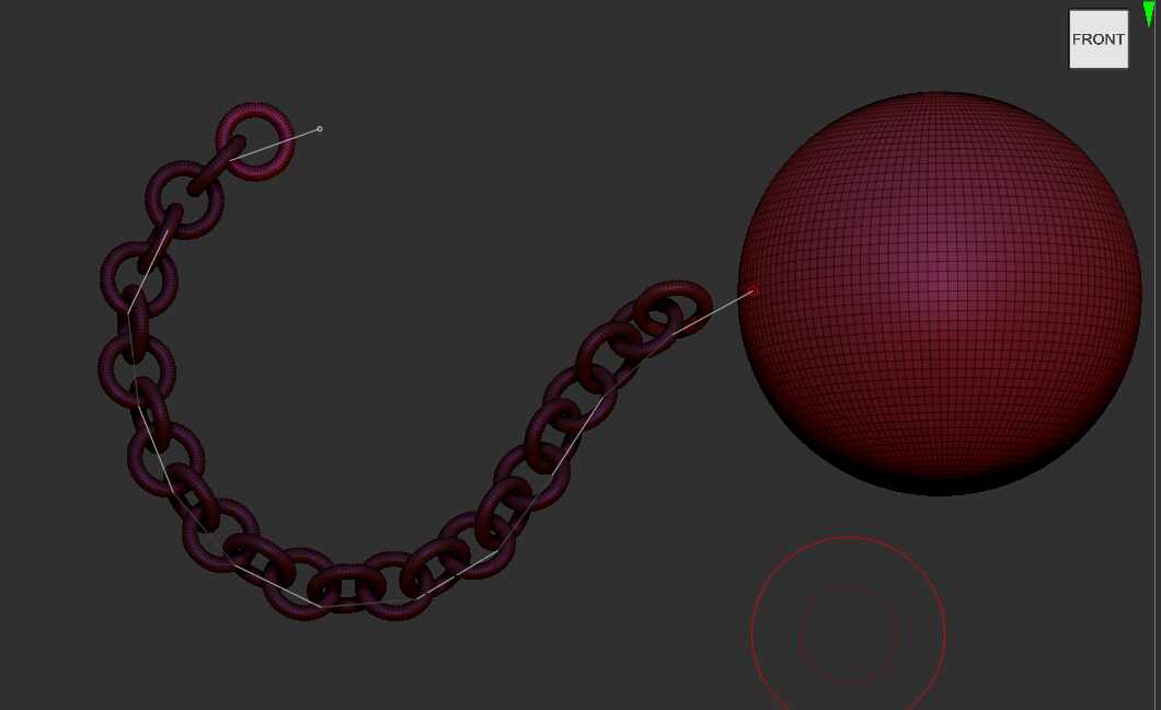

2022-11-15 13_36_40-2022-11-15 10_06_50-ZBrush
2022-11-15 10_08_12-ZBrush
2022-11-15 10_09_01-ZBrush
hi @zber2 I appreciate for the answer. I could make linked chain.
and thank you for the IMM brush too.
