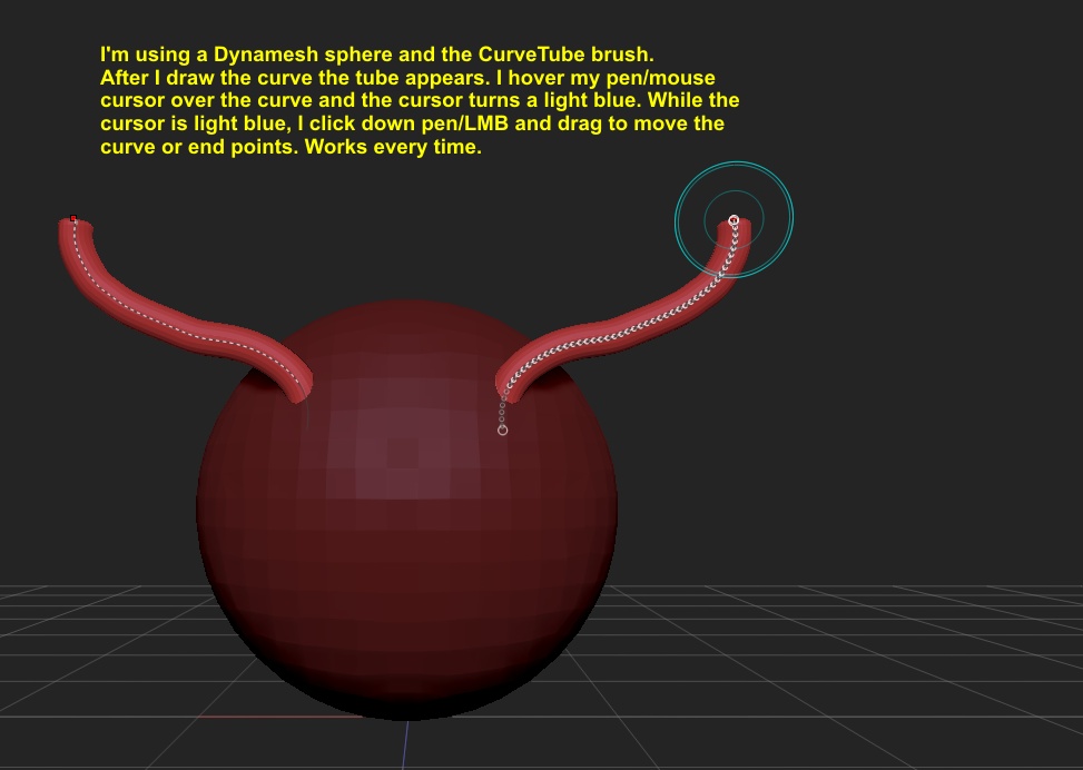

OK, I just loaded the Dynamesh sphere project and using the CurveTube brush, drew a tube and didn’t have any problem manipulating the curve/tube. You do have to click down when you have the blue cursor to edit the curve. Are you doing that?
Yep. I’ve tried that (left-click)
It has no effect. Unless I’m too far away from the curve, in which case I drop out of ‘curve edit’ mode. :confused:
Right-click gets me the shortcut (spacebar popup) menu.
Thanks for your suggestions though.
OK. Thanks zber2. I have it now. Click AND drag.
