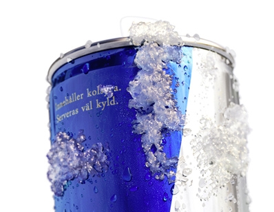

Guys how would you sculpt this kind of crushed ice
[z.jpg[/ATT]%3C/font%3E%3C/a%3E%3Cbr%20/%3E"][attach=248340]z.jpg[/attach]](http://%3Cfont%20color=%22#9a9a9a%22%3E[ATT=248340)
The easiest way I can think of would be to rough in the main structure with something like the clay or clay build up brush then play around with the surface> noise properties to create the fine detail. Alternatively you could try making some custom alphas to use on your brush.
Edit
if you’re also trying to achieve a “broken up look” to the ice chucks you could try making your base mesh with zsphere>zsketch, or by painting a mask on another surface and using the extract button; that way you could leave small isolated gaps in the mesh where the ice has been melted or simply did not form.
Hope that helps
yeah I was thinking about making whole structure based on zsketch
