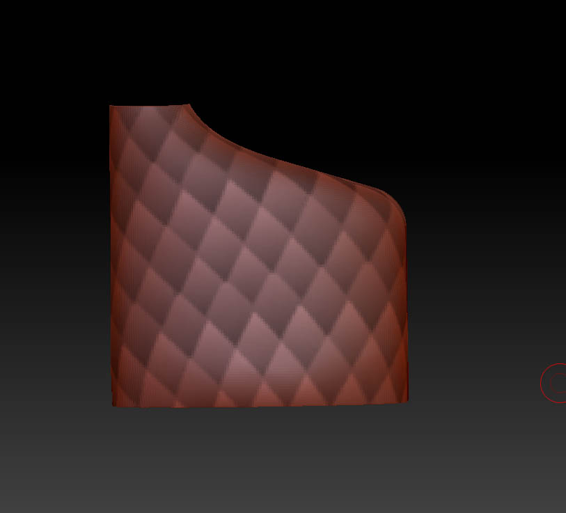

Hi. Does anyone know how to get straight UV’s from UV master?
Once I unwrap the apply the mask, the mask is crooked. See pic.
My goal is to get the scales straight across the model.
Thanks!

In UV master , work on clone, then flatten and you get your UV layout.make changes masking polygroups to select the areas that need rotation… rotate and move with the transpose line… you can even use the move tool to stretch some parts if needed or use smooth…
when you are done, go to the uv subpalette make a planar uv… now back in uv master copy the uvs … you are done with the cloned tool. Now select the original and paste uvs.
I will give this a go. Thanks for your help !
