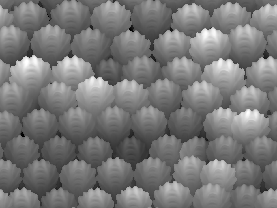

Here is my first attempt at seamless alpha creation using the aurick technique!
Enjoy
Thank you, I tried it and now it works like you said. :slight_smile:
