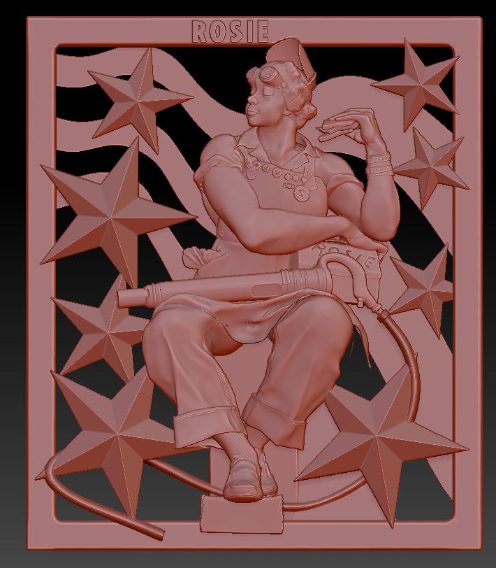

Thanks for the replies. This is what I am doing.
I did not make the original Rosie model but I did flatted and did the placement, frame and background.
This image was made as a flat rectangle.

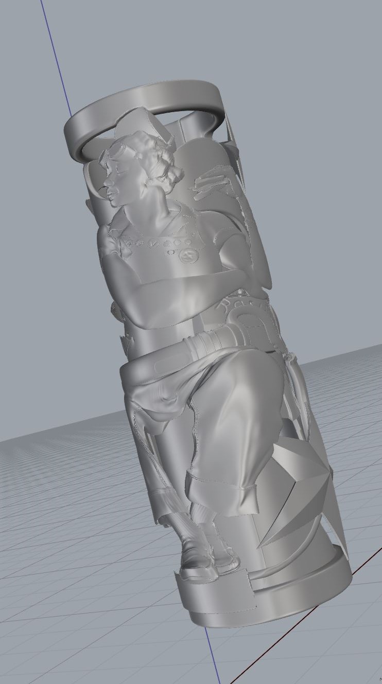

I then took it into Rhino and made it into a tube.
