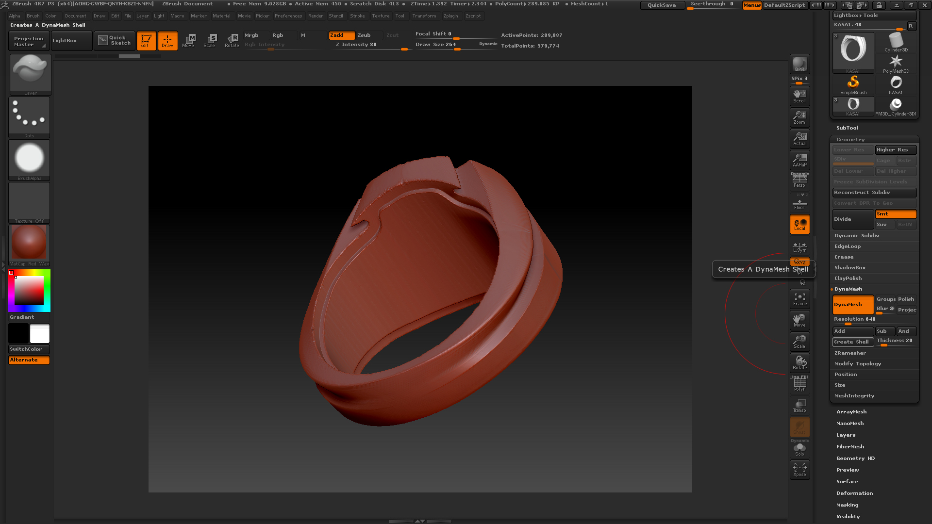

In Zbrush, I imported them into the same subtool. Dynameshed them with a resolution of 640. I set the cutter as a “sub” and merged down the positive ring subtool with the negative cutter subtool and got the thing on “1.jpg”. I want to have a wall thickness equal to the thickness that is visible at the edges inside the ring.

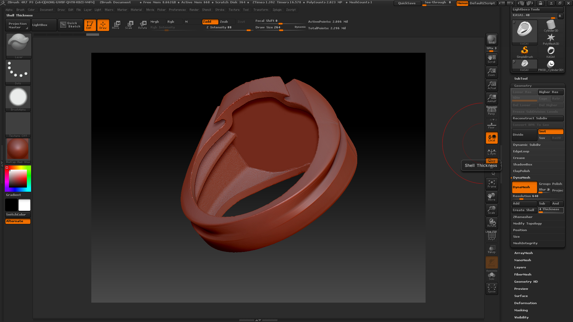

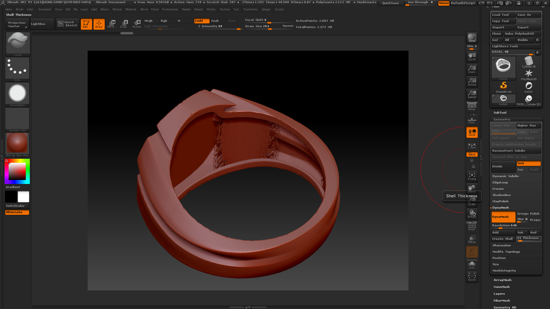

When I switch to “Dynamesh” section in Geometry section on the left, the default options was Blur 2, Project On, Resolution 640, Wall Thickness 4. I turned off the project and let the others be. When I hit the “Create Shell” button, I get the result on “2.jpg”. This was good except that it was too thin and it didn’t match the thickness that I have on the inside edges of the ring. So I increased the wall thickness to 11, hit “create shell” again and got the thing on “4.jpg”. As you can see, there are some problems there. I am not sure how to clear those super thin polygons (burrs) appearing inside the hollow.

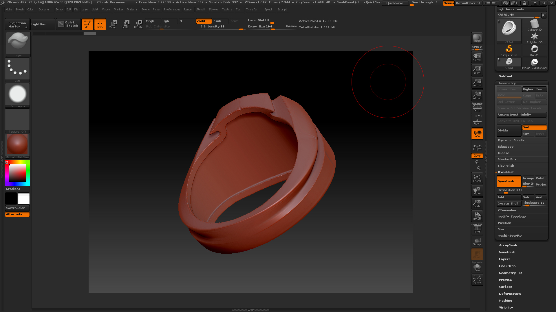

If I increase the wall thickness value even more, I got the thing on “3.jpg”. Which, obviously, looks like a subtraction instead of a create shell operation.
