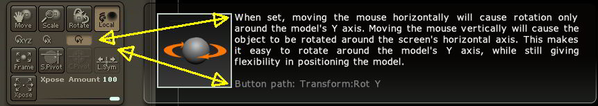

the viewing space is 2.5 dimensional so it is not possible to move the camera. there is setting which makes it easier for newer users in the transform pallet shown below. or you could use the http://www.pixologic.com/docs/index.php/Timeline
THANK YOU, that was EXACTLY what I was looking for, I click the Y button, and navigation of my view is exactly what I needed.
