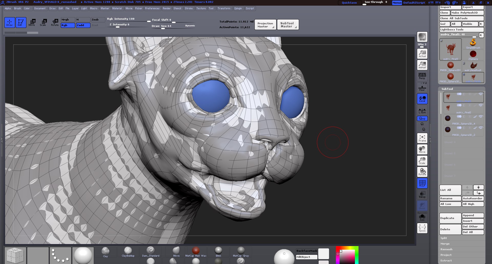

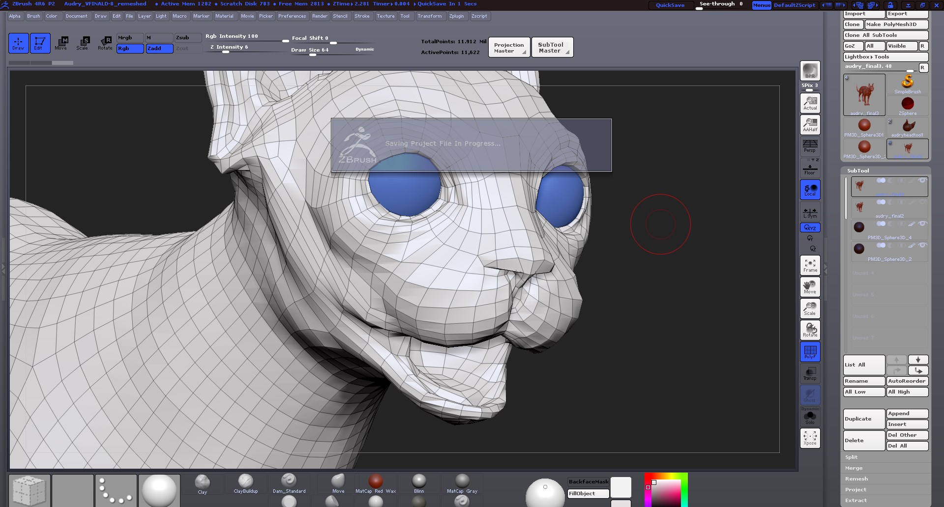

Try and be patient with me ;). I’ve attached several pictures of my results of zremeshing my model. My quesiton is. I projected All, button the main mesh(the duplicated is of the main model), and I’m not sure how much detail was actually retained if any at all? I don’t see it. I must be missing something???

Maybe you need to subdivide and proyect all again on each subdivision

As for the subds, what exactly are you talking about project all again on each subs?
Is there a process tutorial of this? If you know of one that’d be great. I always seem to find a tutorial here and there only covering a little bit of each that I need.

I mean just divide once, proyect All, divide again and proyect All etc… until you have your desider high polycount
