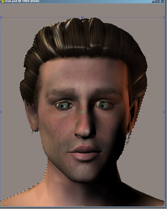

(2) When exporting an image from Poser, a selection is saved as part of the PSD (see image). To see this, create a simple image in Poser with (say) Vic3 against a gray background, and export as PSD. Then, go into P/shop (or compatible program, e.g. Ulead Photoimpact) and load the selection. You will see “marching ants” around the figure. Is it possible to likewise detect this selection when importing the same PSD file into a zBrush document, and to be able to lift it out into its own layer ?

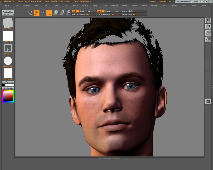

I’m still having problems though. The image speaks for itself … how can I fix this ?
What’s happening is that ZBrush is reading every pixel that is absolute black (RGB 0,0,0) as transparent. To get this to display correctly you need to edit the picture in Photoshop. I’d use the Magic Wand or the Select Color tool to select the black on the hair and then fill with almost black (RGB 0,0,1 will do). The image will then display correctly in ZBrush.
