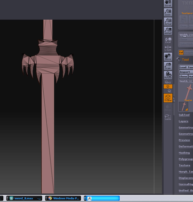

I created this sword in 3ds max 9 then imported it(OBJ.) into Zbrush to get some real detail going. Problem is I have all this funky triangle geometry so I was wandering if I could booleen the outline onto a Zobject and then ditch the old model to work with my new model in Zbrush. Does anyone know how to do this???
Thnx in advance!
when you are exporting it from max in the obj export window be sure to turn on " quads " some times it will wok

Regarding the sword, did you model it like that? Keeping your mesh mainly quads is key for working with ZBrush. Ngons cause holes. Having a few triangles is ok, but verts with more than 4 edges (poles) cause sculpting errors. I often end up with tris and/or poles, but they don’t help.
The goal is to keep the mesh w/ as many evenly sized quads as possible. This way when you subdivide it, you can evenly sculpt detail.
I don’t use max, so I’m not familiar with the obj export. You could always retopo if nothing else though.
