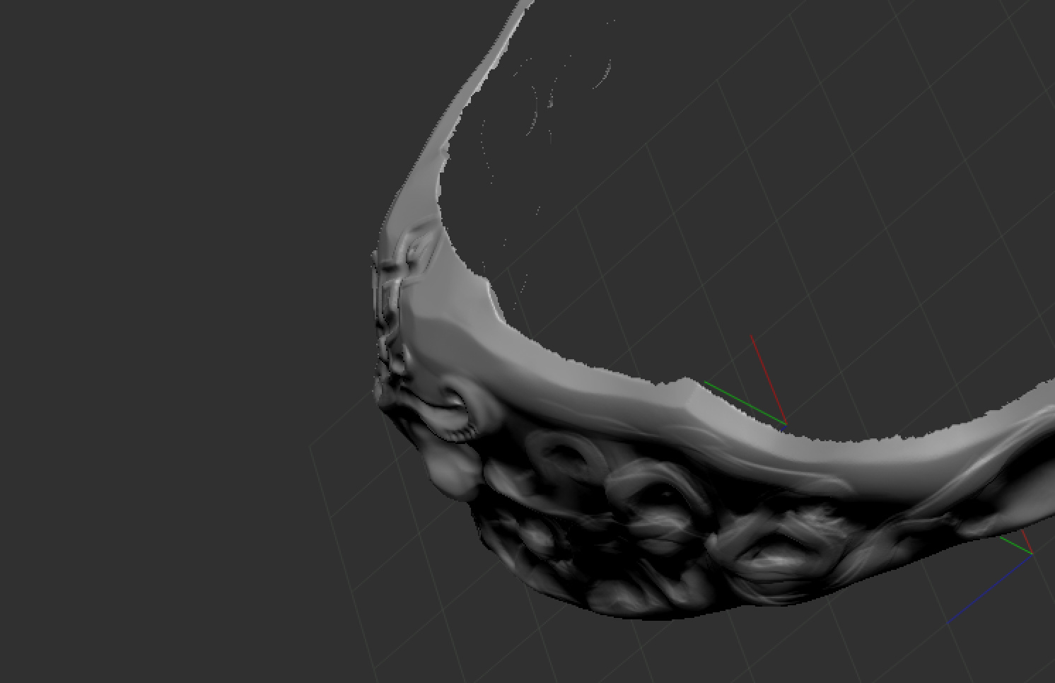

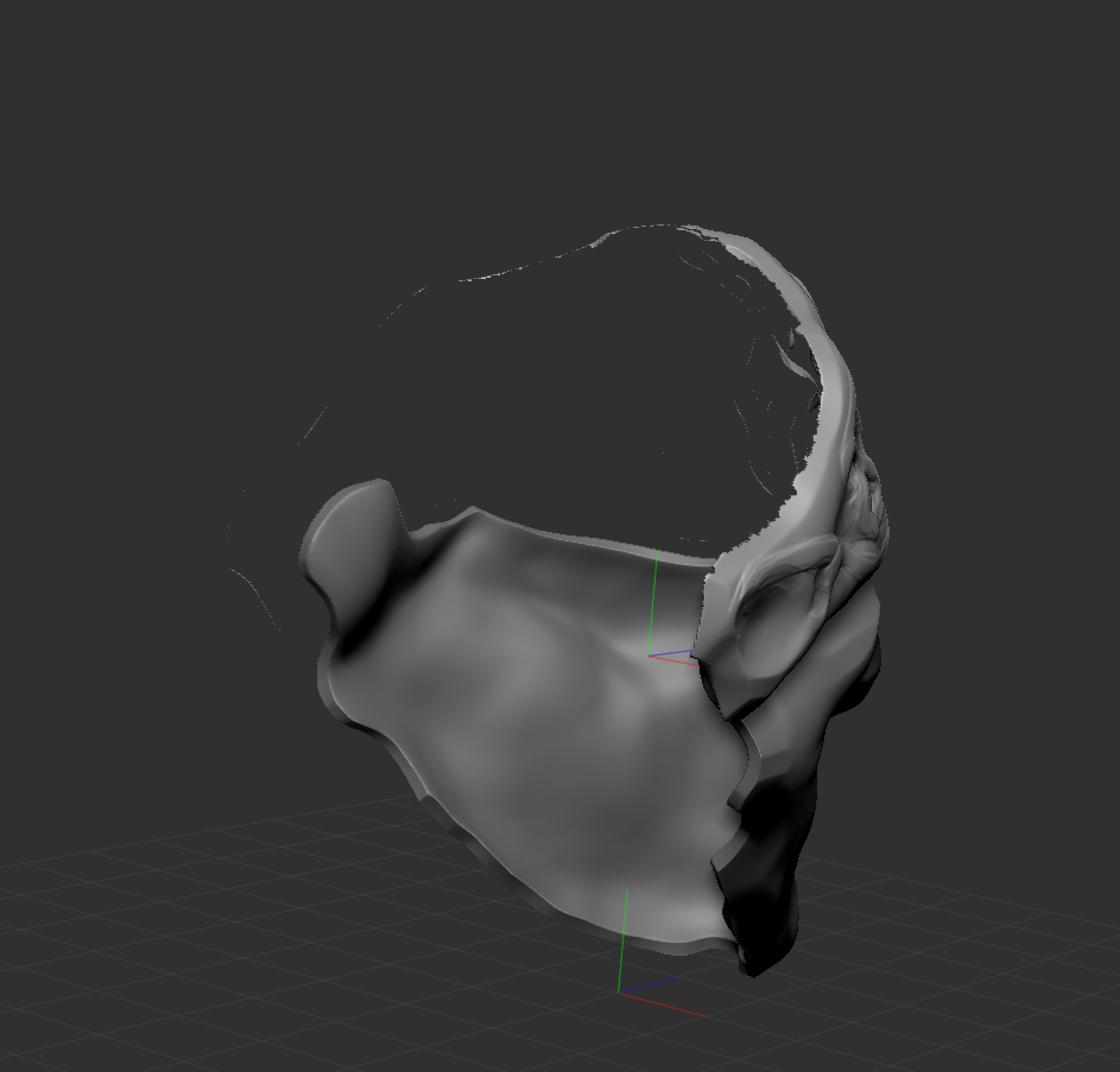

Hi,
How can I repair my subtool ?
It lost back face when working with mask, I noticed it after some time, re uploading whole project did not help, picture below:

If you press Double under Display Properties submenu (Tool), you will see the missing part, but you might want to add thickness to it. You can do this by pressing Extract and Accept after you adjust the thickness as you want.

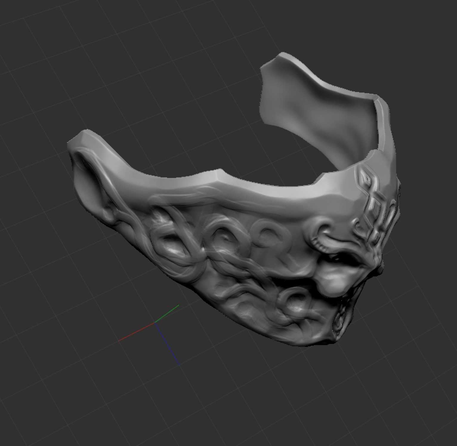

Perfect, thank you - this plus de select showed whole sub tool correctly.
Thanks :>
