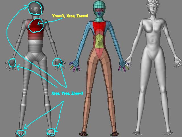

What is the mesh x,y,z res of the zsphere tool…? Zsphere tool-draw it out on the canvas-go into edit- look in Transform>Xres Yres Zres…what are those numbers? That might have something to do with it possibly…or I am cookoo as usual…if your raw zif aka zsphere model has a setting of 1 when you hit preview the eyes will look something like “snail eyes” poking out from the head…look forward to seeing the answer to your prob…
ron
Hi, Ron,
Xres, Yres, Zres are all 0.

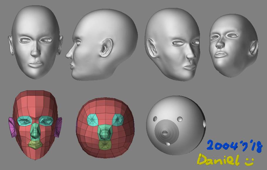

Attached is the ZTL file. Please rename the *.txt to *.ztl. Thanks for help.
WOW! looks like he did a 100 yard dash in a 90 yard gym…
insted of increasing the resolution try makeing a poly mesh from the adaptive skin, and then subdevide it

Does this means one run too fast in a small space, then hit the wall, so face deformed like 3rd image???:qu: :qu: :qu:
yea, I was jokeing about the wall thing… you made a very nice head starter
I am not sure why it did this…
you may have use the tool-deform-rotate on the low resolution preview, snd then increased the resolution… usualy when I do this I get realy bad distortion…

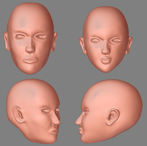

With a good start can make later work easier.
Select Zsphere to create one like this.
Slide the Density to 1 in [Tools] / [Adaptive Skin] /
Carefully move the points to the proper position to get a rough profile.
Increase Density to start sculpting.
Wish this helps to those newbie like me.

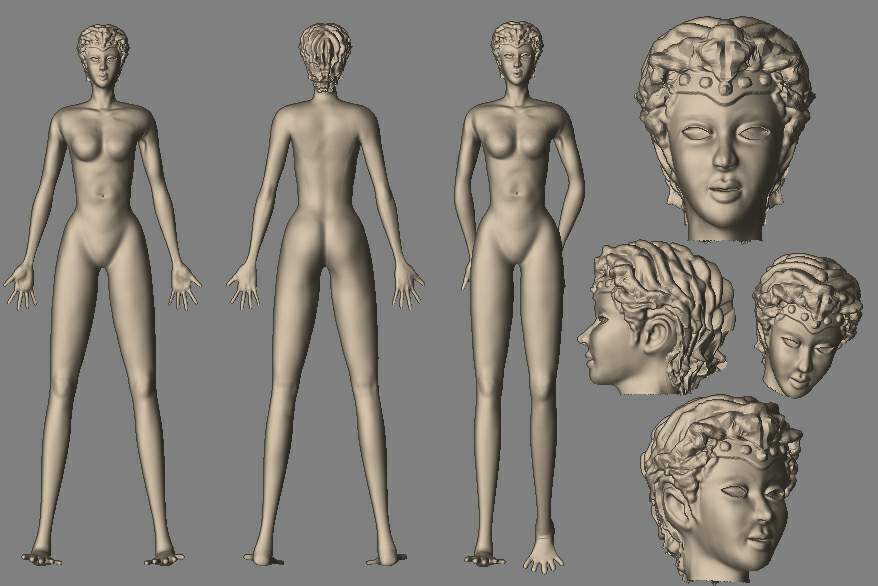

Polys: 26112
Femal face, origin from male face. Wish you like it.

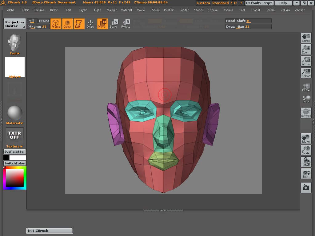

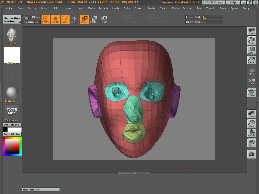

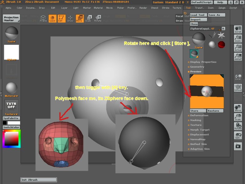

Does this happen every time, or is it just a freak occurrence from the way you put this particular base head together?
I tried and finally repeat the process.
After Zspher Mode is made. I rotate the model in [Tools] / [Prieview], then click [Store].
Now when I toggle back to Adaptive preview. The Coordinate system changed.
Why?? Can’t do rotate and store in this period?
Dan
So this one turned out O.K. then right? Lets see a screen shot. Visuals are always a bonus.
Here is the Screen Shot. Any idea?
The clipping plane is affecting the geometry. The nearer to the plane you turn the model the more it will distort. Try turning it right round in a few stages, storing each stage. I managed to get the geometry to explode this way. Also, if you change the orientation in mesh preview mode it doesn’t affect the underlying spheres.
But surely you don’t need to use it while working with ZSpheres?
Edit: I’ve just done a few more tests and half the time nothing distorted. No idea why. The one consistent thing is that if you change the orientation while in preview mesh mode the underlying Zspheres stay put.
Further Edit: I think perhaps it’s to do with changing the orientation and then increasing the Density.
Yeah, I tried again. I did rotate Zsphere in cliping plane while canvas is in preview mesh mode.
Why this make coordinate system different. Any reason that we can’t do in this way?
