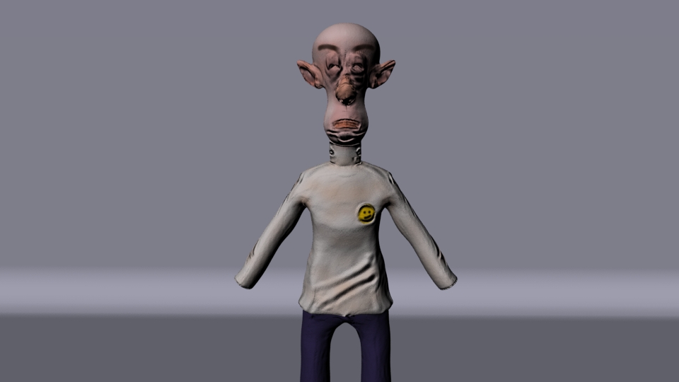

i make diffuse and normal maps with zbrush and that not work for me I need help what is wrong
Thanks
It looks like you need to invert your green channel in your normal map

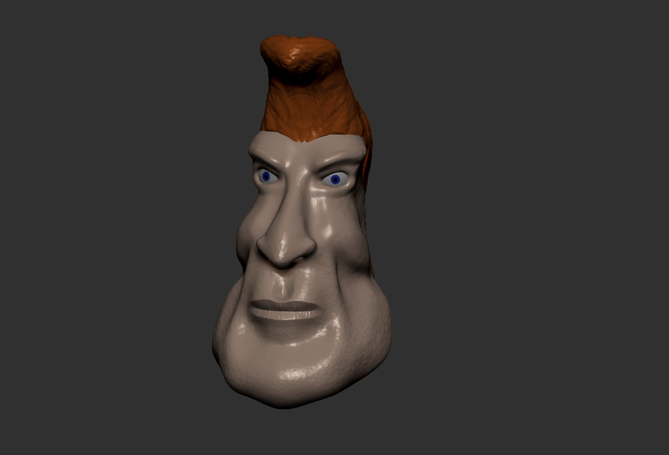

Hello
I am really sorry for this model I just want to learn Zbrush it is my first Model please forgive me I have problem make details from face but i do my best
