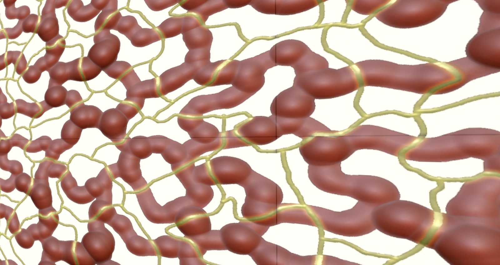

No mater what I do I cant get a small artifact to go away, its a thin
gray line that shows up on the edges of the canvas no mater what I
do, here is an example of one such image wrapped onto another object:

ok I think I know what it is, but I cant get rid of it.
It looks like its the the “document border”.
I can change its color but so far it wont go away.
If I remember correctly you have to make your canvas 1 pixel bigger in X and Y then crop the extra pixel off.
Interesting… and sort of working… but its also very tricky as I haven’t got photoshop…
However while it did get rid of the line, I still have a substantial “ripple” I guess you could call it making the texture less than seamless… its very odd as it looks perfect in Zbrush to the point where I have no idea where thee actual edge is, if I could keep it that way I would be thrilled!

As to the edge, I know that bit and I dont, I am very careful about that, in fact I have tested it as hard as I can and still get that eevviill creeping sneaky bad line…
I conducted a very simple test:
  1. Open Zbrush.
  2. Fill with flat color (in layer pallet as per Auricks instructions).
  3. Move canvas using ~ key.
  4. Export image.
I still got the line with NO drawing at all. (the unwanted line in this case was black or dark gray)
In a second tst I did roughly the same thing only instead of making a completely new document I hit Control N and replaced an existing drawing, this one resulted in the same line only this time it was made of two rows of pixel (or pixols) at the top of the image. Very odd.

@ Marcus:
My initial test (done VERY sloppy and quick) came out nearly perfect, there is a very very hard to find line but I think that is a rendering issue more than anything…
Your plugin works EXCEEDINGLY well! Thank you! Brilliant work!

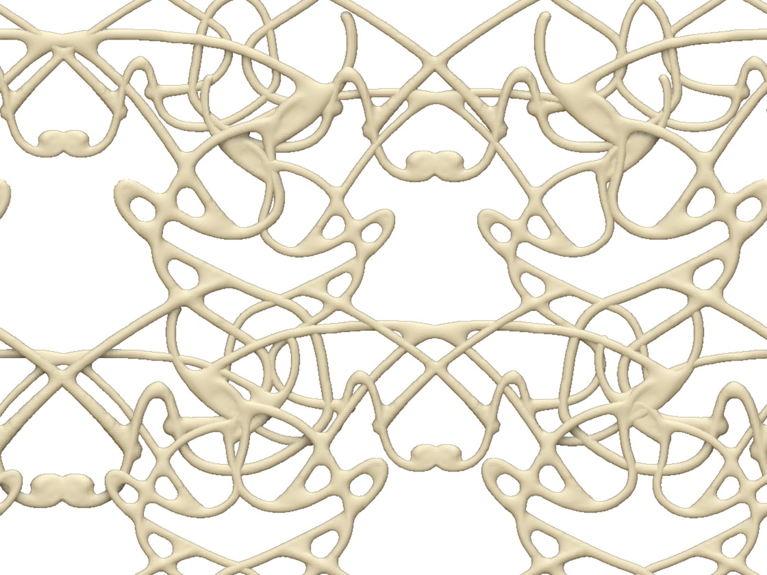

It works so close to flawlessly its amazing!
Here is a simple (and as far as I can see perfect) example of your plugin:

Just out of curiosity, how did you do this?
More after more messing about and testing and other chaos, I need to try using this on a tentacle monster in OsGrid and see if how it looks!
GRIN!!!
I’m glad you like it. :slight_smile: The lines/artefacts are mostly caused by shadows at the edge of the image. The plugin simply automates a method that would be tedious to do by hand - it tiles and enlarges the image before cropping back to the original size so that there is no ‘edge’ to cause shadow artefacts.
