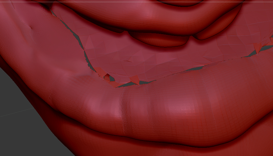

How do I connect rough edges to close wholes? I have been trying zmodeler but keep getting "non symmetrical operation canceled. Once again seems like this should be easie?. I am an hour now watching videos that done help from pixelogic. Helo much appreciated!!Ugghhrough edge.tiff (514.9 KB)

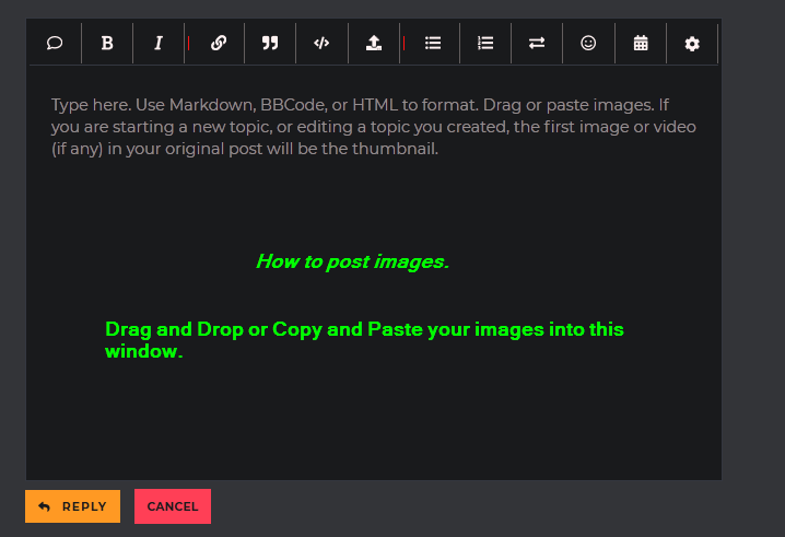

Please upload images directly to the thread in web friendly format like Jpeg or png. You can drag and drop them directly into the text window.

Ok Here is the image again.I have been trying to use zmodeler but as I stated t=i keep getting symmetry error. I will look fro trim brush tutorial.Trying to avoid dynamesh and close holes as it keeps damaging different areas of the model.Thank you rough%20edge|898x513
Hi @lee_ballard
2020-03-16%2016_36_22%20-%20ZBrushCentral
Not sure if this is a question. I dragged the image to the dialog box.I can film it if you likerough%20edge
I’m not sure what has happened here. It looks like you partially subdivided or re-meshed only a portion of the mesh, and a portion of your mesh is un-welded.
If both meshes are part of the same subtool, you could just send it all through Dynamesh and see if that can fuse everything back together, but there will likely be some cleanup work.
Thank you. I cut a hole in a mesh and things went nutso.When I dynamesh it is destroying the model.
So I keep dynameshing and it is closing holes I dont want it to close and ignores these jaged holes.
