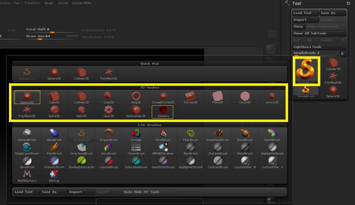

One example will maybe help you to figure what’ s going on and why you can’ t do what you want at start:
First when you launch zBrush, you have a blank canvas, and in your right you have ‘side menu’. Its name ‘Tool’ and you can clearly see a big yellow S with "Simple brush’ writtent below.
Clic on this S, a “menu” will popup and then for instance, choose to clic on the sphere (or what you want in the 3d part of the menu)
- Now, just clic and drag on the canvas to create your 3d object (sphere?)
- after that, clic on T (make it editable),
now you can manipulate it in a 3d ‘world’, clic on blank canvas to rotate it, etc…
-But, at this moment it is a primitive. Meaning parametric 3d object, that we can parameter in the right side menu named Tool, and scroll down you will find “initialize” ‘menu’
The presence of this “initialize” menu means that this is primitive. - If you want to make it ‘fully’ editable, just scroll on top of this same Tool menu, and clic on “Make Polymesh 3D”
Now you have a full 3d editable object to play with in zbrush, with all brush, alpha, etc…
