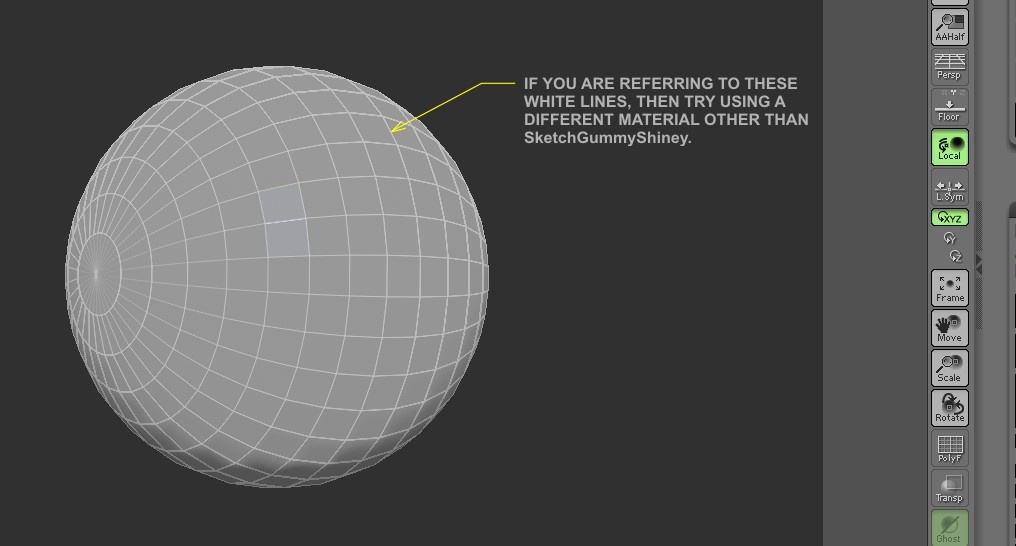

Can you identify the cause of these quadrilaters appearing on the surface after a Unified Mesh make? I have made a unified mesh without them, but 90 percent of the time they appear.
What do you mean by quadrilaters? As far as I know, a “quadrilateral” is a four sided polygon. Every mesh created in ZBrush consists of four sided polygons (exluding poles). I don’t see any indication in the images you supplied of what you mean by “These quadrilaters almost always appear when i make a unified mesh.”

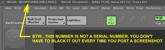

Also, please do not post your images somewhere where they have to be downloaded before they can be viewed. Please post them here. You are allowed up to a 500kb “jpeg” image. It’s easy, just click the ‘Upload Image or File’ button when you edit an existing post or create a new post.
