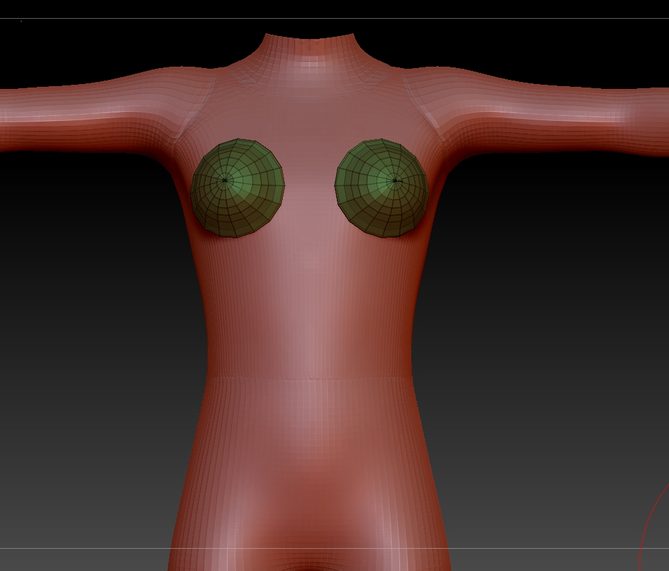

Was playing around today with these ideas. Got my own so wanted to ask if there is a way to make all this work.
Figured out that if I load in a Circle and reposition it over the bodysuit and then mirror it (which I found to be a bit of a task. Even after attempting to Convert to a Polymesh 3D it still acted kinda weird for me). Finally got that accomplished and then saved out the two as a new obj file to use later for perhaps another project. but wondering …
Is there a way to take the bodysuit tool and this new set of circles and tell ZBrush to merge them together and clean up all the under mess that will be created in doing this while retaining the concentric circle layout??

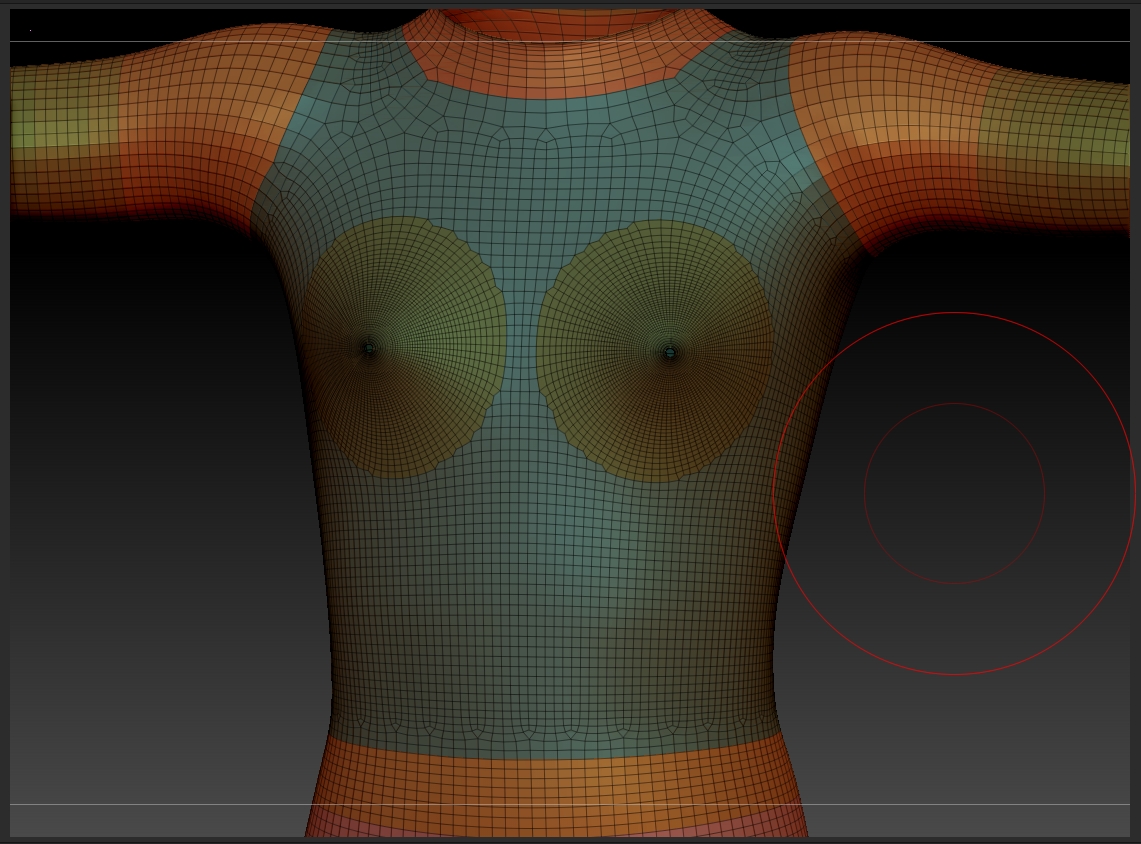

Hi mawag01, well as it turns out your way really was the best way. I really didn’t want this to be as tightly wound as it turned out but it’s allot better than all my other experiments. Loops are really useful for this sort of work but I wish there was a way to tell the “Relax” feature NOT to keep showing the rest of the suit. More unneeded clicks to keep hiding it while I was adding more loops and relaxing. Too bad there was not a way to tell the loops to space them further apart or create a “Wide Loop”. Would have saved me some time. I then just used the Move Topological brush and the Smoothing brush to get the hole in the center as close to closed as I can get it. I’ll fill that later. Then used the Relax by Feature to straighten all of it out. Even used the Flatten Brush to get the wabbliness in the center more evened out.
