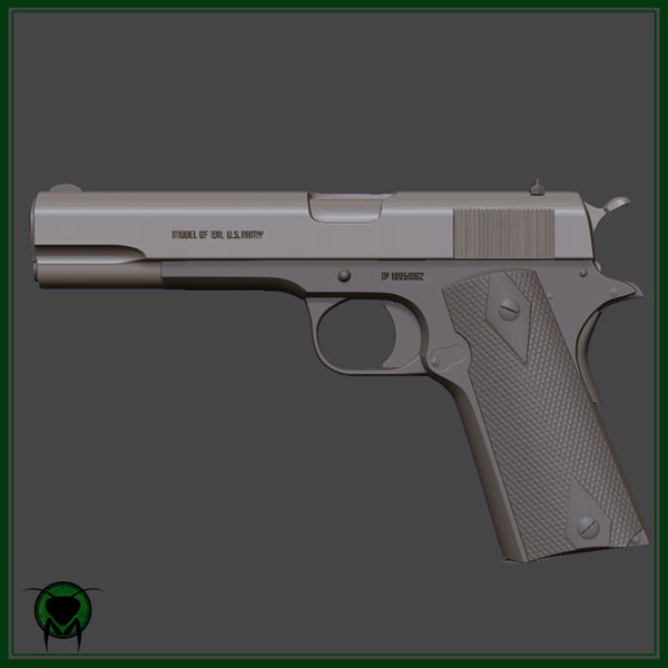

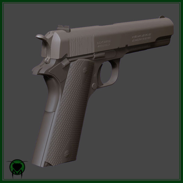

Looking at Sebcesoir Stuff, and his mechanical models, I tried to understand how he did it. I didn't know if I find his workflow but I came with something who fit with me. I tried to reproduce as close as possible a colt 1911 A1. I don't especially love guns, it was just an exercise. I got many subtool, and almost 12.5 millions polygons. So here it is. [![pistolet01_resize.jpg|600x600](upload://oyITh9iGOvBTJy2bvq5qP05Xvol.jpeg)]![pistolet04_resize.jpg|600x600](upload://dwaD6MFbo4YRl39Pd5hWPsmuNLt.jpeg) And here is a turnaround. [Turnaround](http://mantis.folio.free.fr/movie/gun_zbrush.mov)
Very cool. Looks like the gun to me (but I’m not much of an expert).

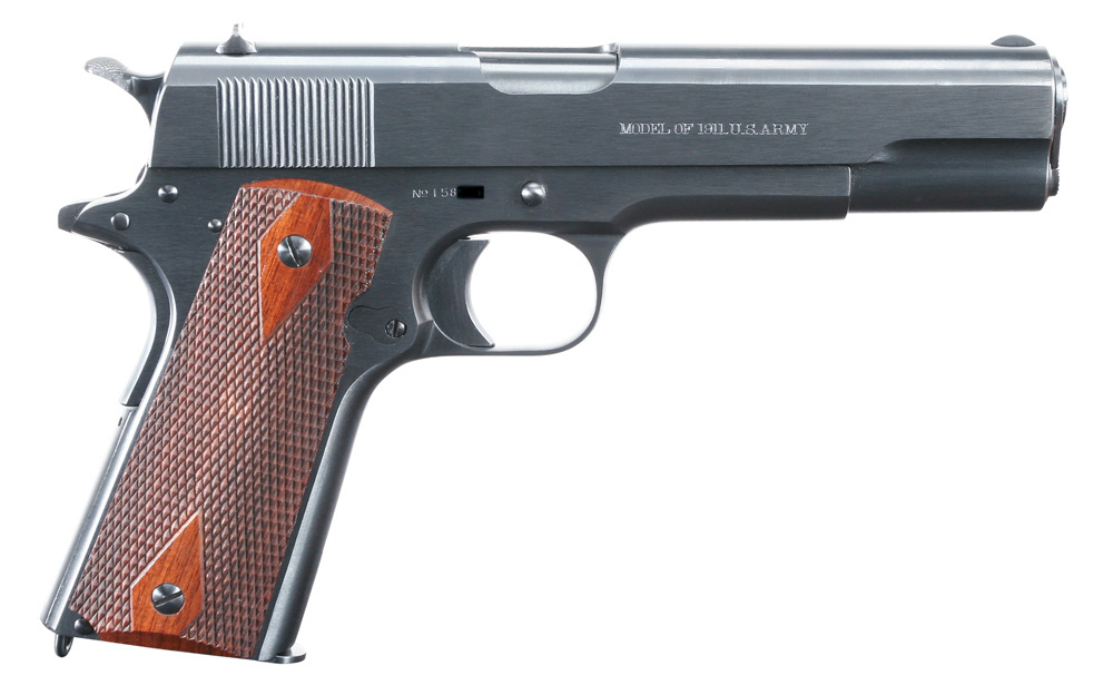

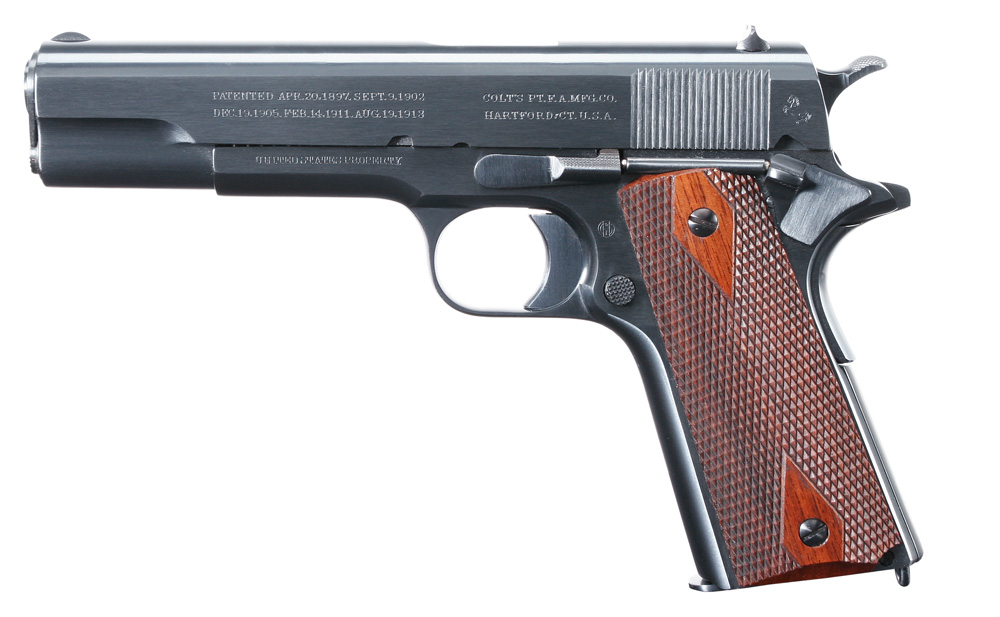

You can see the original gun here
[attach=63656]1858lemailmc4.jpg[/attach]
[attach=63657]1858remailmm0.jpg[/attach]
And for my technique, I used some primary shape that I made in silo to stamp it in Zbrush.
I create the negative shape to dig in the model.
It’s fairly simple, I create those shape for the groove on the rear of the gun.
And for the wood on the handle I created a primary shape, and cut it in PM with primitive.
The cutting on the bottom left (or right depending on the side) corner are made with a Sphere with Zsub activated, with PM, and that’s the same thing for the long cutting on the bottom of this shape, you can see that its like a big sphere has cut this piece of wood, so I did it with PM.
Very good likeness. My only crit would be that area that the shell gets ejected from the slide needs to be undercut just a bit. Right now it looks like the barrel and the slide are one piece. An easy fix for an outstanding model. Would love to see a wireframe and then how you texture it.
