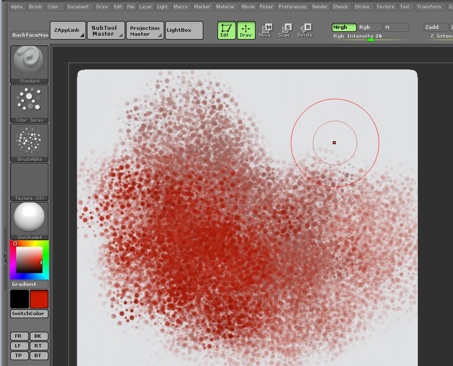

I’m having a weird little quirk with color spray. I was doing fine with a brush for skin tones and I was able to get the dots really small while covering a large area. Now whenever I try to get it to cover a large area while remaining small it doesn’t work. Is it based off of the scale of the object, the size of the document and/or the size of the draw size?
Basically I want to cover a large area with a large brush but have the dots that it sprays really small.
Use an alpha with the Color Spray stroke. Something like Alpha 23 in your Alphas palette.
