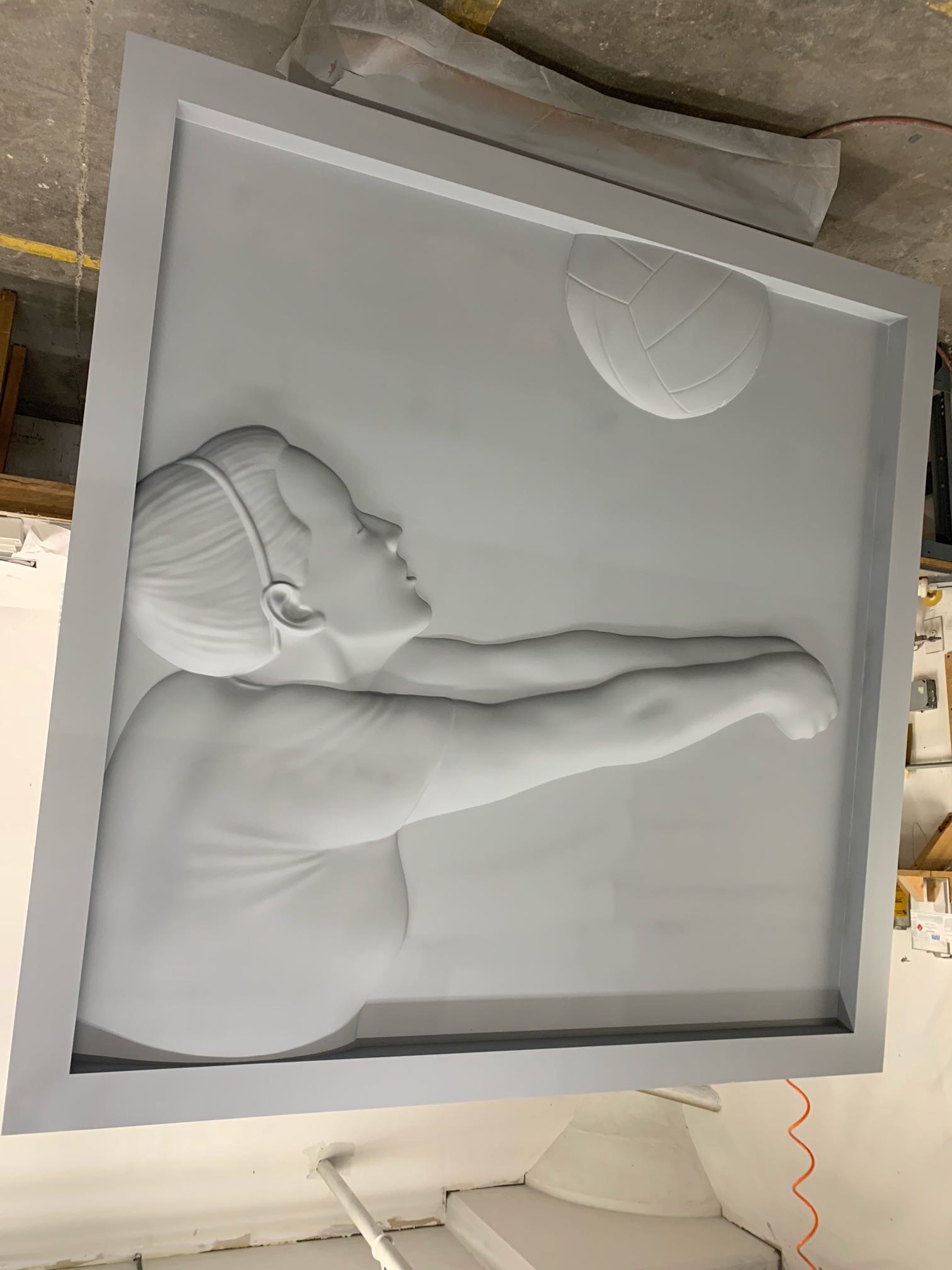

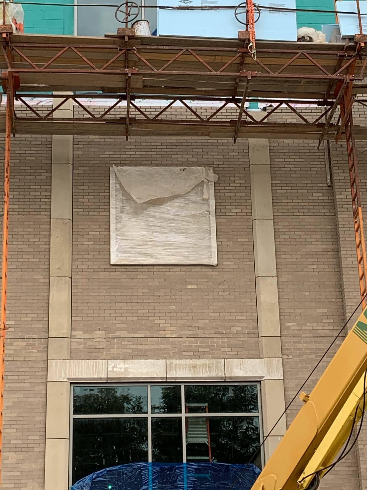

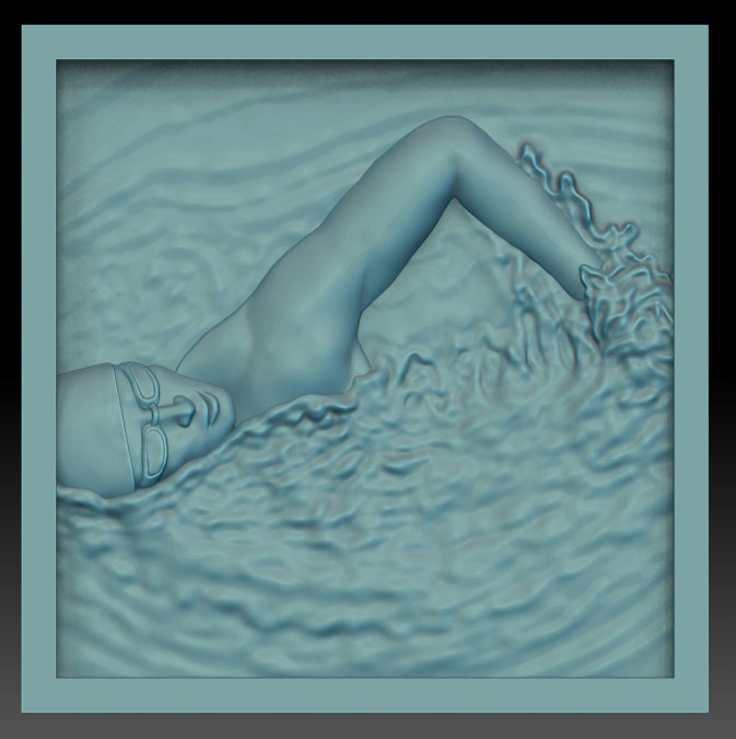

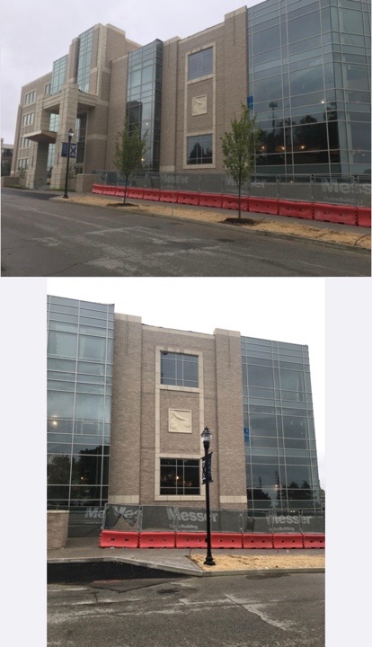

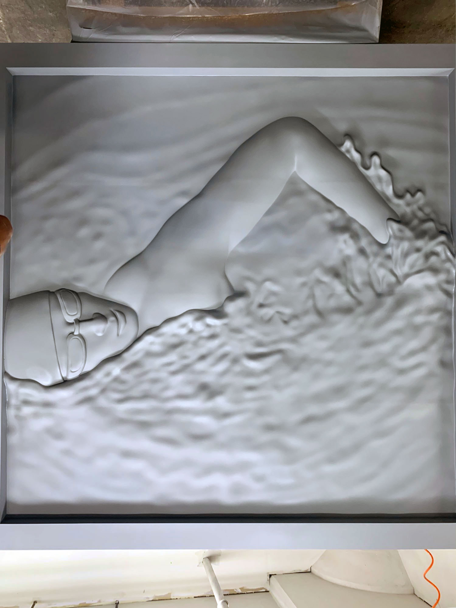

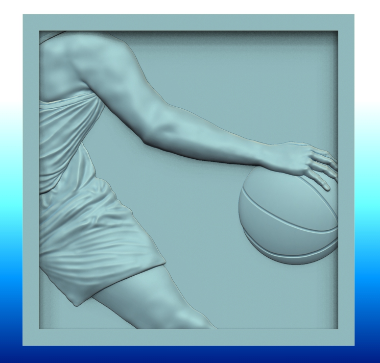

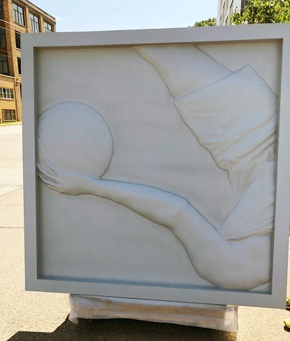

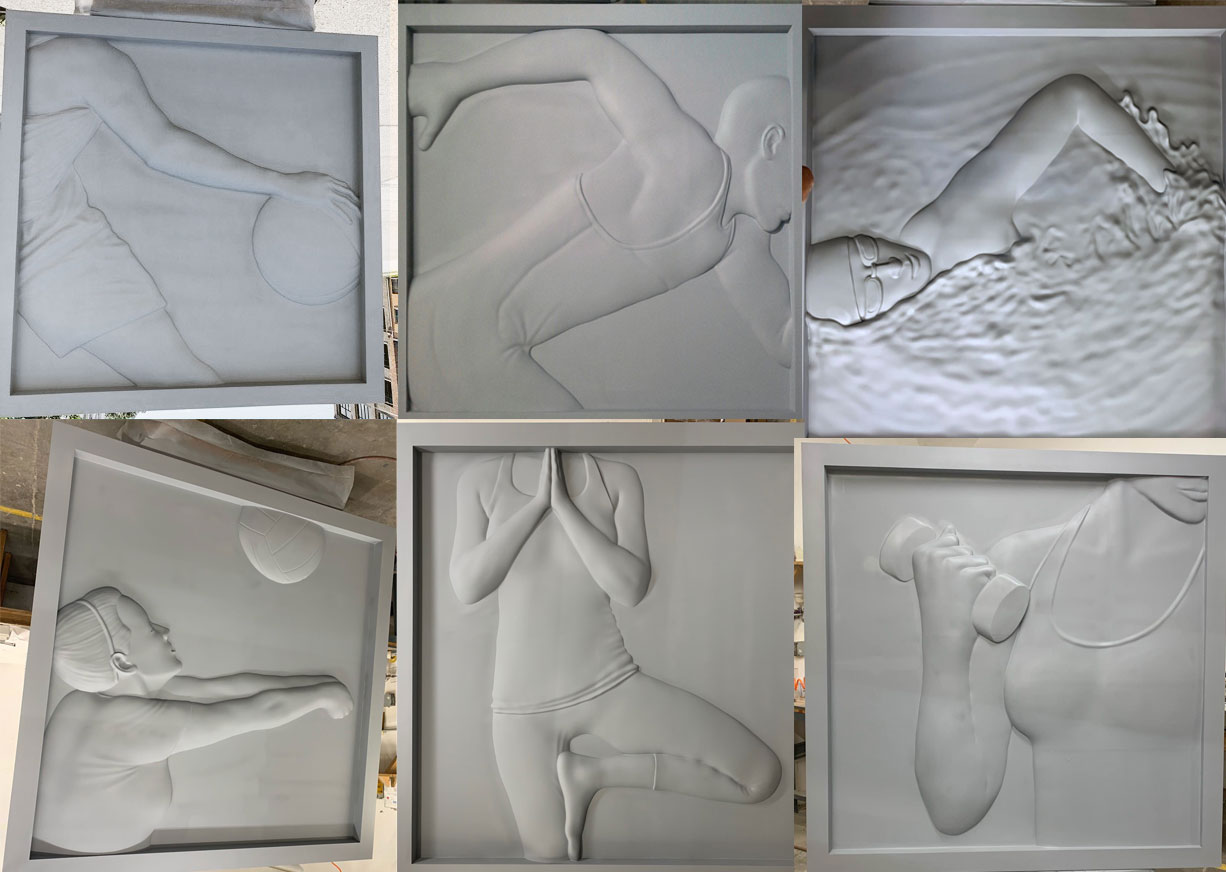

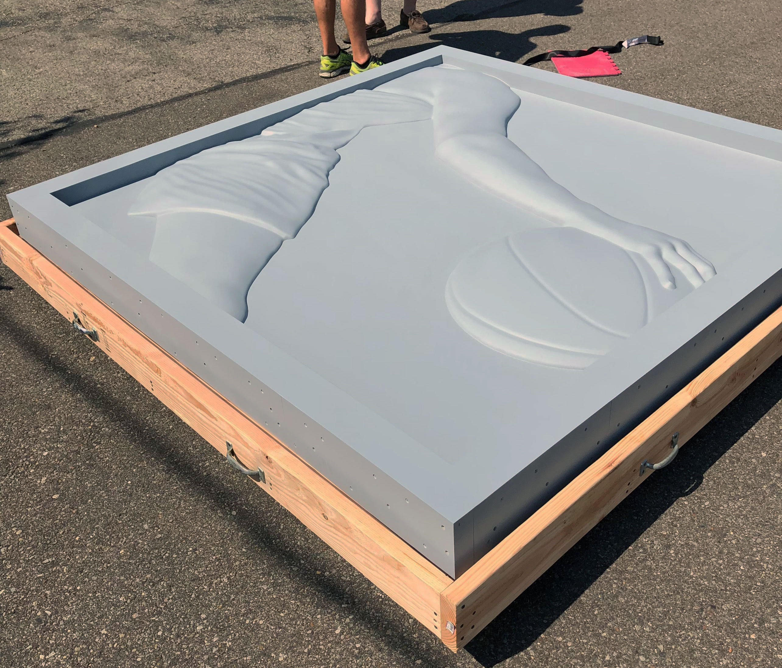

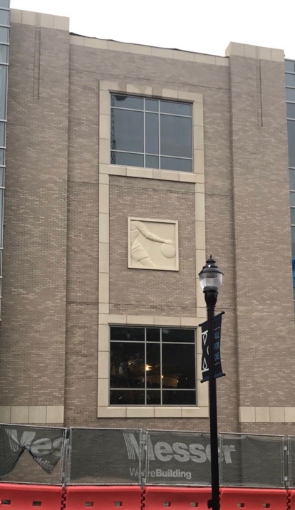

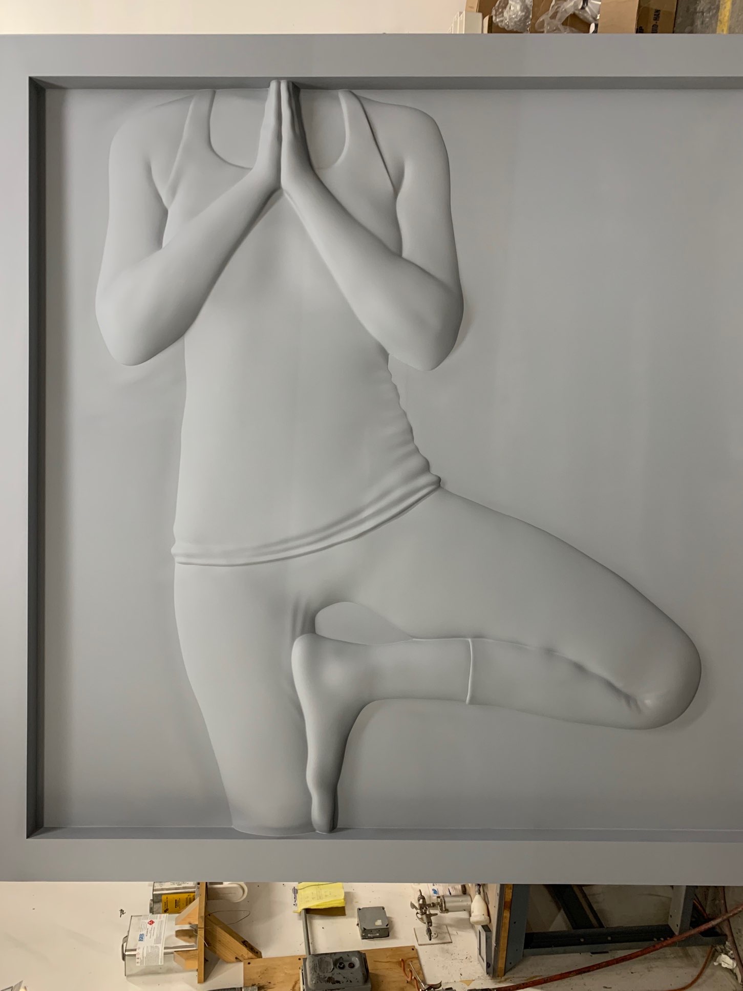

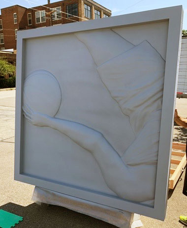

One of the projects that I’ve completed over the past few months is actually something that’s a first for me. Digitally sculpting architectural pieces for pre-cast concrete molds. This is one of 6 pieces that I digitally sculpted, each of different types of athletic activities, that will go into the outside walls of a college. The pieces are each 6 by 6 feet tall and about 5 inches deep. Basically I digitally sculpt them(ZBrush), then the piece is CNC milled out of a rubber type material, then a mold is created from the milled piece, and finally a concrete piece is made from it. This is a picture of the basketball player after it was CNC milled. (sorry some of the pictures are of the piece upside down, it didn’t look right when I flipped the image so I just left it lol)
