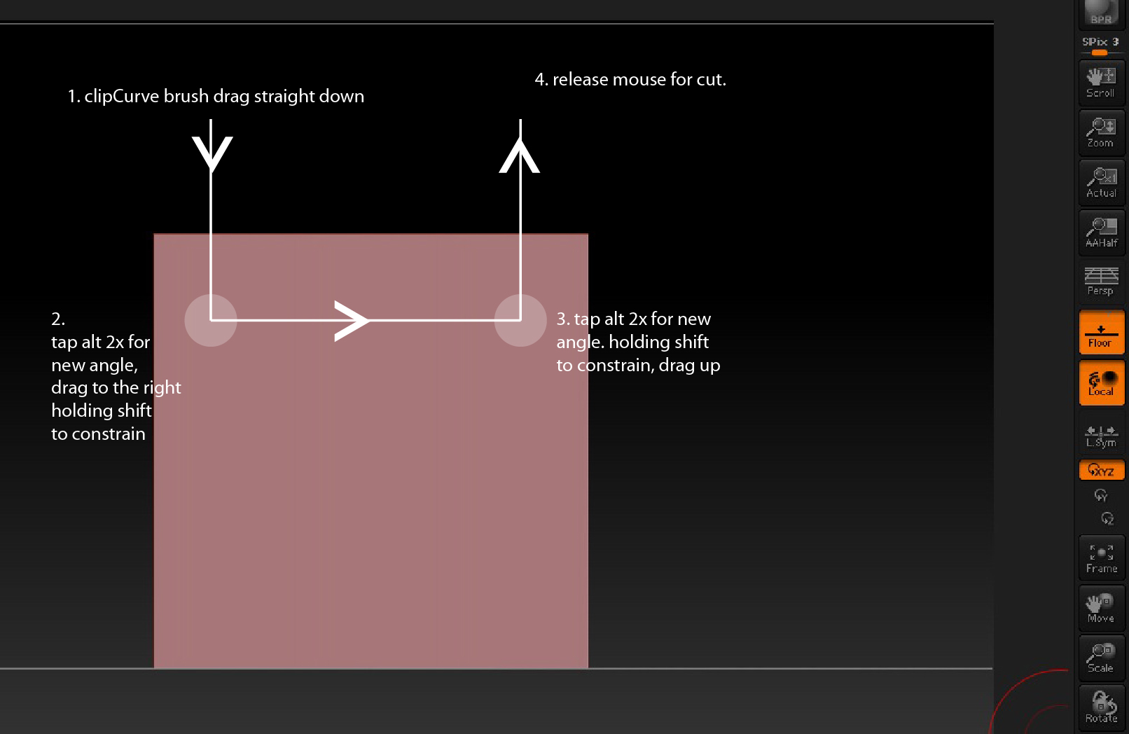

Is there some way to get the clipCurve brush to snap to a 90º angle? Like…draw a straight line down, hit alt 2x to create an angle, then draw a straight line across? It keeps snapping to these 5º increments.

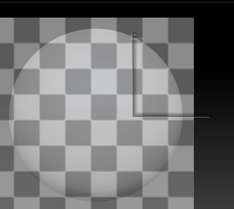

Thanks for the reply marcus, you’re such a helpful member. While your suggestions are really good ones (especially turning off perspective), the clipCurve still doesn’t quite handle the way I thought it would in this aspect, unless I’m missing something. I’m attaching a screen shot of what I’m talking about. No worries though, it looks as if the workaround will just be to use Shadowbox.

You’re right about the sloping. No matter how careful I line it up, it always happens. Good thing Shadowbox is there, even though it slows the trimming process a little.
