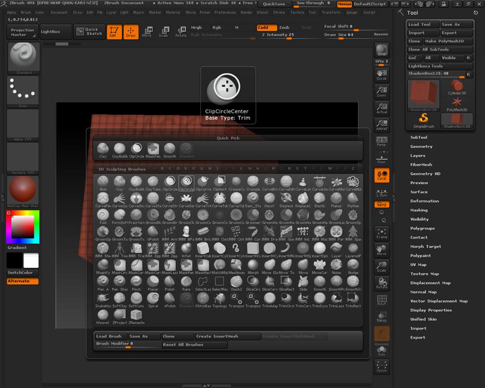

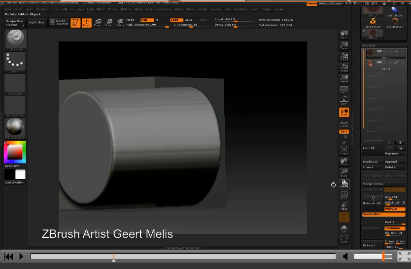

In the initial video that you guys are seeing that it uses the center circle clip tool, I could use it too but unfortunately it does not create a mask but deforms the shadowbox:
Frist I create a shadowbox and select the tool:
And then did the given circle inside the shadowbox using control + shift + left mouse button: And the results like this: That is, it deformed the shadowbox while was to have created a mask with the circle, making her this way (as shown in the video), How the correct way to do that?
Shadowbox uses Mask brushes, not Clip brushes. Hold down Ctrl then click on the Brush icon to select a Mask brush. Clip brushes do not create masks.
In the video he’s actually using the MaskCircle brush not the clipping. Like Zber mentioned Shadowbox only uses masking not clipping. He uses the clip brushes to touch up his model after he’s done with the Shadowbox.
