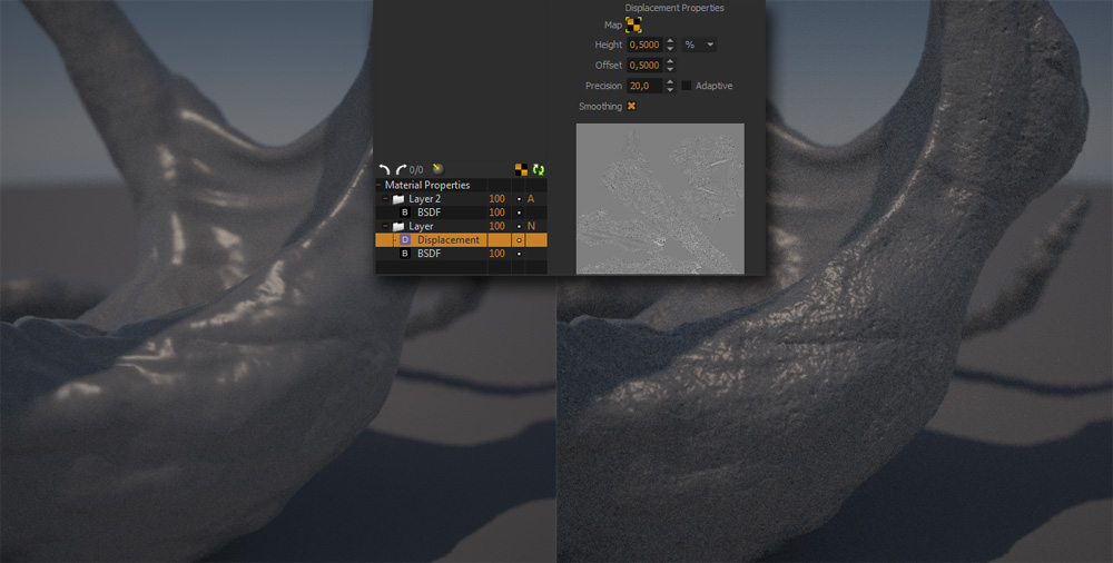

ClawSnake - Rendered with MaxwellRender2.1
Thanks! Yeah, I’m pretty satisified with the SSS result :smiley:
I finally bought a new 6-core computer, and that power is needed when using sloooow materials like SSS! :wink:
hey nice work!! I was wondering how did you set up your displacement map in Maxwell, did you use a 16bit or 32bit displacement map? I’m trying to display a 32bit map and the problem I run into now is that I need .74% for my height and 0.1671 for my offset but I cannot enter more than one number after the decimal, how did you get around that? I’m using Maxwell render Studio V2.01 64bit, so maybe that has been fixed in Maxwell studio V2.1 could you let me know please.

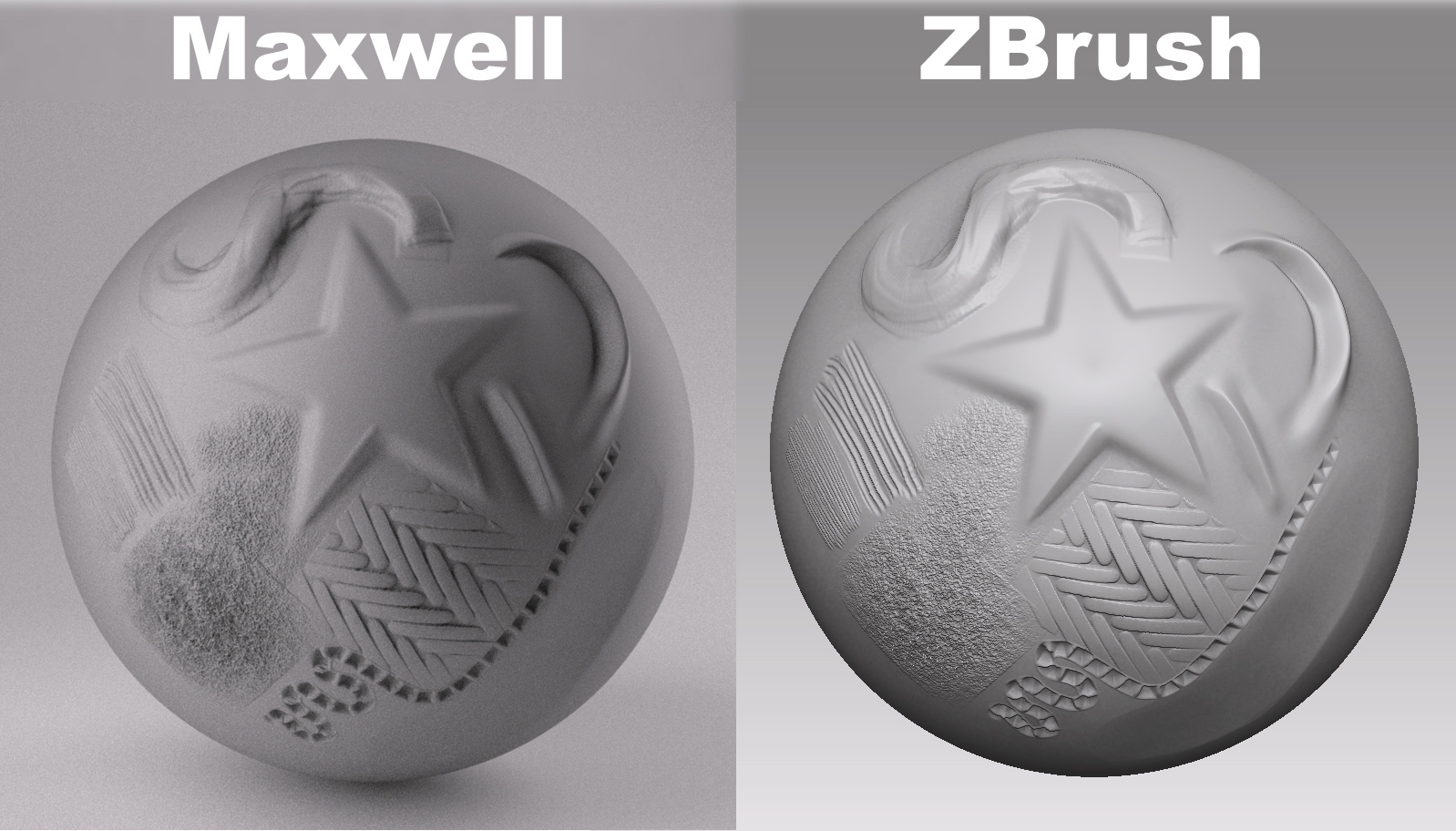

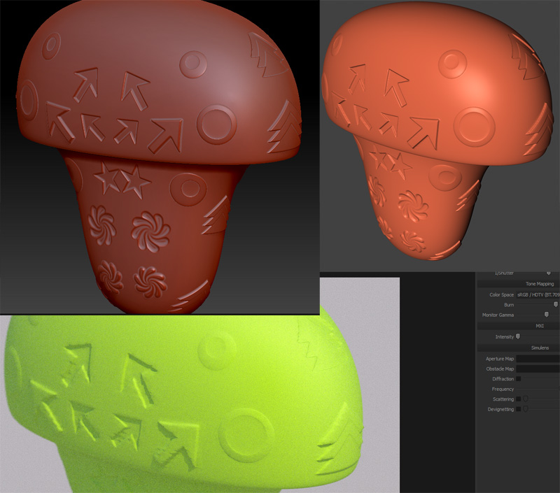

Great render you have there and I love Maxwell, but I’ve having problems creating a good displacement map. It’s almost there, but not fully. And I don’t mean to hijack your thread, it just seems like you know what you’re doing.
I’m using the route of ZBrush > GoZ > C4D > Maxwell
I’ve attached an image (C4D top right, Maxwell bottom) so you can see the test I carried out. I have used a lot of straight lines as those are what I am having trouble with.
Cinema 4D renders it ok after the GoZ step, but then when I send it to Maxwell I have issues (notice the green arrows)
Things I’ve checked
Scale - the model is 4 inches
Dispmap has smooth UV on (selecting Flip V makes no difference)
I really am ripping my hair out with this.

@SNorth:
Hi, some things to check:
How does the mesh of the object look? (the object that is in Maxwell)
If the polygons in the problem-area is larger than the places where it looks ok you might need to increase the “precision” value in Maxwell displacement (shown in my previous screenshot)
Also test the smoothing option in Maxwell displacement.
Uncheck the option Adaptive in Maxwell dicplacement.... I never used that so I don't know how good it is. What resolution do you have on your displacement map. You could try to generate a higher reolution map from ZBrush (do so by accessing Tool - UVmap, increase resolution before generating the displacement map)
If none of the above helps:
You could try the route ZBrush -> Maxwell Studio, just to verify that the problem isn’t in the GoZ+C4D->Maxwell area…
Hi LMM,
Thanks for the reply. The mesh is fairly even all over, but I have upped the precision to 20 with no joy.
The UV Map is 2048 and I generated it via UVMaster (Unwrap).
I’ve tried a lot of different things, but no joy. It’s so near perfection, but those little quirks are annoying.
I’ll try straight to Maxwell and see if that’s any better.
Thanks again
Hi,
Ah, missed your comment that the top right (orange) part of your image showed C4D results. And that looks ok. ( don’t think the coffee had reached my brain :wink: )
Hm, makes me think more and more that something goes wrong in the transfer between C4D -> Maxwell.
(maybe messing up map size or lowering bit depth to just 8?)
Are you using Maxwell2.1 ? And are you using the latest C4D plugin they posted 28July2010 ?
Thanks again for the reply.

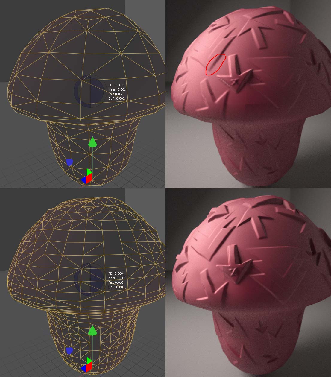

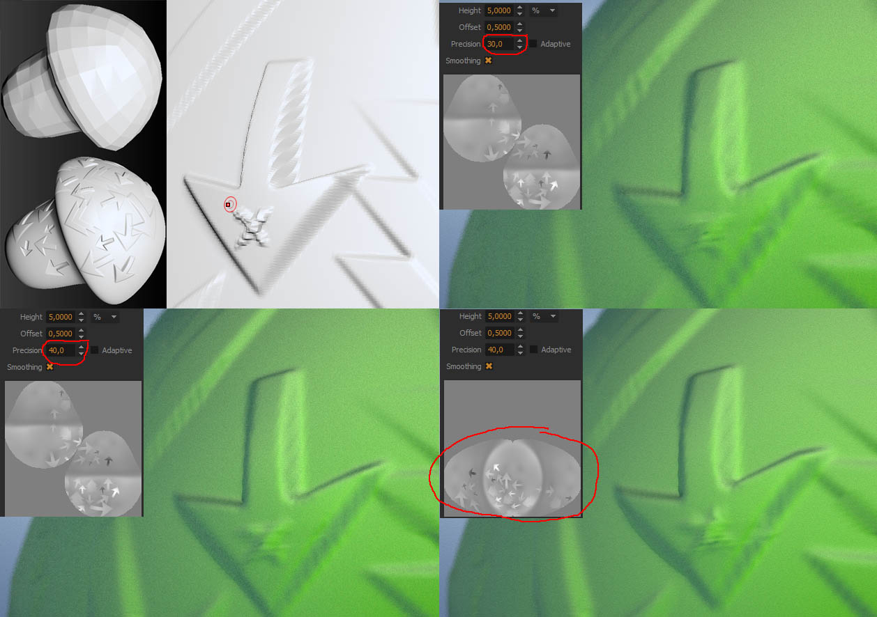

Ok I’ve just ruled that out. I exported the obj and created a Disp map (2048) with Smooth UV and Flip V on and imported it all directly into Maxwell and it’s exactly the same.
Maybe it’s something to do with Maxwell and sharp edges?
Had to test it also :smiley:
  1. Top left
    Zbrush screenshots that shows the
    lowest subdiv ( 288polys ) that I exported to Maxwell.
    And the Highest subdiv ( 1.2 Million polys)
    and a closeup of the highest that shows how the polys stretch at the sides of the arrow.
  2. Top right Maxwell screenshot. (blurriness caused by badly placed camera focus point :o )
    ( In ZB the “mushroom” was Unwrapped in UVmasterm by using Polygroups, basically splitting it in half.)
    Precision 30 wasn’t quite enough for only a 288 poly model.
    Had to use the Smoothing setting, otherwise it looked like I placed the arrows directly on the flatfaced 288 poly model…not nice.
    Think the model needs to have much higher polycount before even thinking about turning off smoothing. ( I always have it on so I’m not sure)
  3. Bottom Left. (blurriness caused by badly placed camera focus point :o )
    same as 2 but with precision 40.
    Much more like the ZBrush model… even the streched polygons seem to be visible.
    ( I also did some test in ZBrush, testing displacement export with Adaptive on and DPSubPix=2… and the result…hm, maybe slightly better. Also tested to export map in 4096x4096, but that didn’t give me any visible difference in this case, EXCEPT the tiny cross: in 2048x2048, the cross is just in a 15x15 pixel area, not enough for the details.)
  4. Bottom Right. Here I tested to just press Unwrap in UVmaster without polygroups. (so no Island splitting)
    It stretches the UV and the arrow gets “bendy”… not good.
    A previous attempt made an even stretchier flatten but I forgot to save that.
Hm, I couldn’t get exactly the same result that you got unless you did as I in case 4 ? What does your displacementmap (uv map) look like?
Regarding C4D and Maxwell result, it might be possible that C4D with Biased render engine can use some tricks to improve displacement that isn’t possible with Unbiased… have no idea :confused:
Still, I think that my results (case 3) was very close to how it looks in ZB…except I messed up the camera focus…and the tiny cross that would probably need a 8192x8192 disp.map to show up more clearly :wink:
Hm, when altering light and increased DOF I got closer to your problem:
[mushroom2.jpg](javascript:zb_insimg(‘211053’,‘mushroom2.jpg’,1,0))
Upper one is same as previous case 3.
288 poly model with precision 40. 2048x2048 map.
Lower one i increased detail. Added another subdiv level (4.7 million polys) to get the sides of the arrows smoother.
Exported the 1152 polyversion to Maxwell.
Generated a 4096x4096 disp.map with Adaptive and DPSubPix=2.
Better but still some problem areas.
(Maxwell seem to prefer highpoly models like the ones I feed it with, 200k-800k models :wink: )
Might be better with 32bit displacement if someone figures out how to use it :confused:

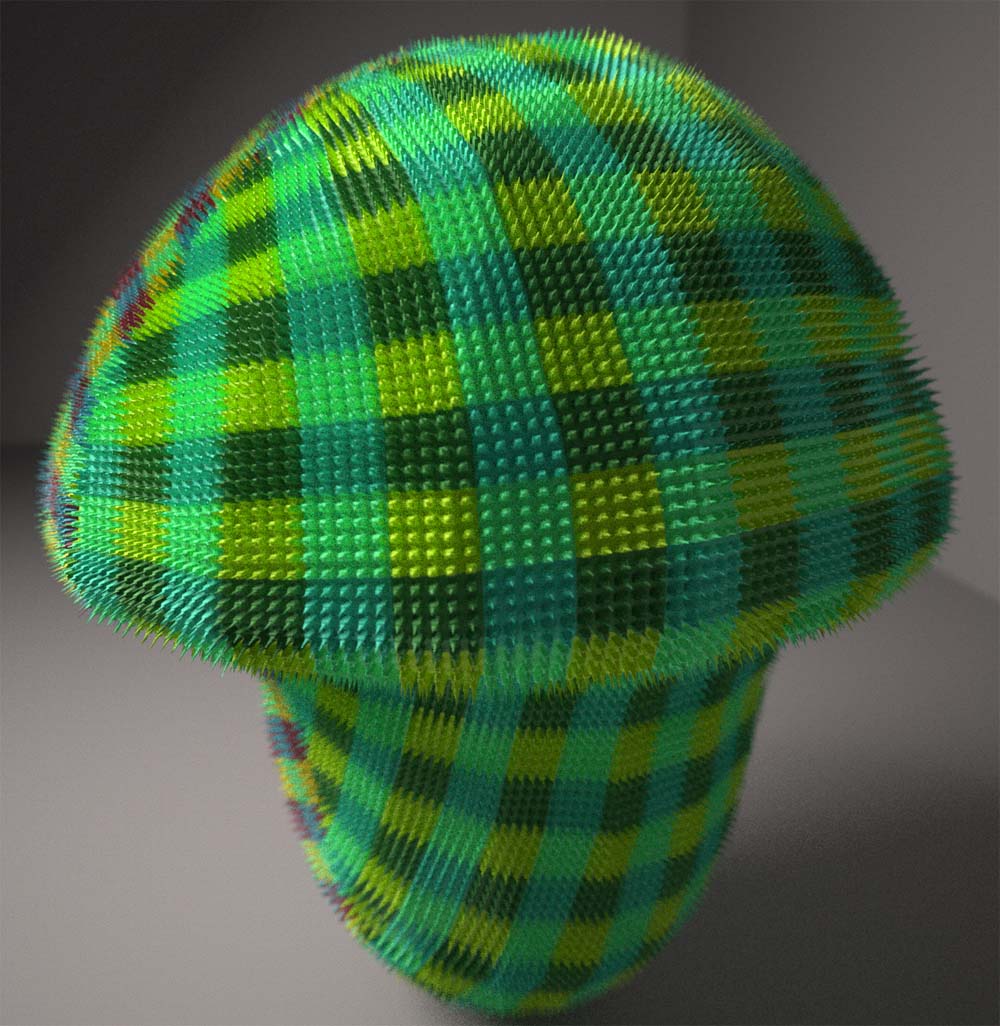

[attach=211090]spikeymushroom.jpg[/attach]

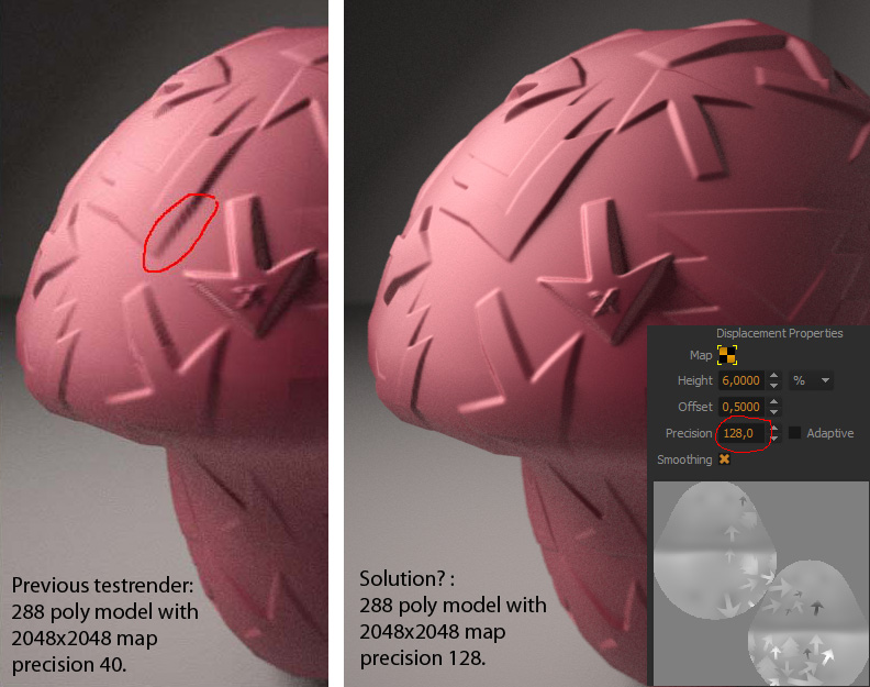

This is the 288 polygon model. Displacement map 4096x4096, and the little towers are 10x10pixel lightgrey squares with a white 4x4 pixel square in the middle.
Here I pushed the precision to 128 and let it render for 30minutes.
( I’ve never gone that high before :smiley: )
That got me thinking and I tried to redo the previous crappy render and just increasing the precision:
[attach=211096]mushroom3.jpg[/attach]
I don’t know why I didn’t test that directly…might be because the Maxwell manual shows precision 32 as a HIGH value…but that was in a VERY simple scene… so, required precision is very dependant on amount of polygons in model and how much detail you want and sharper shapes requires much higher values than what I’m used to, pores and skinstructure. :o
How high precision value have you tested? (with some testing you might find what value you need to multiply your C4D value with to get the same result in Maxwell ?)
Fun side-effect from all this testing is that I now have that colorful spiky mushroom in my Flickr gallery…that one will get my relatives and friends confused :smiley: ( I’m the only CGI-nut, and if I use terms like displacement and subdivision their eyes go blank :wink: )

Yes, 128 is perhaps to high, but it’s a starting point. Now we know that Maxwell can create good results.
In my Mushroom case the solution is somewhere between 40 and 128.
So, I’d say the solution is to give Maxwell something good to work with, by letting ZBrush generate as good disp.map as possible, by generating the dispmap with Adaptive and DPSubPix.
And perhaps also increasing the DispMap size, then more pixels will represent the sharp slope of the arrow sides (or whatever we sculpt…not sure it matters in this case since apparantly the 2048 map had enough info if precision was high enough.)
And then gradually increasing the precision from 40, to reach a value with good result / performance ratio. :smiley:
Then you shouldn’t try the option Adaptive in Maxwell :wink:
I read about it in the manual (yes, the one I rarely use :o) and it mentions that adaptive is resolution dependandt and gives half a pixel accuracy.
( Larger disp.map resolutions means higher precision, a quick test with a 1024x1024 map on single polygon plane seem to give a precision that is way, waaay above 128 :smiley: )
And if I don’t make much sense, it’s because I was up late late night, and the morning coffee doesn’t seem to be strong enough to wake up my brain :wink:

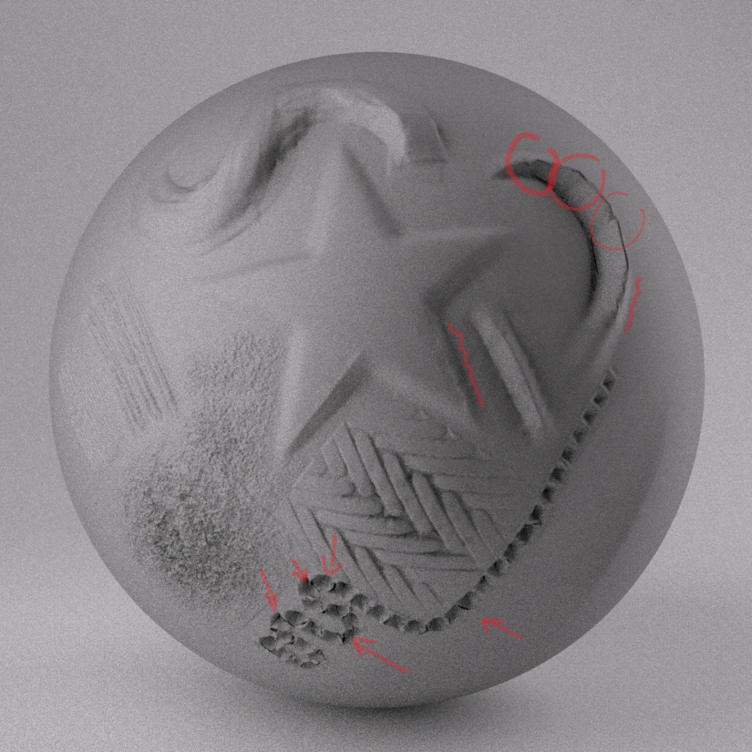

I did some test on my side today, because I really wanted to figure the map things out!
So I used a sphere from Zbrush and used a set of different brushes to make some stroke on it, making sure the UV’s where smoothed as I was stepping up subdiv level, then I generated 16bit and 32bit maps. then imported my basemesh in Maxwell, smoothed the edges using the recal button, after that I applied my 16bit map generated from Zbrush (Smooth UV_FlipV) precision in maxwell set to 20 and displacement setting set to default (2.0 - 0.5) and that’s what I got!!
[attach=211431]Lv1Mrg_16bitMaptTest.jpg[/attach]
regardless the way I was generating my displacement in Zbrush, it still rendered the same glitches there and then even using the basemesh at a higher subdiv , Not so good. I also tried 32Bit without any success, it doesn’t seems to do anything at all, but anyway then I looked at my smoothed geometry in Maxwell and realized it wasn’t uniformly smoothed, I was wondering if it would smooth out better in Maya so I exported my Basemesh to Maya then smoothed it out, and exported back in Maxwell as a MXS file. Opening my brand new MXS, the smoothed geometry of Maya was preserved. and was indeed much better than the way Maxwell smooth edges.
then I apply the same setting than the previous render above and that’s how it came out. the precision was only set to 20 so if you are picky you could set it up a little higher to make sure the edges stay sharp.
[attach=211436]16bitMap_Test.jpg[/attach]
it looks pretty good to me!! no voxelisation that takes for edges, so from now on that how I will render my model in Maxwell using 16bit maps.
Nice! You found a solution for your problem! :smiley:
( I didn’t realize before that your problem was surface brake-up )
The Object smooth recalibration in Maxwell, yeah, that’s why I make sure to export rather high resolution meshes, if the 60degree (or slightly higher) smooth doesn’t make it look smooth with the “Default” material, there is no point in using displacement since that only seem to increase the problem. :confused:
Hm, wonder if your solution works with all softwares that have the Maxwell export plugin? (I’m assuming that’s how you exported mxs from Maya?)
